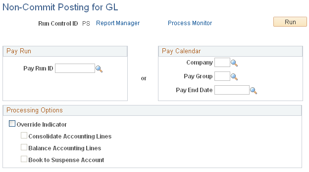

Use the Non-Commit Posting for GL page (HPIP_NA_PST_RUN) to run the PNA Posting for GL process to prepare the accounting lines for posting and post them to EnterpriseOne General Ledger.
Navigation:
This example illustrates the fields and controls on the Non-Commit Posting for GL page.
Enter the pay run ID that you want to process or specify the parameters to process an individual pay calendar.
Field or Control |
Description |
Pay Run ID |
You can select only from pay run IDs for which the GL Interface process has been run and the Posting for E1 GL process has not been run. If you must reprocess a pay run ID, you must first run the GL Reset Run Flag process. The pay run ID cannot contain any GL business units that do not integrate with EnterpriseOne general ledger. |
Override Indicator |
Select to override the balance options set for the target product on the Configure Target System page. The other fields in this group box are available for entry only if Override Indicator is selected. |
Balance Accounting Lines. |
Select this check box if you want the system to calculate whether the debits equal the credits for each general ledger business unit. |
Book to Suspense Account |
This field is available for entry if you select Balance Accounting Lines. Select Book to Suspense Account to post unbalanced amounts to a suspense account when the credits do not equal debits. If selected, you must specify a suspense account number on the Configure GL Business Unit page. |

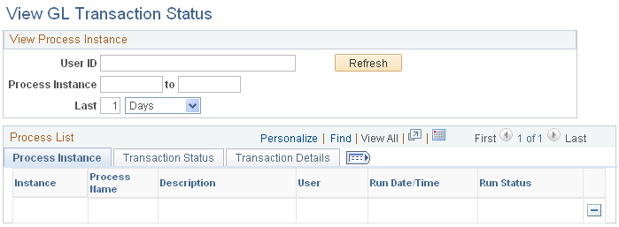

Use the View GL Transaction Status page (HPIP_PRCS_STAT) to view the transaction reply indicating the status of the data load into the EnterpriseOne staging table.
Navigation:
This example illustrates the fields and controls on the View GL Transaction Status.
Field or Control |
Description |
Return Code |
Possible return codes are: 0: Successful load on E1: No further action is required. 1: Account Number Mismatch: The account number of one of the lines of the payroll transaction does not match an account number previously assigned and cross-referenced during the Account initial or incremental load. No insert into the Z1 staging table was attempted. 2: Inserting Error: The insert of the lines of the payroll transaction into the Z1 staging tables failed due to some problem, such as a primary key was omitted. No lines were inserted into the Z1 staging table. |
