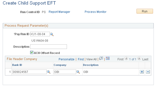

(USA) Use the Create Child Support EFT page (RUNCTL_PAY040) to generate an EFT transmittal file for child support garnishments.
Navigation:
This example illustrates the fields and controls on the Create Child Support EFT page.
Field or Control |
Description |
Pay Run ID |
Select the pay run ID of the payroll run. The process retrieves garnishment payments for the specified pay run ID. |
Description |
Enter any information you would like to appear with the company identification information in the transmittal file header. You may leave this blank. |
ACH Offset Record (automated clearing house offset record) |
Select if you want PAY040 to generate one offset (627) record after all the employees/states have been reported and after the last 722 record is generated. When this check box is deselected, the offset (627) record is not generated and the debit amount on record 8 is zero filled. |
File Header Company |
The Source Bank ID and Company ID entered in this group box is informational only, and is not used in the creation of the EFT file. |
