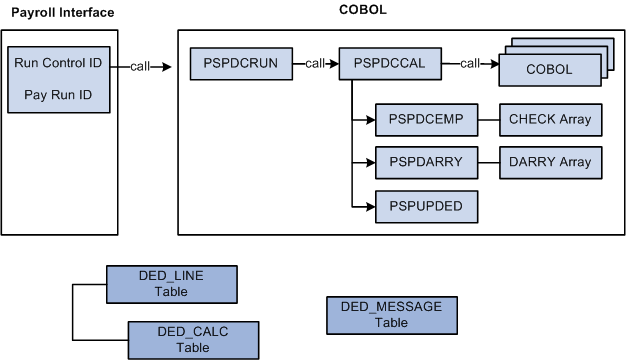

This diagram illustrates the Calculate Deductions process flow:
This diagram illustrates the Calculate Deductions process flow.
Deduction processing occurs in the following way:
To start the Calculate Deductions process, enter a pay run ID and other parameters using the Calculate Deductions (RUNCTL_DED_CALC) component, Calculate Deductions page.
PSPDCRUN reads the pay run ID and calls PSPDCCAL.
PSPDCCAL calls the COBOL routines required to process deductions.
PSPDCCAL calls PSPDCEMP, which in turn creates the CHECK array.
PSPDCCAL calls PSPDARRY, which in turn creates the DARRY array.
PSPDCCAL calls PSPUPDED, which populates the DED_LINE and DED_CALC tables.

The PSPDCEMP COBOL routine:
Selects the jobs and benefit programs to be processed by PSPDARRY.
Stores the EMPL_RCD and BEN_RCD that might exist for the EMPLID in the CHECK array.
The PSPDARRY COBOL routine:
Uses the CHECK array to select and calculate the deduction values that should be taken from an employee's check.
Stores the calculated deduction values in the DARRY array.
The PSPUPDED COBOL routine writes the results of the Calculate Deductions process to the DED_LINE and DED_CALC tables.
