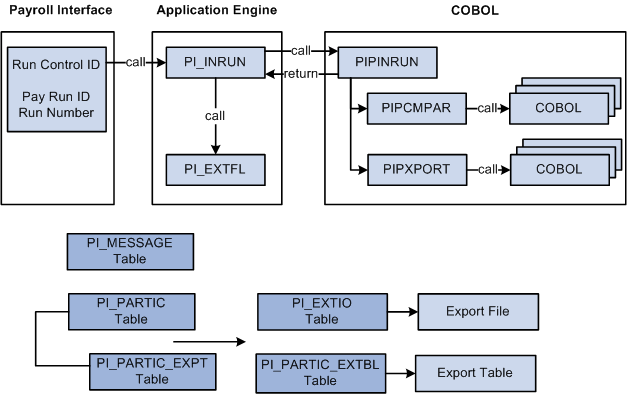

This diagram illustrates the Export process flow:
This diagram illustrates the Export process flow.
Export processing occurs in the following way:
- To start the Export process, use the Import/Export Payroll Data (PI_RUNCTL_PNL) component, Import/Export Payroll Data run control page to enter the pay run ID, payroll interface run number, and other parameters.
- PI_INRUN reads the pay run ID and run number and calls PIPINRUN.
- PIPINRUN calls PIPCMPAR (which in turn calls other subroutines). PIPCMPAR selects, compares, and exports data to tables PI_PARTIC and PI_PARTIC EXPT.
- PIPINRUN calls PIXPORT (which in turn calls other subroutines). PIPXPORT reads table PI_PARTIC_EXPT, transfers the changed data to temporary table PI_EXTIO or PI_PARTIC_EXTBL.
- PIPINRUN returns control to PI_INRUN.
- PI_INRUN calls PI_EXTFL.
- If exporting to a file, PI_EXTFL reads the data in PI_EXTIO and creates the export file. If exporting to a table, PI_EXTFL reads the data in PI_PARTIC_EXTBL and creates the export table.

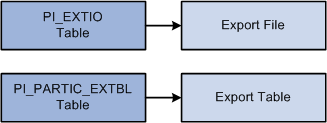

The Export process can write data to either an export file or an export table.
This diagram illustrates exporting data to either a file or table:
This diagram illustrates exporting data to either a file or table.
PI_EXTIO Table
In the PI_EXTIO table, the REC_DATA_PARTIAL field should contain the exact contents of the external file. However, if the record length of the external file exceeds 252 bytes, then the rows in PI_EXTIO are split and the RECDATA_SEQ_NO field is incremented.
PI_PARTIC_EXTBL Table
In the PI_PARTIC_EXTBL table, a row for each changed field is written and the SEQ_NUM field is incremented by 1 unless the field has a group ID assigned to it. For fields with group IDs, the same SEQ_NUM is applied to all fields in the group. For the sequence numbering logic to work properly, you must set up grouped fields correctly. For example, the DED group ID can be used to pair the Deduction Code and Deduction Amount fields. These two fields must adjoin each other on the record; fields without the DED group ID cannot be positioned between them.
