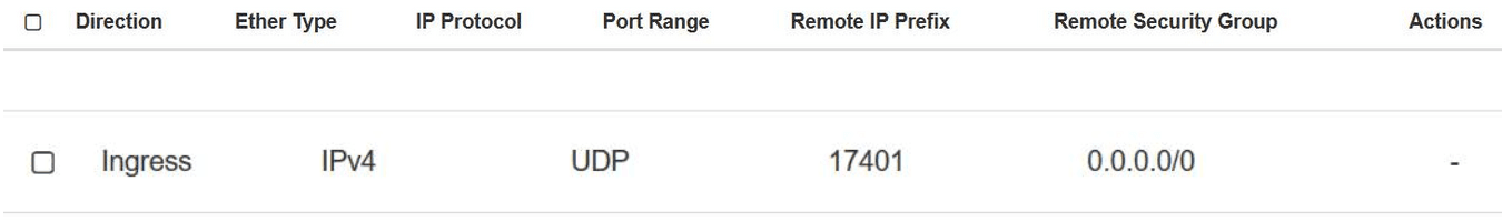

  2. If ping request or response packets are not coming from any server, then add security group rule ingress (response) or egress (request) to that instance.
    The following image shows Ingress response:
    Figure 23-1 Ingress Response
    Ingress Response

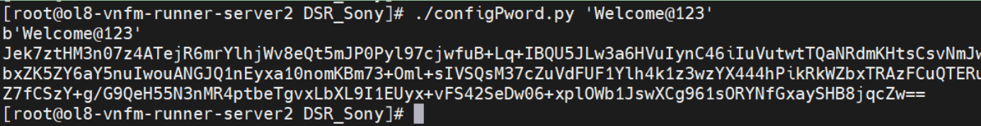

  • The updated password must be encrypted using the utility function which is /configPword.py'passwordToBeEncrypted'.
    Following is an example showing the usage of the script:
    Figure 23-2 Usage of Script
    Usage of Script
