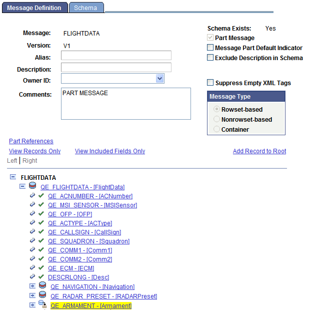

A referenced message part appears highlighted in the tree structure for a message in the Messages – Message Definition page.
This example illustrates the Messages – Message Definition page. In the example the message structure for the FLIGHTDATA message is shown. In the tree structure the message record QE_ARMAMENT is highlighted and is therefore a referenced message part in the FLIGHTDATA message.

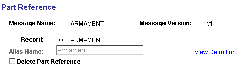

If you click a referenced message part, the Part Reference page (IB_MESSAGE_PARTS2) appears.
This example illustrates the Part Reference page.
You can use the Part Reference page to view general information about the referenced message part as well as view the complete definition for the message part.
You can also use this page to delete the reference to the message part. Deleting a part reference is discussed elsewhere in this section.

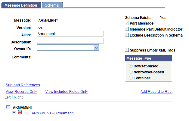

To view the complete message definition for a referenced message part, on the Part References page View Definition link shown in the previous example. When you click the link the definition for the referenced message part appears in the Messages – Message Definition page.
This example illustrates the Messages – Message Definition page. The example shows the message definition for he Armament message part.
You can use the page to view details about the record structure, view the generated message schema, and so on.
