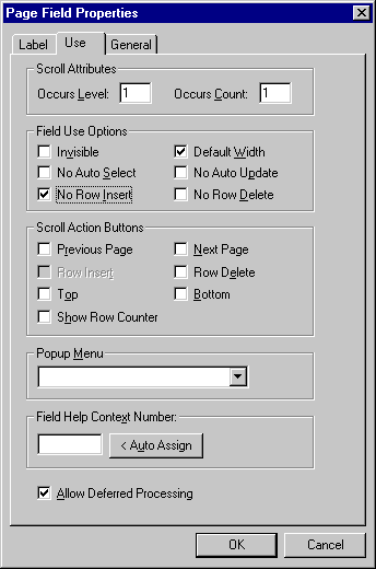

You can prevent a user from inserting rows into a scroll area by selecting the No Row Insert check box in the page field properties, as shown in the following illustration. However, you cannot prevent row insertion conditionally.
This example illustrates the fields and controls on the Setting row insert properties in page field properties for a scroll bar. You can find definitions for the fields and controls later on this page.
