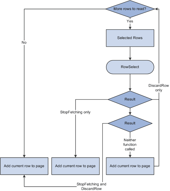

ScrollSelect(levelnum, [Record.level1_recname,  [Record.level2_recname,]] Record.target_recname, Record.sel_recname [, sqlstr [, bindvars]] [, turbo])
where bindvars is an arbitrary-length list of bind variables in the form:
bindvar1 [, bindvar2]. . .
Description
The ScrollSelect function, like the related ScrollSelect functions (ScrollSelectNew, RowScrollSelect, and RowScrollSelectNew) reads data from database tables or views into a scroll area on the active page.
Note: This function remains for backward compatibility only. Use the Select rowset class method instead.
See Select.
Using ScrollSelect
ScrollSelect automatically places child rows in the target scroll area under the correct parent row in the next highest scroll area. If it cannot match a child row to a parent row an error occurs.
ScrollSelect selects rows from a table or view and adds the rows to a scroll area of a page. Let’s call the record definition of the table or view that it selects from the select record; and let’s call the record definition normally referenced by the scroll area (as specified in the page definition) the default scroll record. The select record can be the same as the default scroll record, or it can be a different record definition that has compatible fields with the default scroll record. If you define a select record that differs from the default scroll record, you can restrict the number of fields that are loaded into the component buffers by including only the fields that you actually need.
ScrollSelect accepts a SQL string that can contain a WHERE clause restricting the number of rows selected into the scroll area. The SQL string can also contain an ORDER BY clause to sort the rows.
ScrollSelect functions generate a SQL SELECT statement at runtime, based on the fields in the select record and WHERE clause passed to them in the function call. This gives ScrollSelect functions a significant advantage over SQLExec: they enable you to change the structure of the select record without affecting the PeopleCode, unless the field affected is referred to in the WHERE clause string. This can make the application easier to maintain.
Often, ScrollSelect is used to select rows into a work scroll, which is sometimes hidden using HideScroll. A work scroll is a scroll in which the No Auto Select option is selected on the record definition in Application Designer so that PeopleTools does not automatically populate the scroll at page startup. You can right-click on the scroll or grid then select the scroll’s No Auto Select attribute check box in the record property dialog box.
Depending on how you intend the scroll to be used by the end user, you may also want to select No Auto Update to prevent database updates, and prevent row insertions or deletions in the scroll area by selecting No Row Insert or No Row Update.
To call ScrollSelect at page startup, place the function call in the RowInit event of a key field on the parent scroll record. For example, if you want to fill scroll level one, place the call to ScrollSelect in the RowInit event of a field on level zero.
Parameters
Parameter
Description
levelnum
Specifies the level of the scroll level to be filled (the target scroll area. The value can be 1, 2, or 3.
target_recname
Specifies a record identifying the target scroll, into which the selected rows are read. If target_recname is on scroll level 2, it must be proceeded by a Record. level1_recname. If it is on level 3, you must specify both Record. level1_recname and Record. level2_recname.
Record. sel_recname
Specifies the select record. The selname record must be defined in Application Designer and SQL created (using Build, Project) as a table or a view, unless sel_recname and target_recname are the same. The sel_recname record can contain fewer fields target_recname, although it must contain any key fields to maintain dependencies with other page records. This enables you to limit the amount of data read into the component buffers.
sqlstr
Contains a WHERE clause to restrict the rows selected from sel_recname and/or an ORDER BY clause to sort the rows. The WHERE clause can contain the PeopleSoft meta-SQL functions such as %Datein or %CurrentDateIn. It can also contain inline bind variables.
bindvars
A list of bind variables to be substituted in the WHERE clause. The same restrictions that exist for SQLExec exist for these variables.
turbo
Setting this parameter to True turns on turbo mode for ScrollSelect. This will improve the performance of ScrollSelect verbs by as much as 300%, but should be implemented with caution on existing applications.
See InsertRow.
Returns
The number of rows read (optional.) This counts only lines read into the specified scroll. It does not include any additional rows read into autoselect child scrolls of the scroll.

The StopFetching function is called during Row Select processing, during which rows of data that have been selected down from the database can be filtered as they are added to the component. This function is valid only in RowSelect PeopleCode. If StopFetching is called without DiscardRow, it adds the current row to the component, then stops adding any more rows. If StopFetching is called with DiscardRow, the system skips the current row and stops adding rows to the component.
StopFetching has the same functionality as the Error function in the RowSelect event. The anomalous behavior of Error is supported for compatibility with previous releases of PeopleTools.
Note: Row Select processing is used infrequently, because it is more efficient to filter out rows of data using a search view or an effective-dated record before the rows are selected down to the client from the database server.
In row select processing, the following actions occur:
  1. The Component Processor checks for more rows to add to the component.
  2. The Component Processor initiates the RowSelect event, which triggers any RowSelect PeopleCode associated with the record field or component record.
    This enables PeopleCode to filter rows using the StopFetching and DiscardRow functions. StopFetching causes the system to add the current row to the component, and then to stop adding rows to the component. DiscardRow filters out a current row, and then continues the row select process.
  3. If neither the StopFetching nor DiscardRow function is called, the Component Processor adds the rows to the page and checks for the next row.
    The process continues until there are no more rows to add to the component buffers. If both StopFetching and DiscardRow are called, the current row is not added to the page, and no more rows are added to the page.
The following flowchart shows this row select processing logic:
Row Select Processing Logic
