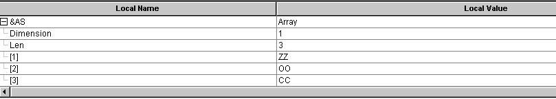

For example, given the following array:
Local array of string &AS;
&AS = CreateArray("AA", "BB", "CC");
After executing the next code, the array &AN will contain four elements, ZZ, YY, BB, CC:
&AS.Replace(1, 1, "ZZ", "YY");
After executing the next code, the array &AN will contain three elements, ZZ, MM, CC:
&AS.Replace(2, 2, "MM");
After executing the next code, the array &AN will contain three elements, ZZ, OO, CC.
&AS.Replace( - 2, - 1, "OO");
The following image is an example of &AS expanded in PeopleCode debugger.

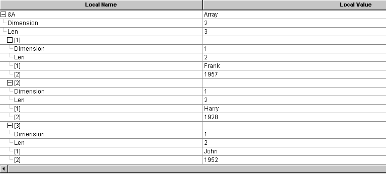

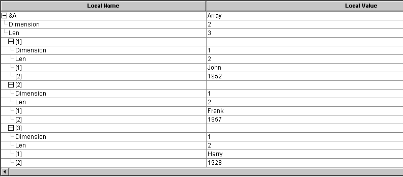

The following example changes the order of the elements in array &A to be ("Frank", "Harry", "John").
&A = CreateArray("John", "Frank", "Harry");
&A.Sort();
&A = CreateArray(CreateArray("John", 1952), CreateArray("Frank", 1957), CreateArray("Harry", 1928));
The following example changes the order of the elements in array &A to be (("Frank", 1957), ("Harry", 1928), ("John", 1952)).
&A.Sort("A");
The following image is an example of &A expanded in PeopleCode debugger, showing code results.
