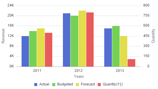

Secondary y-axis |
A secondary y-axis (or Y2 axis) is one that contains data that differs from the primary y-axis but is measured against the same x-axis data and plotted on the same chart as the primary y-axis data. |

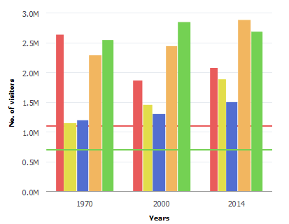

Reference area |
A reference area is displayed in conjunction with a chart as a band of color drawn based on numeric values along a chart axis. For each band of color, you would create a separate instance of the ReferenceArea class. |
Reference line |
A reference line is displayed in conjunction with a chart as a colored line drawn based on a numeric value along a chart axis. For each line, you would create a separate instance of the ReferenceLine class |

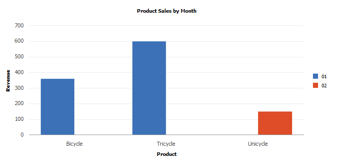

What if you also wanted to show the same information but with additional month information? The table of data that you would be interested in is:
Product |
Month |
Revenue* |
Bicycle |
01 |
360 |
Tricycle |
01 |
600 |
Unicycle |
02 |
150 |
* Numeric data

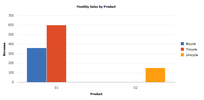

In that case, choose the Revenue field to be passed to SetDataYAxis , the Product field to be passed to SetDataXAxis , and the month field to be passed to SetDataSeries.
You would need to use a chart type that can display two dimensions along with the data. This rules out the pie chart, but you can still use a bar chart:
To get a different view of the same data, you can change the method assignments, so that Month is passed in SetDataXAxis and Product is passed in SetDataSeries . The chart that results is this:

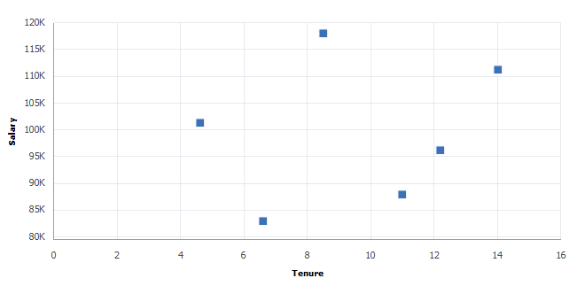

Here’s an example of a scatter chart representing the following table of data:
Tenure* |
Salary* |
11 |
88000 |
12.2 |
96200 |
4.6 |
101300 |
6.6 |
83000 |
14 |
111200 |
8.5 |
118000 |
* Numeric data
This example illustrates the scatter chart for the preceding data:
You can also use a line chart to represent the same data. Whereas the scatter chart requires both x- and y-axes to be numeric, the line chart x-axis can be either numeric or non-numeric.

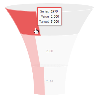

In a funnel chart one set of data is specified using the SetFunnelDataActual method and the other set of data is specified using the SetFunnelDataTarget method.
Here’s an example of a funnel chart that graphs two sets of data, a target amount and an actual amount:

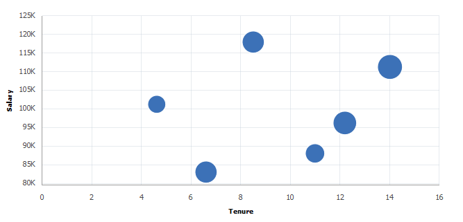

You can use the bubble chart to display three sets of numeric data. The first two sets are along the x- and y-axes just as if you were plotting two sets of numeric data. The third set of numeric data is displayed as the size of the bubble positioned at the (x,y) coordinate in the chart and is set by passing the field in the SetDataZAxis method.
Using the same data as the previous scatter chart example, a third column of numeric data (Age) is included:
Tenure* |
Salary* |
Age* |
Name |
11 |
88000 |
39 |
Joyce |
12.2 |
96200 |
55 |
Tolstoy |
4.6 |
101300 |
32 |
Shelley |
6.6 |
83000 |
48 |
Tolkien |
14 |
111200 |
59 |
Dickens |
8.5 |
118000 |
49 |
Hemingway |
* Numeric data
This example illustrates the bubble chart for the preceding data:

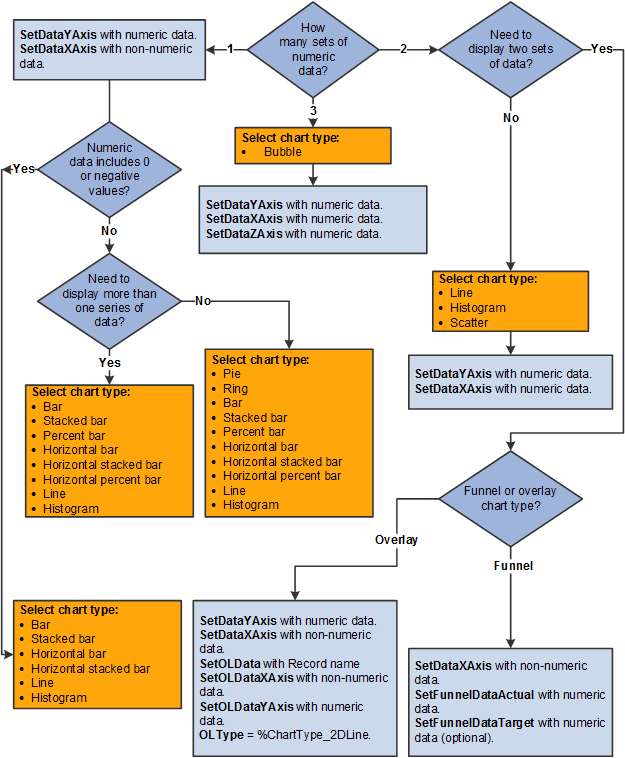

Determining the Appropriate Chart Type
Use the following procedures to determine the chart types that are appropriate for your data set:
One set of numeric data.
Two sets of numeric data.
Three sets of numeric data.
Care should be taken when using the line chart with non-numeric data on the x-axis. You should only use it when the data along the x-axis suggests some sort of progression. For example, using a line chart when the x-axis represents a sequence of months is appropriate; using a line chart when the x-axis represents a list of people in alphabetical order probably is not.
Use the following flowchart to determine which chart types are appropriate to your data. In addition, the flowchart visually presents the methods and properties to use with your chart:
Determining the Chart Type for One Set of Numeric Data
Use the following procedure to determine the chart type and methods and properties to use for one set of numeric data:
Pass numeric data to SetDataYAxis.
Pass non-numeric data to SetDataXAxis.
Does the numeric data include 0 or negative values? If yes, finish by selecting one of these appropriate chart types:
Bar
Stacked bar
Horizontal bar
Horizontal stacked bar
Line
Histogram
Note: Negative values cannot be displayed in any type of percent bar chart.
Otherwise, do you need to display more than one series of data? If no, finish by selecting one of these appropriate chart types:
Pie
Ring
Bar
Stacked bar
Percent bar
Horizontal bar
Horizontal percent bar
Line
Histogram
Otherwise, select one of these appropriate chart types:
Bar
Stacked bar
Percent bar
Horizontal bar
Line
Histogram
Determining the Chart Type for Two Sets of Numeric Data
Use the following procedure to determine the chart type and methods and properties to use for two sets of numeric data:
Do you have other non-numeric data to display? If no, complete steps 2 and 3:
Select one of these appropriate chart types:
Line.
Histogram.
Scatter.
Funnel (with both actual and target data).
Overlay.
Use these methods and properties for scatter, line, and histogram charts:
Pass numeric data to SetDataXAxis.
Otherwise, if you need to display more than one series of data in a funnel chart, complete the following:
Pass the non-numeric data to SetDataXAxis.
Pass numeric data to SetFunnelDataActual. (Alternatively, pass the numeric data to SetDataYAxis).
(Optional) Pass numeric data to SetFunnelDataTarget.
Determining the Chart Type for Three Sets of Numeric Data
Use the following procedure to determine the chart type and methods and properties to use for three sets of numeric data:
Select the appropriate chart type: Bubble.
Pass numeric data to SetDataZAxis.

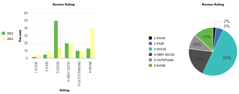

Automatic color determination occurs when neither of the other two methods is used. For all charts except pie charts, each data series is assigned a color; all data points within a series share that color. For pie charts each data point is assigned its own color. In that way it’s easier to distinguish pie segments from one another. Here is an example of the base data that will be charted:
Year |
Review Rating |
Percent |
Color |
2011 |
1-POOR |
2.00 |
0 |
2011 |
2-FAIR |
5.00 |
1 |
2011 |
3-GOOD |
50.00 |
2 |
2011 |
4-VERY GOOD |
20.00 |
3 |
2011 |
5-OUTSTANDING |
10.00 |
4 |
2011 |
6-NONE |
13.00 |
5 |
2012 |
1-POOR |
5.00 |
6 |
2012 |
2-FAIR |
10.00 |
7 |
2012 |
3-GOOD |
15.00 |
8 |
2012 |
4-VERY GOOD |
20.00 |
9 |
2012 |
5-OUTSTANDING |
10.00 |
10 |
2012 |
6-NONE |
40.00 |
11 |

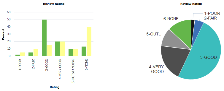

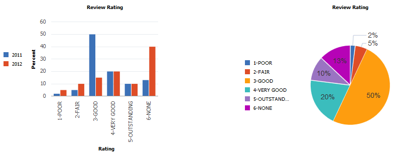

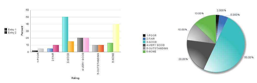

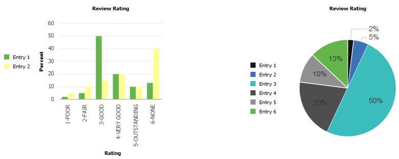

The Review Rating field is assigned to the x-axis, Percent is assigned to the y-axis, and Year is assigned to the data series:
&cChart.SetData(Record.CJY_RVW_DSTRBTN);
&cChart.SetDataXAxis(CJY_RVW_DSTRBTN.CJY_RVW_RTG);
&cChart.SetDataYAxis(CJY_RVW_DSTRBTN.CJY_DSTRBTN_PCT);
&cChart.SetDataSeries(CJY_RVW_DSTRBTN.CJY_YR);

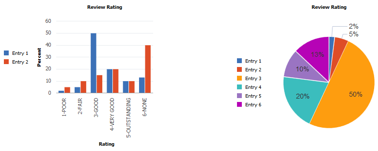

Note: In the following examples, because pie charts can display one series of numeric data only, the pie charts reflect data from the first six rows only (the first data series). The bar charts reflect both series of data.

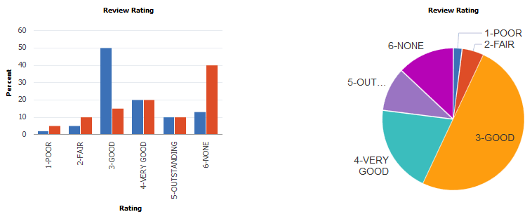

Automatic color generation results in the following bar and pie charts:

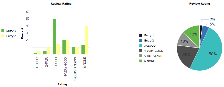

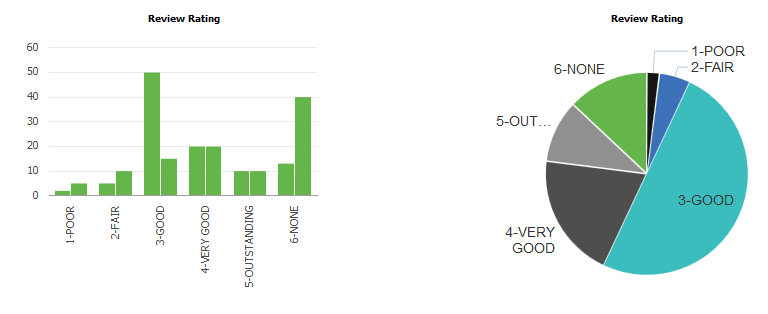

SetColorArray allows you to create an array of color values in PeopleCode and pass that to the charting engine for use in rendering the chart. It works the same way as using automatic color assignment, except that it allows you to pass in a color sequence that differs from the style sheet’s default sequence. For bar charts, each data series is assigned a color; all data points within a series share that color. In the preceding example, all data for the year 2011 is displayed in blue bars; for the year 2012, in red bars. For pie charts each data point is assigned its own color.
Using the same data as before, the SetColorArray method can be used to specify a color array:
&clr_array = CreateArray(%ChartColor_Black,%ChartColor_Blue,%ChartColor_Cyan,%ChartColor_DarkGray,%ChartColor_Gray, %ChartColor_Green);
rem The preceding is equivalent to CreateArray(0,1,2,3,4,5);
&cChart.SetColorArray(&clr_array);
Specifying the color array results in these charts:
SetDataColor works a bit differently from SetColorArray. By using the value of a record field, SetDataColor provides more granular control of bar chart colors, in that you can vary bar color data point by data point and not by the higher level data series:
&cChart.SetDataColor(CJY_RVW_DSTRBTN.CJY_COLOR);
Note that in the preceding data grid, each row of data also includes a color value. The charts that result are:
If both SetColorArray and SetDataColor are set for a chart, SetDataColor takes precedence and SetColorArray is ignored.
Setting Chart Legends
The chart property HasLegend must be set to true for a legend to appear.
&cChart.HasLegend = True;
Legend entries are determined in two ways:
Automatically
By using the SetLegend method to specify an array of legend entries
Here are charts that have automatically generated legend entries:
The default position for the legend is to the left of the chart. Set the chart property LegendPosition to move the legend to other locations next to the chart.

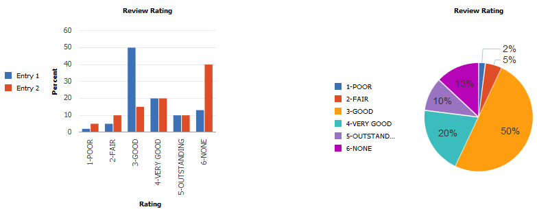

A legend entry provides a text description that explains what a color in the chart represents. The colors in the legend are sequenced in the same order as the data and colors are sequenced in the chart.
In all chart types except pie charts, the default legend entries describe the data series. In a pie chart, the default legend entries describe the data points (that is, the pie segments). In a pie chart if you have a legend, each pie chart segment is automatically labeled with the percentage it contributes to the whole.
If you use SetLegend to create legend entries, as an application developer you must ensure that the number of entries in the legend array matches exactly the number of data points that appear in your chart.
&LegendArray = CreateArray("Entry 1", "Entry 2");
&cChart.SetLegend(&LegendArray);
These charts use the specified legend array:
Note that in the case of the pie chart, there were not enough legend entries in the array to account for all the segments in the pie chart. Therefore, for the pie chart, the default legend was used.
If the number of entries in the array is increased to match the number of pie slices, there are more entries than are needed for the bar chart, which produces several undesirable results.
&LegendArray = CreateArray("Entry 1", "Entry 2", "Entry 3", "Entry 4", "Entry 5", "Entry 6");
The bar chart displays the default legend entries (2) ignoring any additional entries that were supplied in the legend array:
If the number of entries is increased to be larger than needed for either the bar chart or the pie chart, similar undesirable results are displayed for the bar chart.
"Entry 6", "Entry 7");
In this case, the pie chart reverts to the automatically generated legend:
If color is set by SetDataColor and the default legend is chosen, the bar chart only shows legend entries for the data series.
The bar chart and pie charts show default legends.
If color is set by SetDataColor and the legend array is larger than needed for either chart type, the results are also undesirable.
&LegendArray = CreateArray("Entry 1", "Entry 2", "Entry 3", "Entry 4", "Entry 5", "Entry 6", "Entry 7", "Entry 8", "Entry 9", "Entry 10", "Entry 11", "Entry 12");
The bar chart displays the default legend entries (2) ignoring any additional entries that were supplied in the legend array.
If color is set by SetDataColor and the legend array is the size required by the pie chart, the results are also undesirable.
The pie chart uses the specified legend array.
If color is set by SetDataColor and the legend array is the size required by the bar chart, the desired results are produced for both charts.
The legends for both charts are correct. The bar chart uses the specified legend array; the pie chart uses the default legend.

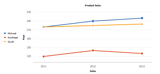

In PeopleSoft applications, chart data series are a grouping of related information. For example, if you were tracking sales for several divisions over many years, each division could be a series. Generally, every series in a chart has a distinct color. You can have more than one series in a chart for comparison. Each line in a line chart represents one series.
In the following example, the region has been set as the data series:
You can identify the data that you want in each series in two alternative ways:
Using the SetDataSeries method.
Specifying more than one field with the SetDataYAxis method.
If you use SetDataSeries, you pass into that method a RECORD.FIELD reference. That field will have values for each data item in the chart that associates the data item with a series. For instance, consider this layout of the PRODUCT_SALES table:
Year |
Sales |
Region |
2011 |
120K |
Northeast |
2011 |
220K |
South |
2011 |
220K |
Midwest |
2012 |
140K |
Northeast |
2012 |
225K |
South |
2012 |
240K |
Midwest |
2013 |
130K |
Northeast |
2013 |
230K |
South |
2013 |
250K |
Midwest |
The relevant PeopleCode would look as follows:
SetDataXAxis(PRODUCT_SALES.YEAR);
SetDataYAxis(PRODUCT_SALES.SALES);
SetDataSeries(PRODUCT_SALES.REGION);
This would produce the red, blue, and yellow lines in the preceding line chart.

The following example displays the revenue data plotted on the primary y-axis and the quantity data plotted on the secondary y-axis:
The following PeopleCode was used to generate the preceding chart:
Component Chart &oChart;
&oChart = GetChart(QE_JET_2YWRK.QE_CHART_FIELD);
&oChart.Reset();
&oChart.Type = %ChartType_2DBar;
rem Set the record for chart data;
&oChart.SetData(Record.QE_COL_MULTI_2Y);
rem Specify the field for the x-axis;
&oChart.SetDataXAxis(QE_COL_MULTI_2Y.LY_YEARS);
rem Specify multiple fields for the y-axes;
&oChart.SetDataYAxis(QE_COL_MULTI_2Y.LY_AMOUNT_ACTUAL, QE_COL_MULTI_2Y.LY_AMOUNT_BUDGET, QE_COL_MULTI_2Y.LY_AMOUNT_FORCAST, QE_COL_MULTI_2Y.QE_QUANTTY);
&oChart.SetSeriesLabels(CreateArray("Actual", "Budgeted", "Forecast", "Quantity"));
rem Specify which fields appear on which y-axis;
&oChart.SetYAxisColumnType(CreateArray(%Axis_Y, %Axis_Y, %Axis_Y, %Axis_Y2));
&oChart.XAxisTitle = "Years";
&oChart.YAxisTitle = "Revenue";
&oChart.Y2AxisTitle = "Quantity";
rem Specify whether the Y2 axis is split from the primary y-axis;
&oChart.IsSplitDualY = False;
&oChart.HasLegend = True;
&oChart.LegendPosition = %ChartLegend_Bottom;

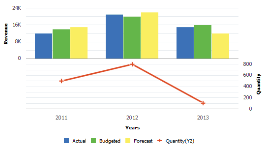

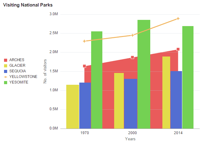

With the addition of the following PeopleCode excerpt that instantiates a Series object, the preceding PeopleCode program will plot the secondary y-axis data as a line chart instead of as a bar chart:
rem defining new Series object with its type;
Local Series &S1;
&S1 = GetSeries();
&S1.Name = "Quantity";
&S1.Type = %SeriesType_Line;
&jSeries = CreateArray(&S1);
&oChart.SetSeries(CreateArray(&S1));

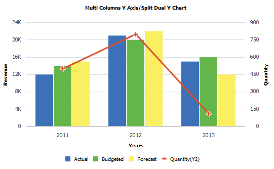

In the following chart example, the a Series object is used to plot data on the secondary y-axis as a line chart to visually differentiate it from the revenue data:
In addition, the IsSplitDualY property allows you to split the chart into two charts: one displaying the primary y-axis and the displaying the secondary y-axis.
Set IsSplitDualY to True to create a chart similar to the following:

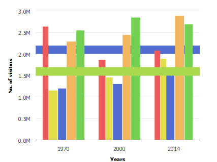

The ReferenceArea class is used in conjunction with the Chart class to display bands of color to be drawn with the chart based on numeric values along a chart axis. For each band of color, you would create a separate instance of the ReferenceArea class.
Creating Reference Areas Using the ReferenceArea Class
The essential steps to use the ReferenceArea class are:
Create an instance of the ReferenceArea class in PeopleCode by using the GetReferenceArea built-in function:
&ref1 = GetReferenceArea();Set the properties on the instance of ReferenceArea class that you created.
Add the instance to an array of ReferenceArea instances:
&ref_areas = CreateArray(&ref1);Note: For each band of color, you would add a separate instance of the ReferenceArea class to this array.
Pass the array into the SetReferenceArea method of the Chart class:
&cChart.SetReferenceArea(&ref_areas);
Using Reference Areas with Charts
To produce a bar chart similar to the following example that displays a reference area, you would create two instances of the ReferenceArea class:
While it is not required, you could create a user-defined PeopleCode function that returns the array of reference areas.
Function bld_ref_areas Returns array;
&ref1.Association = %Ref_Association_Y1;
&ref1.Description = "1 STD from Mean";
&ref1.ShortText = "Ref Area1";
&ref1.IsDisplayedTextInLegend = True;
&ref1.ReferenceAreaColor = %ChartColor_Yellow;
&ref1.ReferenceAreaValues = CreateArray(50000, 30000);
Return &ref_areas;
End-Function;
Then, you associate the array returned by this function to the instance of Chart class using the SetReferenceArea method:
&cChart.SetReferenceArea(bld_ref_areas());

To produce a chart similar to the following example that displays a reference line, you would create two instances of the ReferenceLine class:
While it is not required, you could create a user-defined PeopleCode function that returns the array of reference lines.
Function bld_ref_lines() Returns array;
&refln1 = GetReferenceLine();
&refln1.Association = %Ref_Association_Y1;
&refln1.Description = "Average";
&refln1.ShortText = "Avg";
&refln1.IsDisplayedTextInLegend = False;
&refln1.ReferenceLineLocation = %Ref_Back;
&refln1.ReferenceLineColor = %ChartColor_Red;
&refln1.ReferenceLineValue = CJY_CHRT_REF_WK.CJY_AMT;
&reflines = CreateArray(&refln1);
Return &reflines;
End-Function;
Then, you associate the array returned by this function to the instance of Chart class using the SetReferenceLine method:

&oChart.SetDataSeries(QE_CHART_NPARKS.QE_PARKNAME);
&oChart.YAxisTitle = "No. of visitors";
&oChart.MainTitle = "Visiting National Parks";
&oChart.LegendPosition = %ChartLegend_Left;
Local Series &S1, &S2;
&S1 = GetSeries();
&S1.Name = "YELLOWSTONE";
&S2 = GetSeries();
&S2.Name = "ARCHES";
&S2.Type = %SeriesType_Area;
&oChart.SetSeries(CreateArray(&S1, &S2));

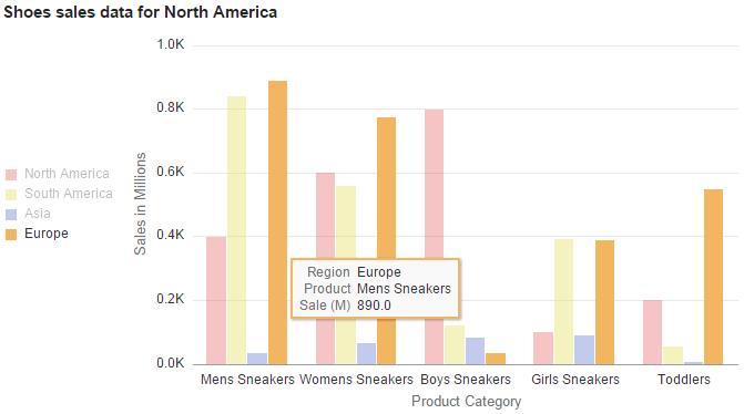

Creating Custom Tooltips
To create custom tooltips similar to the following example, you would create three instances of the ToolTipLabel class.
In the preceding example, the custom tooltip displays the x-axis data (%TooltipLbl_X), y-axis data (%TooltipLbl_Y), and the data series (%TooltipLbl_Series). The following PeopleCode program would generate these custom tooltips:
/* Declare and instantiate a chart object */
Component Chart &QEChart;
Component TooltipLabel &label1, &label2, &label3;
Component array of TooltipLabel &tooltip_labels;
&QEChart = GetChart(QE_CHART_T2_CHR.QE_CHART_T2_CHRTFL);
&QEChart.Reset();
/* Set the chart parameters for chart descriptions */
&QEChart.Type = %ChartType_2DBar;
&QEChart.MainTitle = "Shoes sales data for North America";
&QEChart.XAxisTitle = "Product Category";
&QEChart.YAxisTitle = "Sales in Millions";
&QEChart.HasLegend = True;
/* Set the chart data record and specify x-axis, y-axis, and series data */
&QEChart.SetData(Record.QE_CHART_T1_PRO);
&QEChart.SetDataXAxis(QE_CHART_T1_PRO.QE_CHART_T1_PROD);
&QEChart.SetDataYAxis(QE_CHART_T1_PRO.QE_CHART_T1_SALES);
&QEChart.SetDataSeries(QE_CHART_T1_PRO.QE_CHART_T1_REGION);
&label1 = GetToolTip();
&label1.ToolTipLabelType = %TooltipLbl_X;
&label1.ToolTipLabelValue = "Product";
&label2 = GetToolTip();
&label2.ToolTipLabelType = %TooltipLbl_Series;
&label2.ToolTipLabelValue = "Region";
&label3 = GetToolTip();
&label3.ToolTipLabelType = %TooltipLbl_Y;
&label3.ToolTipLabelValue = "Sale (M)";
&tooltip_labels = CreateArray(&label1, &label2, &label3);
&QEChart.SetToolTipLabel(&tooltip_labels);
