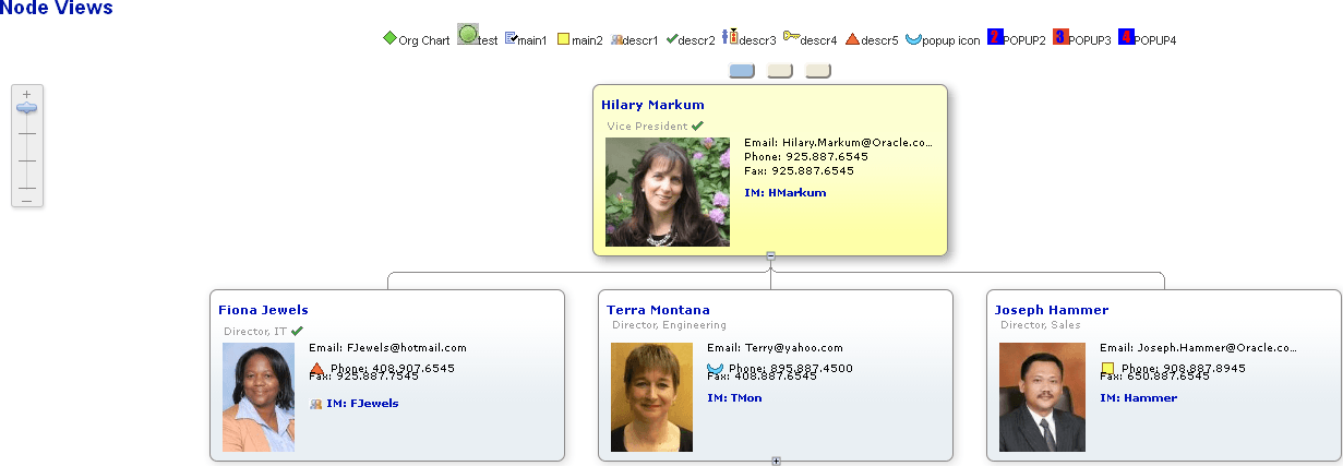

A PeopleSoft organization chart consists of two parts: the main hierarchical chart and pop-ups that enable the user to access additional related data for each node.

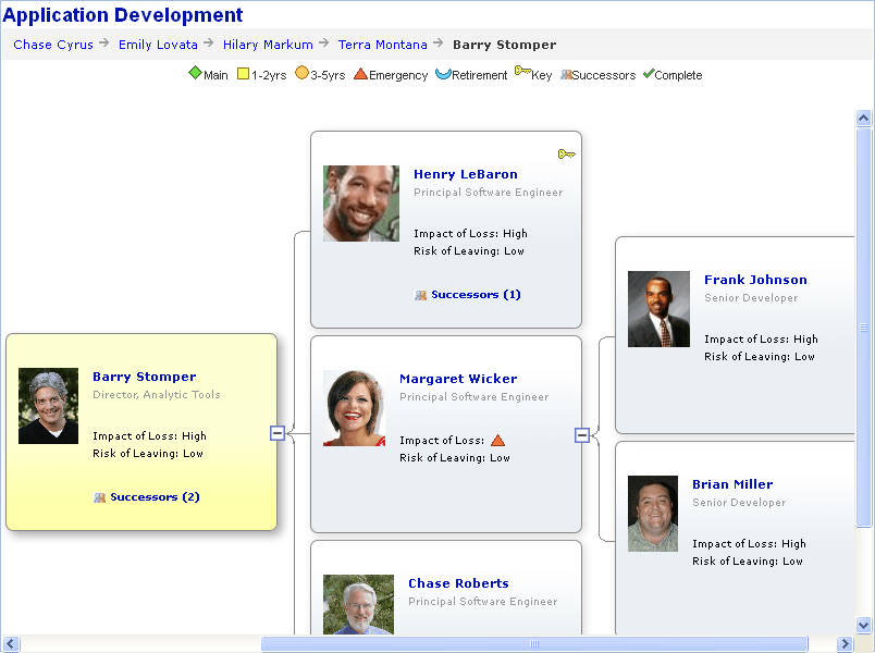

An organization chart can be oriented vertically or horizontally. Use the Direction to set the orientation of an organization chart.

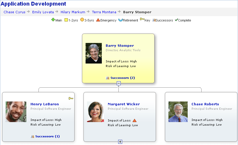

The following example shows a vertically oriented organization chart:
The following example shows a horizontally oriented organization chart:
Main Chart
The main chart can have multiple levels. Each level consists of one or more nodes. Each node represents an individual entity, such as an employee, in the organization. A node has one parent node (except the top-level node, which does not have a parent node) and zero, one, or more child nodes. Each node in the main chart has up to 99 descriptors and each descriptor can be configured as a link or as a button associated with a drop-down list box. Application developers can associate FieldChange PeopleCode with each descriptor link or button associated with a linkable drop-down list box.

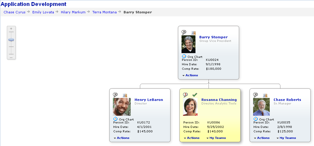

If your application implements zooming, or schema levels, you will need to incorporate PeopleCode to manage the schema levels.

Implement zooming (optional).

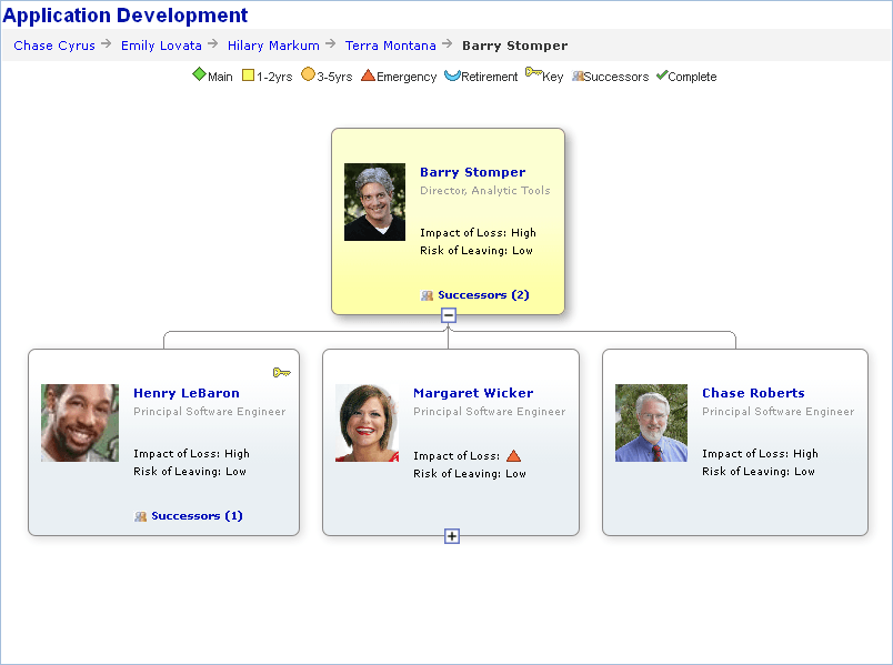

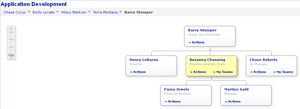

You can configure an organization chart to display breadcrumbs. Typically, breadcrumbs display the names of people in an organization hierarchy.
The following example shows an organization chart with breadcrumbs:
An organization chart can have only one set of breadcrumbs. The breadcrumbs appear horizontally at the top of an organization chart, above the chart legend if the legend is set. The breadcrumbs string wraps automatically if it is wider than the organization chart. If a breadcrumb contains a space, the breadcrumb string may wrap at the space, causing the breadcrumb to appear on two lines.
Style classes control the formatting of breadcrumbs. The default style classes are PT_ORGCHART_BRDCRM and PT_ORGCHART_UNLINK_BRDCRM. You can specify your own style classes using the CrumbDescrStyle and UnlinkCrumbDescrStyle properties.

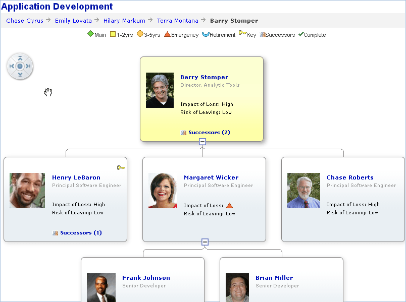

The following example shows the node that is created using the previous attributes:

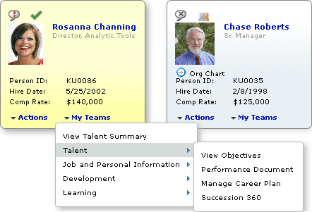

The following example shows a node configured with a related action menu.
Drop-Down Menu
A drop-down menu presents list items in a folder menu structure.
Drop-down menus can contain folders and menu items. Folders can be nested.
A drop-down menu can be linkable or read-only. If the drop-down menu is linkable, FieldChange PeopleCode associated with the descriptor field PTNDDESCnLINKABLE executes when a user clicks on a menu item. If the drop-down menu is read-only, FieldChange PeopleCode does not execute.
The following example shows a node configured with a drop-down menu.

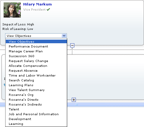

Drop-Down List Box
A drop-down list box presents a list of linkable items.
The following example shows a node with a drop-down list box.
The width of a drop-down list box is the width of the widest list item that the box contains.

To configure a descriptor as a drop-down menu or drop-down list box:
Set the PTNDDESCnLINKABLE field to “D” for a linkable drop-down menu.
Set the field to “R” for a read-only (non-linkable) drop-down menu.
Set the field to “L” for a linkable drop-down list box.
Populate the PTDESCRn_DD_ID field (or the PTDESCRn_DROPDOWN_ID if your chart does not use a display template) with the drop-down ID.
Create a derived/work record that contains the fields in the subrecord PTORGBOXLST_SBR.
Add PeopleCode to set the drop-down data record and the drop-down rowset.
For example:
&ocPBOrg.SetDropDownRecord(Record.DropDown); &ocPBOrg.SetDropDownData(&rsDropDown);Populate the drop-down data rowset with the list information for each of the drop-down list IDs.
Place FieldChange PeopleCode on the PTNODE_DESCRn field to perform corresponding logic when a list item is selected in a linkable drop-down.
The drop-down rowset defines the content for drop-down list boxes and defines the menu structure as well as the content for drop-down menus.
Populate the drop-down ID field (PTDESCRn_DD_ID using a display template, or PTDESCRn_DROPDOWN_ID if not using a display template) on the node record with a unique identifier, such as EMPL.
Populate the drop-down data rowset according to these rules:
Each list item in the menu is either a folder or a menu item.
Assign a unique value in PTORGDRPLSTITM_ID for each item.
Populate PTNODE LISTDESCR with a label for each item.
Folders have children.
Menu items have no children.
Determine the parent for each item. This is the group ID.
Set PTORGDRPLS_ GRP_ID to the parent ID, PTORG DRPLSTITM_ID.
Top-level list items have no parent. Set the group ID to blank.
Drop-down list box items have no parent. Set the group ID to blank.
Determine the display order of each list item within its group.

This section describes the basic design of an organization chart node and explains how to use node display templates to configure more complex organization chart nodes.
Using Node Display Templates
You can optionally define node display templates for more precise control over the display characteristics of descriptors on a node.
A node display template is keyed to a single organization chart node row, using the PTNODE_DISPLAY_ID field. A node display template comprises the set of rows that share a value in PTNODE_DISPLAY_ID. Conversely, an organization chart node is associated with a single node display template.
Each row in the node display template defines one descriptor.
Using a node display template, you control:
Which descriptors appear on the node. Only descriptors included in the node display template and that have PT_DISPLAY_FLAG set to “Y” will appear in the node.
Display type of descriptors (this overrides display types set in PTNDDESCnLINKABLE).
Line position and display order of a descriptor.
Number of display items on a node line.
Spacing between descriptors.

Example: Designing a Node
This section demonstrates how to lay out a node that looks like the following example:
Node Descriptors
The organization chart node (PTORGNODE_SBR) sample data in the following table generates the descriptors in the previous node example (for simplicity, not all fields are shown):

By default, organization chart nodes are sized dynamically based on the contents of the node and can vary from node to node.
For a vertical organization chart, the width of each node is based on the width of the data in the node. Width can vary from node to node. All the nodes in a given row are the same height, based on height of the tallest node, but node height can vary from row to row.
For a horizontal organization chart, the height of each node is based on the height of the data in the node. Height can vary from node to node. All the nodes in a given column are the same width, based on width of the widest node, but node width can vary from column to column.
You can use the NodeProportion property to control how nodes are sized on a chart. NodeProportion takes the following values:
0 = Variable node sizing. (Default.)
1 = Uniform node height.
2 = Uniform node width.
3 = Uniform node height and width.
4 = Square nodes.
The following example shows a vertical organization chart with uniform node height and width (NodeProportion = 3):
Applying constant node widths can create nodes with extra blank space in the node. You can reduce the node width by reducing value of the NodeMaxDisplayDescLength property.
See NodeProportion.
Node views allow you to display alternate information on a node. Using node views, you can determine which attributes to show in the node based on the organization chart’s node display template. For instance, one node view might show a person’s name, photo, and job information, while another view might show that person’s name and contact information.
Users are able to select different node views of the organization chart to see less or more data in the nodes. When node views are implemented for an organization chart, the chart displays a view controller that enables a user to select a node view.
You can define multiple node views for an organization chart. A node view definition would include a full definition of the node contents defined by the following attributes:
Which icons are displayed.
Which descriptors are displayed.
The style of the node descriptor.
The position of the descriptors on the node.

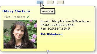

Node View Controller
The node view controller appears in the top part of the chart above the nodes but below any chart breadcrumbs or legend. The node view controller is made up of push buttons without text where each button represents a view. A data hint is used to provide the text description of the view.
The node view controller in this example displays the “Personal” node view data hint:
Creating Node Views
To set up the node view controller to enable node views, use the following two organization chart methods:
&oOrgChart.SetNodeViewEntries(&NodeViewArray);
&oOrgChart.SetNodeViewText(&NodeViewText);
NodeViewArray represents an array of node view IDs. NodeViewText is an array of data hints for each corresponding node view ID.
Additionally, the organization chart property, InitialView, must be set to indicate which view is initially displayed in the chart. For example, the property might be set as follows to show the view that is labeled “Personal.”
&OrgChart.InitialView="VIEW1";
The following example shows an organization chart with three node views defined:
Transitioning between node views will be done without a server trip. Therefore, it’s not possible to have a field change event when changing between views. Also, once the user navigates away from the chart or the chart is refreshed, the current view state is not saved. Therefore, the chart will always show the initial view set in the chart property whenever the chart is viewed again.
Zoom schemas enable you to define different visual schemas for organization charts.
Although schemas are designed to give the appearance of zooming in or out on the organization chart, in fact they are predefined views of the organization chart at different levels. Using schemas, you define what attributes to show on the node, and which nodes are displayed in each schema level. Users are able to select different views of the organization chart to see more or fewer nodes, and to see less or more data in the nodes.
You can define up to ten schema levels for an organization chart.
When zoom schemas are implemented for an organization chart, the chart displays a zoom control that enables a user to select a schema level.
The following example shows an organization chart with a zoom control and four schemas defined. The chart in this example displays schema level 3.
The chart in the following example displays schema level 1, which displays less data on each node, allowing the chart to display more nodes in the same area.
Each schema level defines the following attributes, based on the organization chart’s node display template:
See “Using Node Display Templates” in Designing Organization Chart Nodes.
In addition, you can place FieldChange PeopleCode on the PTCHART_SCHEMA_ID field of the node record to control which nodes are displayed.
When the user changes schema levels, FieldChange PeopleCode on the PTCHART_SCHEMA_ID field of the node record executes. You can set the DISPLAYED_FLAG field on the node data rowset to control whether a node is displayed at the new schema level, or you can use PeopleCode to populate the organization chart node data rowset with only the nodes you want available at the new schema level.
Use the SchemaLevel object ImageHeight property to define whether the image (photo) is displayed in the node and the height of the image.
The size of the chart nodes is determined dynamically based on the subset of data within the node and the corresponding style properties for the schema level.
SchemaLevel Class

If you specify alternative scrolling, a scroll navigator and a hand cursor appear instead of vertical and horizontal scroll bars.
Note: On an Apple iPad a user navigates using two fingers on a touch screen, so scroll bars, the scroll navigator, and mouse hand features are not displayed on an Apple iPad.
The arrows on the scroll navigator enable the user to quickly position the right, left, top, or bottom of the chart in the viewable area.
If the user scrolls the chart, the center button of the scroll navigator returns the chart to its initial display position. If the user changes focus by selecting a different node, the chart centers on that node. The center button then returns the chart to display centered on the focus node.
If alternative scrolling is implemented, the user can dismiss a drop-down menu only by clicking within the node areas in the chart unless no scrolling is needed, in which case the user can click on the background or on a node to dismiss the menu.
Note: If the breadcrumbs and chart legend are so large that there is not sufficient room to display the scroll navigator in the upper left portion of the chart, it will appear in the lower left corner.
The hand cursor enables the user to grab the background of the chart and move it within the viewable area.
Note: When using the hand cursor to scroll, you must position the hand cursor in the chart area outside the chart nodes and popup nodes. Scrolling does not work if the hand cursor is positioned within a chart node or pop-up node.
Use the ChartScrollType property to specify which type of scrolling to use. The default is scroll bars.

Select a linkable drop-down menu item or drop-down list box item.
Close a pop-up node.
Select a breadcrumb.
Click on a node image.
Click on a node.

Selecting a Linkable Menu Item or Drop-Down List Box Item
When a user selects a linkable menu item or drop-down list box item, the system sets the PTDESCRn_SI_ID (PTDESn_SLCT_ITM_ID if not using a node display record) field value to the value of the list item ID and FieldChange PeopleCode associated with the PTNDDESCnLINKABLE field executes.

PTDESCR_DRPDWN_ID |
Specifies the node description drop-down list box ID. PTDESCR_DRPDWN_ID is a key field. |
PTORGDRPLSTITM_ID |
The drop down list item ID for the specified drop down list. PTORGDRPLSTITM_ID is a key field. |
PTORGDRPLS_GRP_ID |
Specify the group ID for the drop down list item in the drop-down box. For a folder menu, set this value to the list item ID (PTORGDRPLSTITM_ID) of the parent folder. For a top-level folder, set this value to blank. For a flat (single-level) drop-down list box, set this value to blank. |
PTND_DISPLAY_ORDER |
Set the display order of the list item within the same drop-down box. By default, the list will display in the order the list items appear in the rowset. |
PTNODELISTDESCR |
The text that will appear for the drop down list item. The maximum length is 60 characters. |
PTORGLISTDESCSTYLE |
Specify the style class for the list item. The default style class for drop down list items depends on the type of drop down. |
