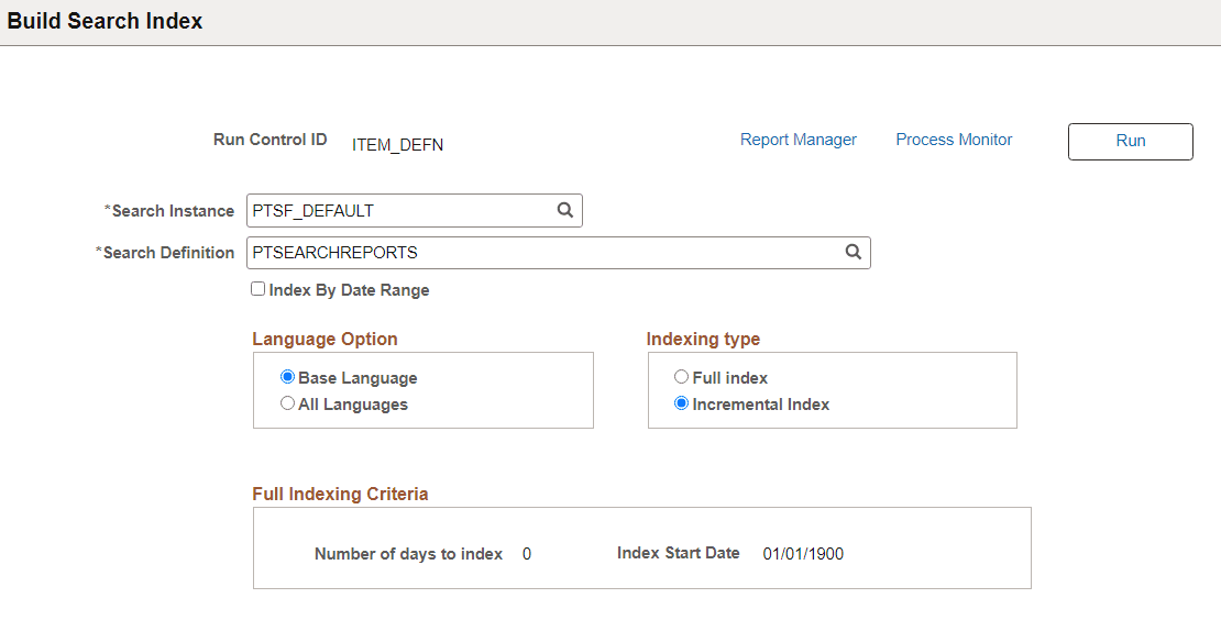

Access the Build Search Index page by selecting .
This example illustrates the fields and controls on the Build Search Index page. You can find definitions for the fields and controls later on this page.
To build a Search Framework search index:
Select .
Enter a run control ID.
On the Build Search Index page, select the appropriate options.
Field or Control
Description
Search Instance
Select the search instance in which you want to build the search index.
Search Definition
Select the search definition for which you are building the search index.
Note: Once the Run Control is executed, the page becomes read-only. To change any parameters of the page, you need to create a new run control.
Index By Date Range
Select the Index By Date Range check box if you want to index data based on date range. The date range option enables you to partition the search data and run parallel indexing processes.
Note: This property is not available if the Search Definition is configured with a data partition. Instead, Index By Data Partition is used.
For more information on the date range option, see Partitioning Application Data in the Search Index Build Process.
Select the Index By Data Partition option to index the data in parallel using data partition.
For more information on the data partition option, see Partitioning Application Data in the Search Index Build Process Using Data Partition.
Language Option
Select one of the following:
All Languages. Builds an index for each language enabled on the database.
Base Language. Builds an index only for the base language defined for the database.
Your selection depends on the languages enabled for your database and the languages through which you anticipate end users using to perform searches.
Indexing Type
Full index. Crawls all transactional data specified by the query criteria and rebuilds the entire index. This option requires the most time. This option must be selected the first time an index is built.
Incremental index. Updates the existing index and adds only documents associated with rows that have been added or updated since the last index build or update. The system determines the required updates based on a comparison between the timestamp of the index and the “last updated” field for the data row.
Items are also removed from the index as designated by the delete query on the search definition.
Search Framework provides an automated way to schedule the incremental indexing. For more information, see Automating Incremental Indexing.
Note: You must create one run control for incremental indexing, scheduled to run very frequently, and create another run control for full index rebuilding set to run less frequently. For example, incremental indexing might run daily, where a full index rebuild may be set to run every six months.
Full indexing Criteria
Applies only to full index builds. Displays the span of time in which the system will retrieve and index application data for this search definition. The date span is defined on the Advanced Settings tab for the search definition. This enables you to limit index processing for data that could potentially generate very large indexes, if needed.
For more information on this option see, Working With Advanced Settings.
If you plan to use the partitioning option through the Date Range grid, you must note that the indexing date span is overridden by the date span entered in the Date Range grid. For more information, see Partitioning Application Data in the Search Index Build Process.
Select Run.
Use Process Monitor to verify program completion and success.

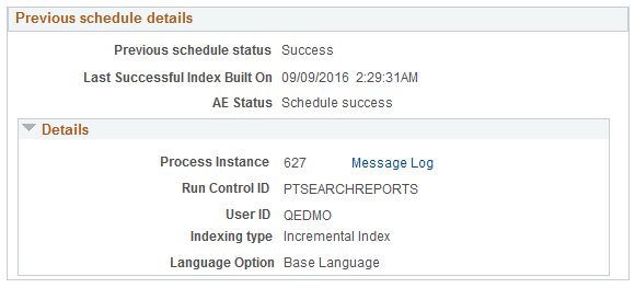

After the PTSF_GENFEED program begins to run, you can view the details which display on the Build Search Index page for that run control ID.
Note: The Details section shows the results of the most recent feed generation for this Search Definition. It may not be the same run control ID as the one you selected. If the run control ID differs from the one you selected, it will be highlighted.
This example illustrates the fields and controls on the Previous schedule details. You can find definitions for the fields and controls later on this page.
Field or Control |
Description |
Previous schedule status |
Displays the status of the most recently executed index build process. When errors occur while processing attachments, an Error link is displayed. Click the Error link to view the exceptions on the Attachment Transfer Exception Details page. |
Last Successful Index Built On |
Displays the date when the index was built successfully. If an index was never built, it displays Never. |
AE Status |
Indicates whether the most recently executed PTSF_GENFEED Application Program ran to completion. If the index build fails, this field displays the step where the process failed. |
Resume schedule |
Appears in the case where the index build failed. If the index build fails, you can use the Rebuild index option to regenerate the index. If the build fails, see Handling Common Errors to determine the cause of the failure to build an index. |
Process Instance |
Indicates whether the system successfully created the output that is required to populate the index. |
Run Control ID |
Displays the run control ID used to generate the index. |
User ID |
Displays the User ID who ran the run control, which may be a different user ID than the user who created the run control. |
Indexing Type |
Displays the index type (Full Index or Incremental Index). |
Language Option |
Displays the language options selected for the index build process (All Languages or Base Language). |

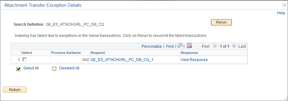

In the Previous schedule details section, select the Error link to view the details of exceptions with respect to attachment processing.
This example illustrates the fields and controls on the Attachment Transfer Exception Details page. You can find definitions for the fields and controls later on this page.
Field or Control |
Description |
Process Instance |
The process instance ID of the PTSF_GENFEED Application Engine program that is causing the exception. |
Request |
The request sent by the PTSF_GENFEED Application Engine program to the search engine. |
Response |
The response received by the PTSF_GENFEED Application Engine program from the search engine. |
Rerun |
Use the Rerun button to resubmit the selected transactions to the search engine. In the case where the maximum exceptions limit is not reached, when you select the Rerun button, the transactions are directly submitted to the search engine without re-execution of the PTSF_GENFEED Application Engine program. In the case where the maximum exceptions limit is reached, the Rerun button acts as a re-submit of the PTSF_GENFEED Application Engine program. |

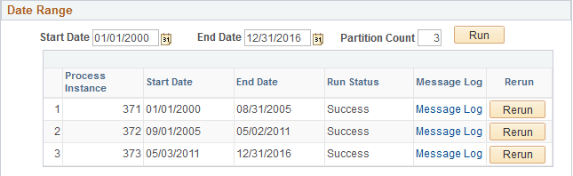

Indexing of search definitions that have reasonably large data volume can pose performance issues. To overcome such performance issues, PeopleSoft Search Framework enables you to partition the application data using the Index by Date Range option. After the date range and number of partitions are specified, the Partition Manager partitions the date range into equal date spans based on the number of partitions. The search index build process creates multiple PTSF_GENFEED Application Engine programs to run the query on the partitioned data. The search index build process also creates multiple run control IDs based on the number of partitions that enables you to re-run any of the run control IDs associated with a partition. The partitioning of application data is performed based on the date range and the number of partitions that are specified.
You can specify the number of partitions, but you cannot control the date span within a date range that is allotted for each partition. The Partition Manager allots the date span for the number of partitions specified by you. However, the Partition Manager does not consider data concentration to come up with the ranges. Hence, in case of large data volumes, the data distribution may not be equal for each partition range, resulting in some processes taking huge loads. Search Framework allows you to adjust these date ranges as needed to create an evenly spread data volume to index.
Partitioning of application data works best when the volume of data is evenly spread over the specified date range. The purpose of partitioning is to divide the data volume into chunks and to run a connected query on the partitioned data, so when you plan to use the partitioning option, you must consider whether the search documents for a specific search definition are spread evenly over a specific date range. That is, if within a date range, for example, 01/01/2017 to 03/31/2017, a huge volume of search data is concentrated in the month of March and the other two months have few attachments, and you specify 3 partitions, then the partitioning may not be very effective because only one partition may get the bulk of the search documents, so you may still face performance issues.
The naming convention followed for run control IDs that are generated for each partition is as follows: _<USERID>_RUNCNTL_<TIME>_<SEQUENCE NUMBER>
For example, _QEDMO_RUNCNTL_020022_2
Note: Partitioning is available for both full and incremental indexing. However, Oracle PeopleSoft recommends that you use partitioning only with full indexing.

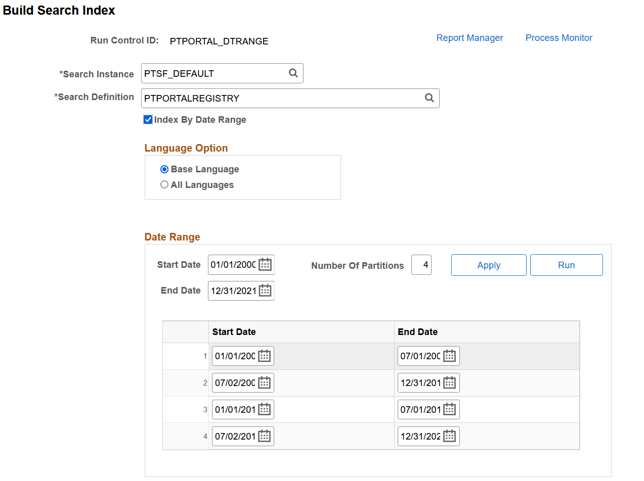

This example illustrates the fields and controls on the Build Search Index page after enabling the Index by Date Range option. You can find definitions for the fields and controls later on this page.
Field or Control |
Description |
Start Date |
Specify the start date of the date range. |
End Date |
Specify the end date of the date range. |
Number of Partitions |
Enter the number of partitions you want the search index build process to create. |
Apply |
When you select the Apply button, Partition Manager creates partitions based on the specified number. You can then modify the date ranges. Note: Save the settings before you select the Run button. |
After you use the partitioning option and run the indexing process, the Build Search Index page displays the following information.
Note: Do not use Date Range partitioning on any index that uses preprocessing unless the preprocessing has been modified to also use the date ranges. If you use Date Range partitioning on an index that uses preprocessing, it may cause unintended results.

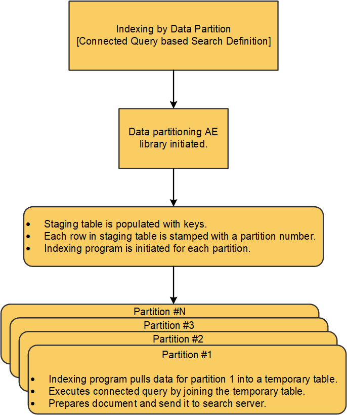

The following illustration describes the process flow involved in partitioning application data using the Index By Data Partition option.

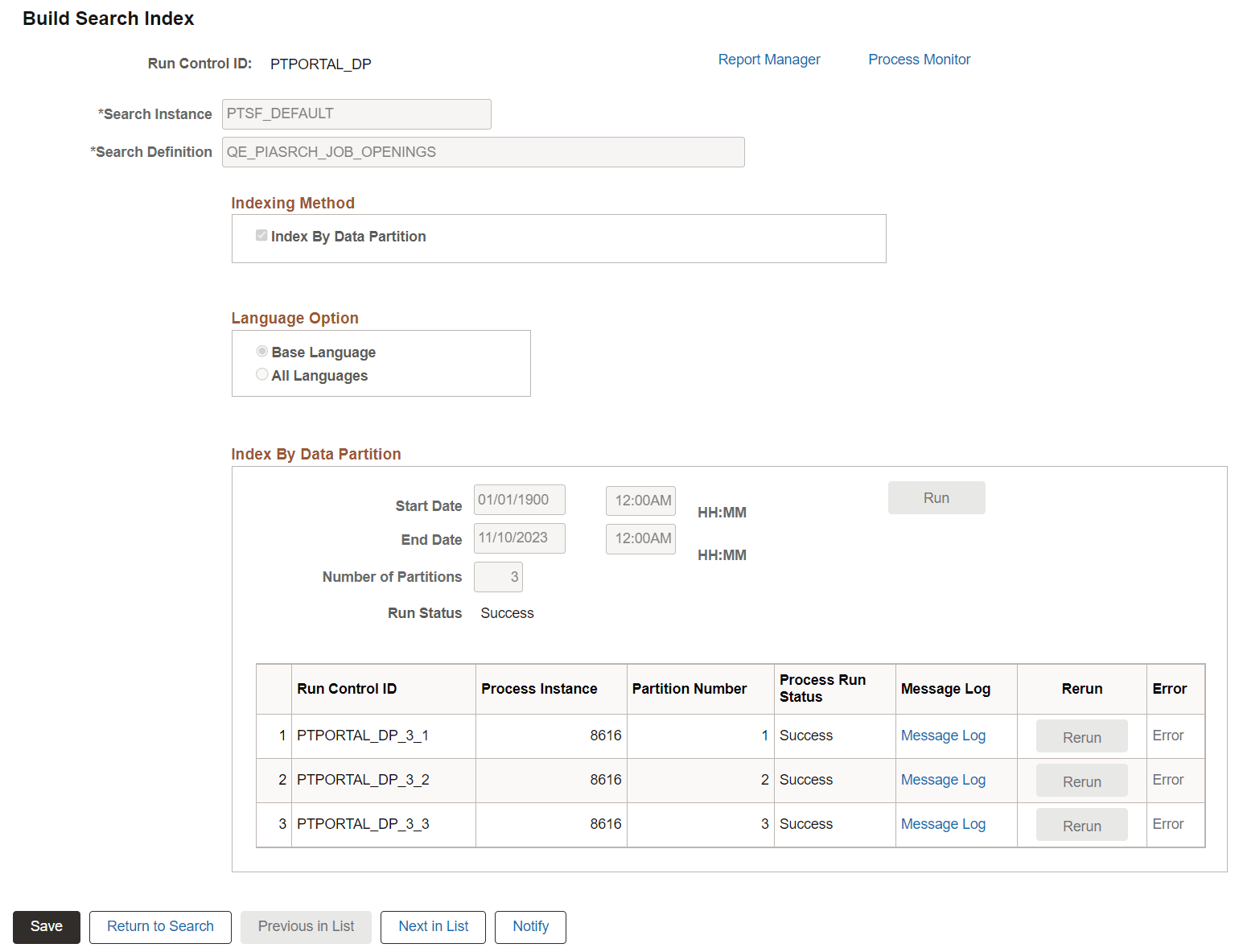

To enable the Index By Data Partition option, you must specify the values in the Index By Data Partition grid on the Advanced tab of the selected search definition. Oracle recommends that you use this option only for large data volume.
For more information, see Working With Advanced Settings.
This example illustrates the fields and controls on the Build Search Index page after enabling the Index By Data Partition option. You can find definitions for the fields and controls later on this page.
Field or Control |
Description |
Start Date |
Specify the start date time of the data to index. |
End Date |
Specify the end date time of the data to index. |
Run |
Click the Run button to start the indexing program. |
Run Status |
Displays the run status. |
Run Control ID |
Displays the run control ID used to generate for each partition. |
Process Instance |
Search index build process creates multiple PTSF_GENFEED Application Engine programs for the specified number of partitions. Displays the process instance for each partition. |
Partition Number |
Displays the partition number for each partition. |
Process Run Status |
Displays the status of each process instance. |
Message Log |
Use the Message Log link to view the progress of the process. |
Rerun |
Use the Rerun button to run the partitioned process again. This link is activated only in the case of failure. |
Error |
If the run status displays an error status, use the Error link to view the error message. This link is activated only in the case of failure. |

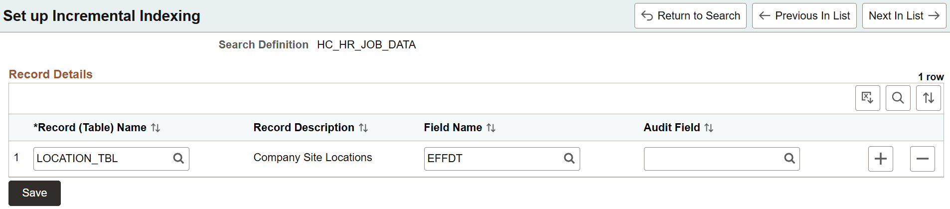

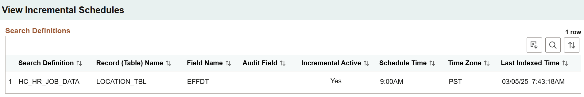

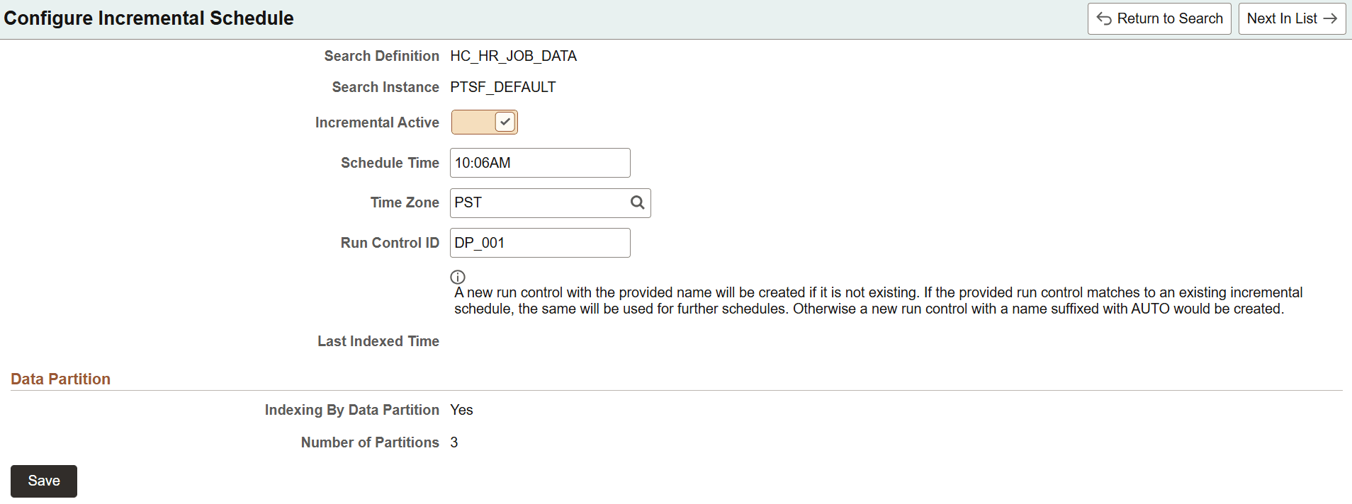

Search Framework provides an automated way to schedule the incremental indexing, enabling it to process data where real-time indexing might miss a change. For example, when a future effective-dated row becomes current, the RTI trigger will not be activated, but a new effective-date row needs to be processed.
Use the following pages to configure and schedule the incremental indexing:

Using the Set up Incremental Indexing Page
Use the Set up Incremental Indexing page to configure incremental indexing for a specific search definition that has a date or datetime field and to specify any additional information required for incremental indexing of the search definition.
Access the Set up Incremental Indexing page by selecting .
The search page displays search definitions with the source type as query and connected query from the default search instance.
The search page also provides a comprehensive view of the Incremental Active status retrieved from the Configure Incremental Schedule page, enabling you to take the necessary action on a search definition.
Select a search definition to view or modify the Incremental Indexing information.
This example illustrates the fields and controls on the Set up Incremental Indexing page. You can find definitions for the fields and controls later on this page.
Field or Control |
Description |
Record (Table) Name |
Select the table where a change in data need to initiate incremental indexing. |
Record Description |
Displays the description of the selected record. |
Field Name |
Select the date or datetime field that needs to be monitored to identify the change in data in the table. |
Audit Field |
Select the date or datetime field that acts as an audit field in the table in case a current effective date data undergoes a change or any other specific use cases where only an audit field update happens. This is an optional field. |
Using the Configure Incremental Schedule Page
Use the Configure Incremental Schedule page to activate or deactivate incremental indexing for a specific search definition and to specify any additional information required for scheduling incremental indexing of the search definition.
Access the Configure Incremental Schedule page by selecting .
The search page displays search definitions as well as their schedule and last scheduled time status, enabling you to take necessary action on search definitions.
This example illustrates the fields and controls on the Configure Incremental Schedule page. You can find definitions for the fields and controls later on this page.
Field or Control |
Description |
Search Definition |
Displays the search definition’s name. |
Search Instance |
Displays the search instance's name. |
Incremental Active |
Enable the Incremental Active button to schedule incremental indexing at the specified time. |
Schedule Time |
Specify the time for initiating incremental indexing. |
Time Zone |
Select the preferred execution time zone. |
Run Control ID |
By default the last run control from a successful indexing is displayed. However, you can provide a run control of your choice. If the given run control doesn't exist, the system automatically creates a new incremental run control. |
Last Indexed Time |
Displays the date and time when the index was scheduled successfully. |
Index By Data Partition |
Displays whether the Search Framework partitions the application data using the Index By Data Partition option. This field is populated when data partition run control is available. |
Displays the number of partitions. This field is populated when data partition indexing is enabled in the search definition. |
Using the View Incremental Schedules Page
Use the View Incremental Schedules page to view the data related to incremental indexing. This page provides a comprehensive view of the information retrieved from the Set up Incremental Indexing and Configure Incremental Schedule pages.
Access the View Incremental Schedules page by selecting .
This example illustrates the fields and controls on the View Incremental Schedules page.
The PTSFINCGENFD Application Engine program periodically monitors the configured search definitions and schedules incremental indexing when data is available for the fields specified on the Set up Incremental Indexing page for a search definition.
Oracle recommends associating a recurrence for PTSFINCGENFD to monitor data availability at regular intervals.
