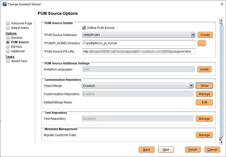

Enabling PUM Automated Merge
To enable Object Merge in Change Assistant:
In Change Assistant, select Tools, Options.
Select the PUM Source tab.
Select Enabled for Object Merge to enable object merge.
(Optional) Use the Show button for a list of mergeable objects.
Select Manage button for the Customization Repository to upload customization projects to the PUM Source. See Uploading Customer Data to Image
Note: Only Select Existing Database Object and Create New Database Project options are available on Manage Customization Repository page if Object Merge is enabled.
Select Edit button for the Default Merge Rules to review or change the default merge rules.
This example illustrates the fields and controls on the PUM Source Options. You can find definitions for the fields and controls later on this page.
If you enable object merge, the following steps get enabled in Change Assistant. Run these in the order listed:

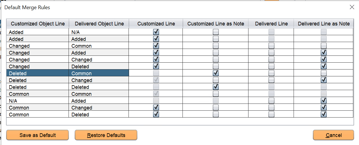

The default merge rules provide the basis for the automatic merge.
Select the Edit button for default merge rules to review or modify the default merge rules. This merge rules are considered as global merge settings and can be used in all future merge sessions.
When the merge analysis runs, if a difference is detected for a line of code, this table is used to determine the action to be taken based on the status combination.
This example illustrates the fields and controls on the Default Merge Rules page. You can find definitions for the fields and controls later on this page.
Modify the default rules as necessary for your environment.
Customized Line is the data uploaded by user to the customization and merge repository.
Delivered Line is PeopleSoft delivered data in the PUM source.
If Customized Line or Delivered Line is selected, then it is considered for merge whenever there is a merge conflict.
If the Customized Line as Note or Delivered Line as Note column is selected, the customized or delivered line will be displayed as a note and greyed out in the Merge Session. This helps to visualize and verify which line is getting merged or replaced by the merge rules. Basically, these lines are not added to the merged output.
Select the Restore Defaults button to restore the default rules that was already delivered.
Select the Save as Default button to keep the modified merge rule as default.
Review the merge rules in the following table. This table details the merge rules that are displayed in the preceding Default Merge Rules page example.
In this table, the Customized Object Line column shows the result of line by line comparison between the customized object line and the baseline object. The values such as Added, Changed, Deleted, and so on are displayed based on this comparison. Similarly, the Delivered Object Line column displays values based on the line by line comparison between the PeopleSoft delivered object and the baseline object.

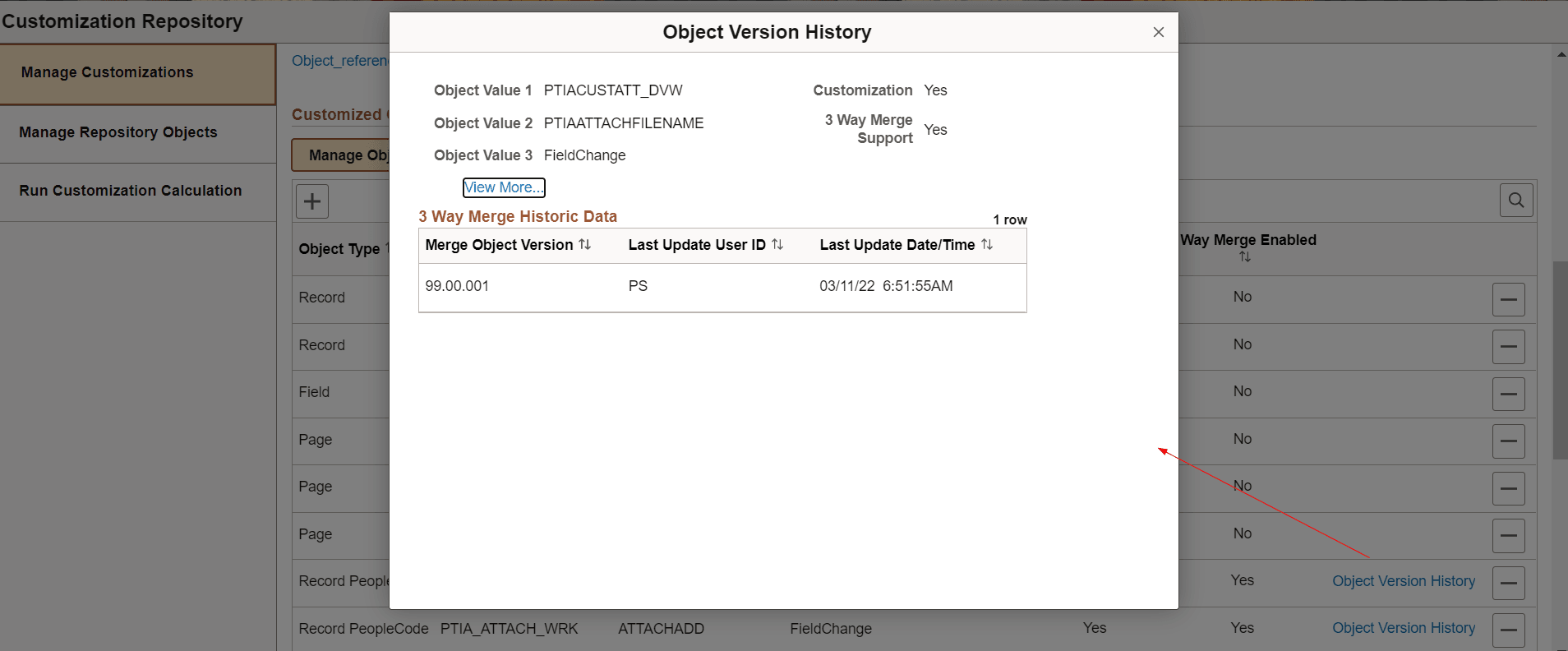

On the Customization Repository pages in PIA, you can view the version numbers of the customization objects.
This example illustrates the fields and controls on the Object Version History page.

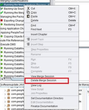

By deleting all the previous merge sessions (SESSN1), the merge output that was written-back gets deleted (M1). At this point, Change Assistant picks the latest customization that was re-uploaded (A2).
To delete, refer the succeeding section on deleting merge session.

Delete Merge Session
You can delete existing merge sessions in Change Assistant. This deletes the merge session data and the corresponding merged objects.
To delete existing merge session in Change Assistant:
Set the action type as View PUM Automated Merge Sessions.
Open the Tools menu.
Select Merge PeopleCode/SQLT/XSLT option.
Next, select Delete Merge Session.
In the Delete Merge Session window, you can select multiple merge sessions to delete using the Shift and down arrow key.
You can also delete a merge session while applying a change package.
You can also delete merge sessions from the command line.
For more details, refer to Constructing Command Line to View and Delete Merge Sessions

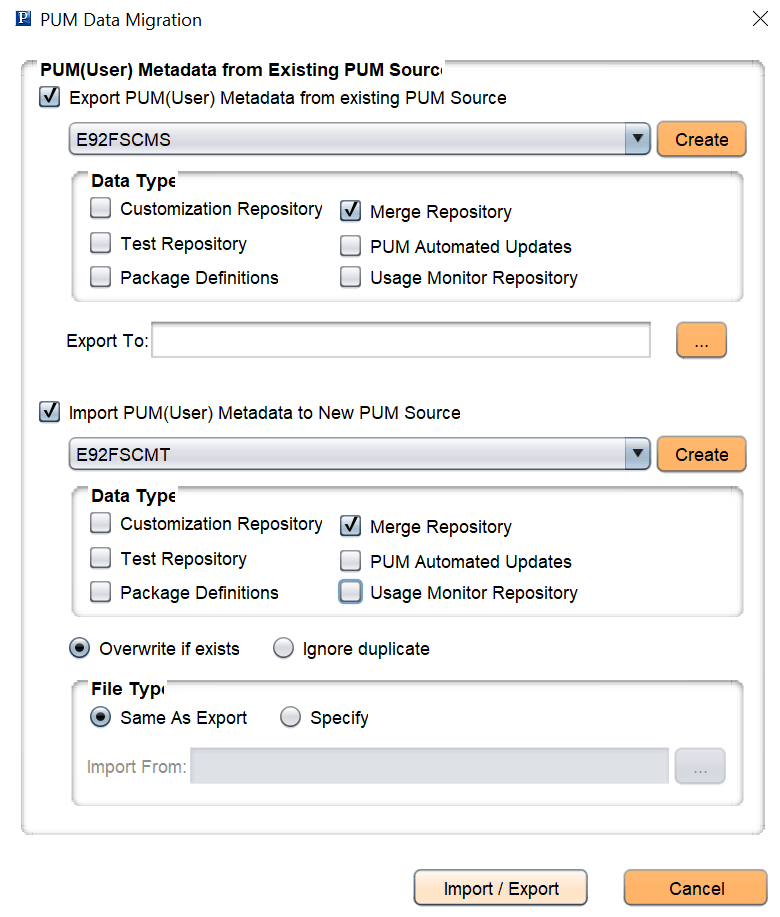

You can migrate (import or export) merge history tables.
In Change Assistant, select Tools, Options, PUM Source tab, then click Manage for Migrate Customer Data.
This example illustrates the fields and controls on the PUM Data Migration page.
Select the appropriate Merge Repository option to import or export merge history tables.
