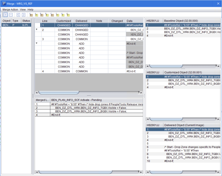

This example illustrates the different panes present on the Merge Session page. You can find definitions for the fields and controls later
When the merge analysis is run, the rules defined in the Default Merge Rules page will be applied. Refer Enabling PUM Automated Merge.
For example, the first line in Merge Edit pane shows 'CHANGED' for both Customized Line and Delivered Line. On the Default Merge Rules page (check Enabling PUM Automated Merge, Defining Default Merge Rules), the merge rule for CHANGED- CHANGED is defined to retain the Customized line and ignore the Delivered line. Therefore, in the result, only the Customized Line is displayed.

Change Assistant displays the comparison in the merge edit pane. Lines from Customized and Delivered are listed in the merge pane and in the output pane according to the merge rules.
In the merge edit pane, the Customized and Delivered column shows the state of the line and the database to which it belongs. The lines are also color coded to show the state of each line. The color codes are, by default:

The output pane displays the current merge results. Initially, the output pane displays the results of the comparison based on the merge rules. When you apply changes, the new merge appears in the pane.
Data Windows
When you select a program, Change Assistant displays the three versions of the program in the respective Baseline Object, Customized Object, and Delivered Object windows.
