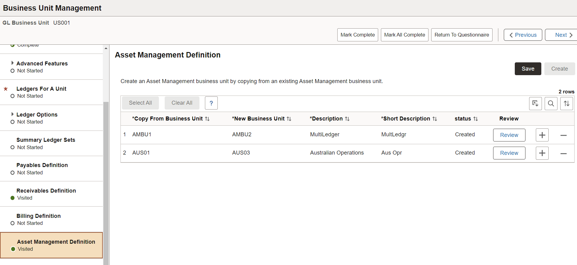

Use the Asset Management Definition page (AM_BU_COPY_FL) to modify, add, and copy Asset Management business units.
Navigation:
This example illustrates the Asset Management Definition page.
See the View Business Unit Management Page for field definitions.
Note: This page allows you to create a new Asset Management sub-ledger business unit by copying from an existing sub-ledger business unit. The new sub-ledger business unit is not created until you select the Create button. When the Create button is selected, the Review button is available to proceed to the sub-ledger Questionnaire page. The system then proceeds to the sub-ledger configuration pages.

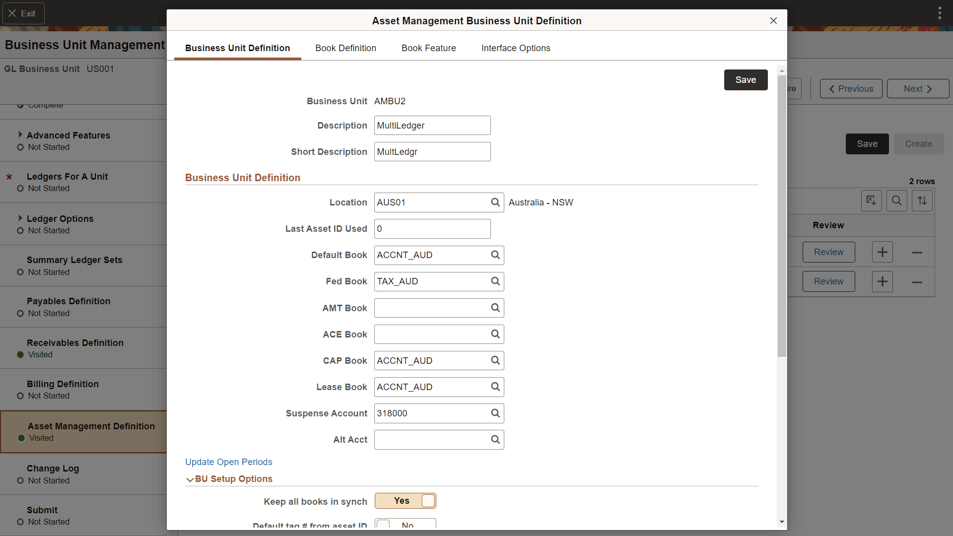

Use the Business Unit Definition page (BUS_UNIT_TBL_AM_FL) to create an asset management business unit and specify its default processing options.
Navigation:
This example illustrates the Business Unit Definition page.
See the AM Business Unit Definition Page for field definitions.

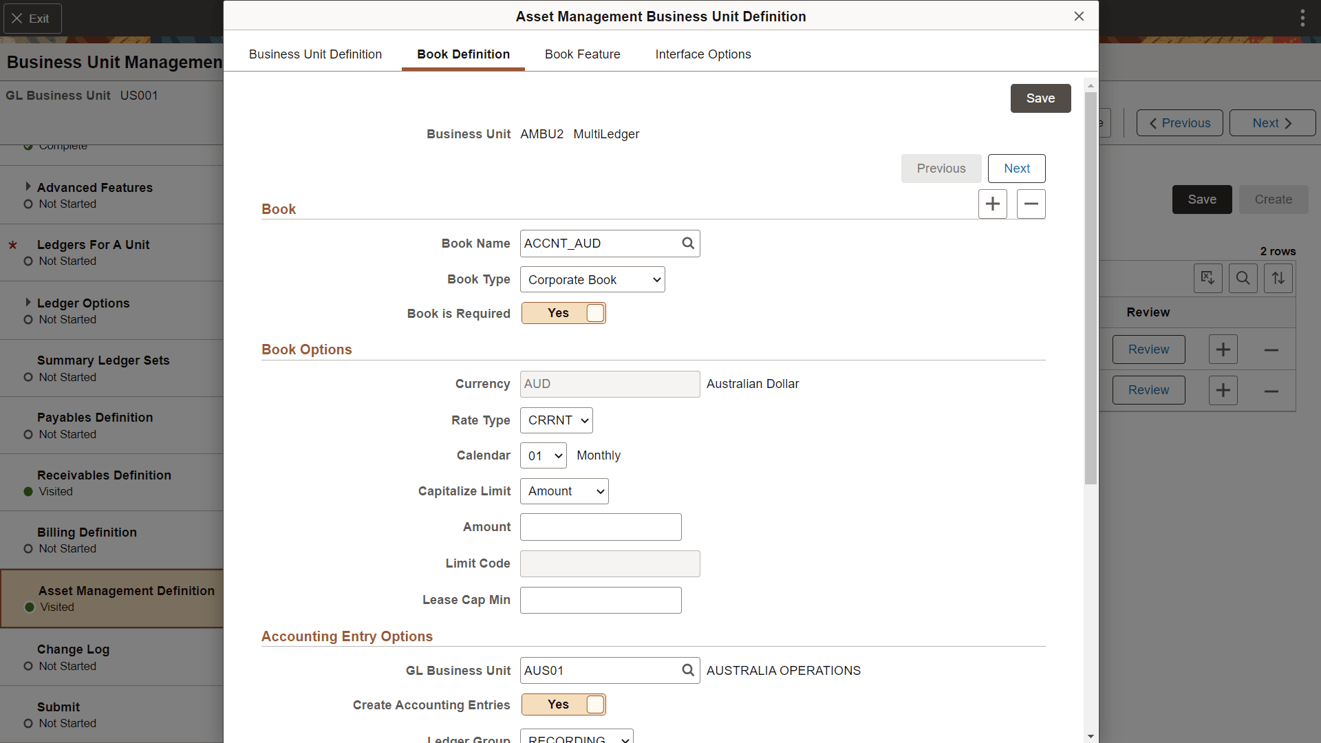

Use the Book Definition page (BU_BOOK_DEFN_01_FL) to define required books, book options, and accounting entry options for each book that the business unit uses.
Navigation:
This example illustrates the Book Definition page.
See the Business Unit/Book Definition Page for field definitions.

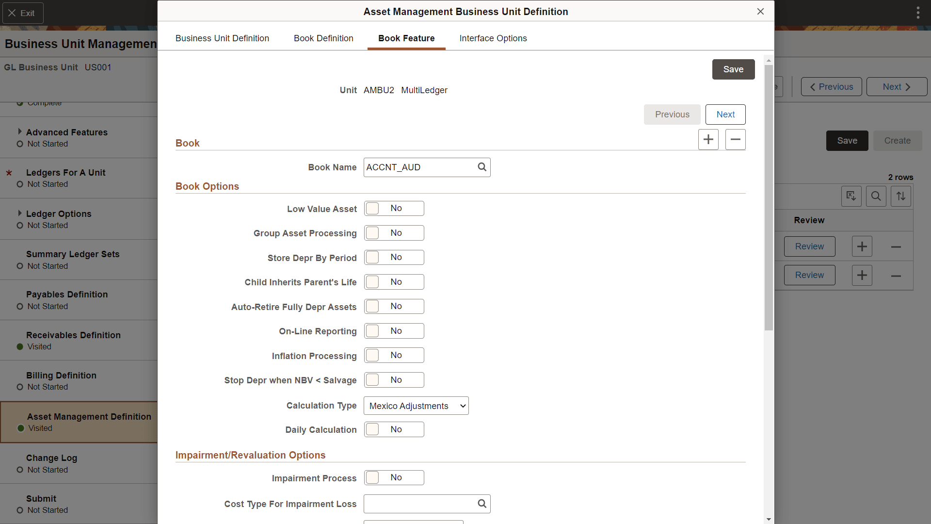

Use the Book Feature page (BU_BOOK_FEATURE_FL) to enable book and book options, and (optionally) impairment and revaluation options for a business unit.
Navigation:
This example illustrates the Book Feature page.
See the Business Unit/Book Feature Page for field definitions.

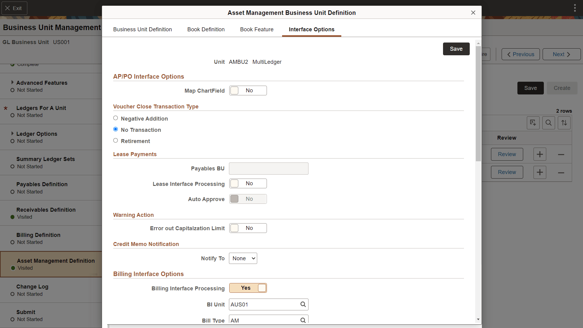

Use the Interface Options page (BUS_UNIT_INT_OP_FL) to establish product and application interface default processing options for Payables, Purchasing, Billing, Lease Administration, and Maintenance Management.
Navigation:
This example illustrates the Interface Options page.
See the Interface Options Page for field definitions.
