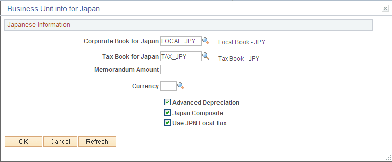

BUS_UNIT_JPN_SEC |
Select the options to process tax and depreciation for Japan. To activate theJPN Info link, you must first specify JPN as the Localization Country within User Preferences - Overall page |

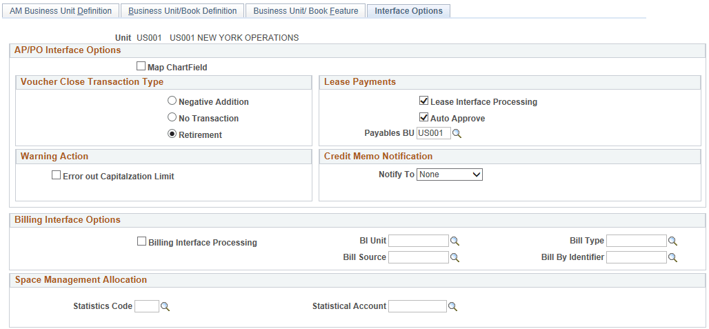

BUS_UNIT_INTFC_OPT |
Establish product and application interface default processing options for Payables, Purchasing, Billing, Lease Administration, and Maintenance Management You must enable all PeopleSoft products you want to integrate with on the Installation Options page (INSTALLATION) before integration options will be available within the Business Unit component (BU_DEFN). |

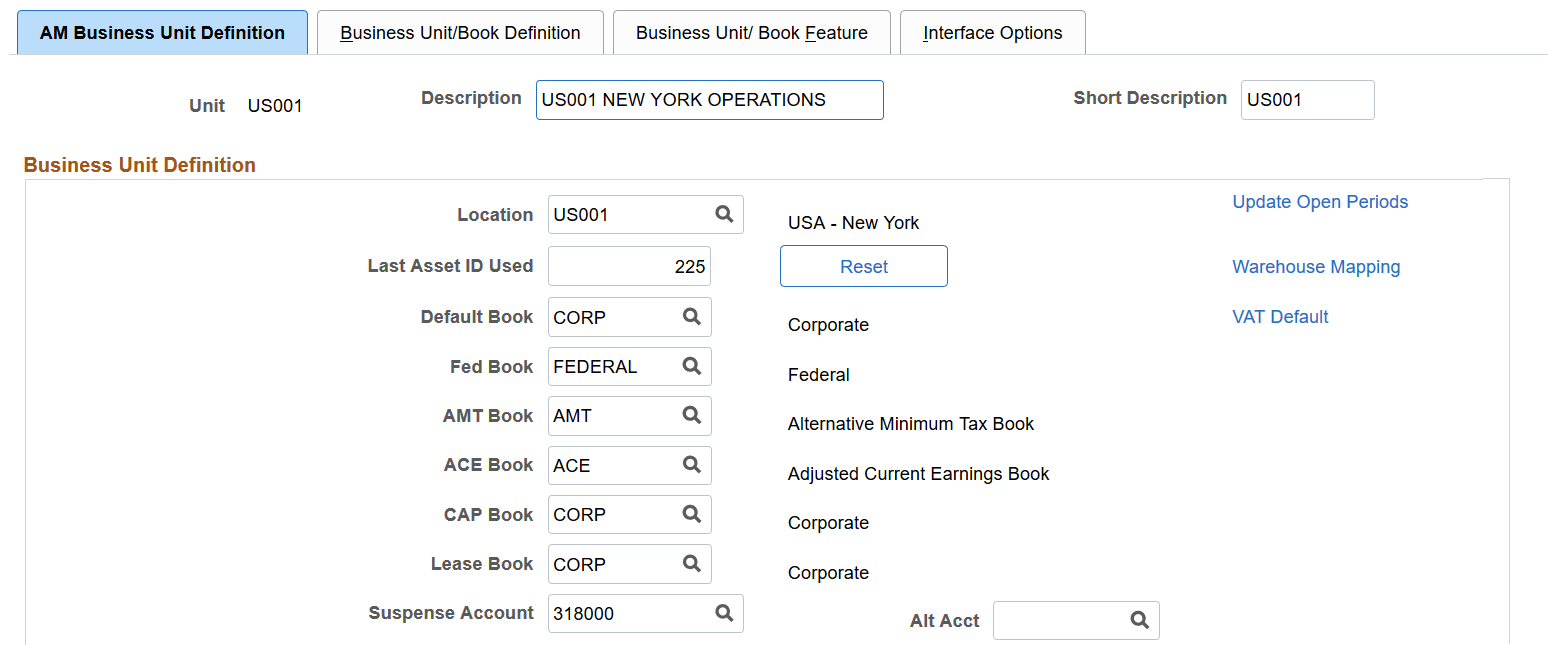

Use the AM Business Unit Definition page (BUS_UNIT_TBL_AM) to create an asset management business unit and specify its default processing options.
Navigation:

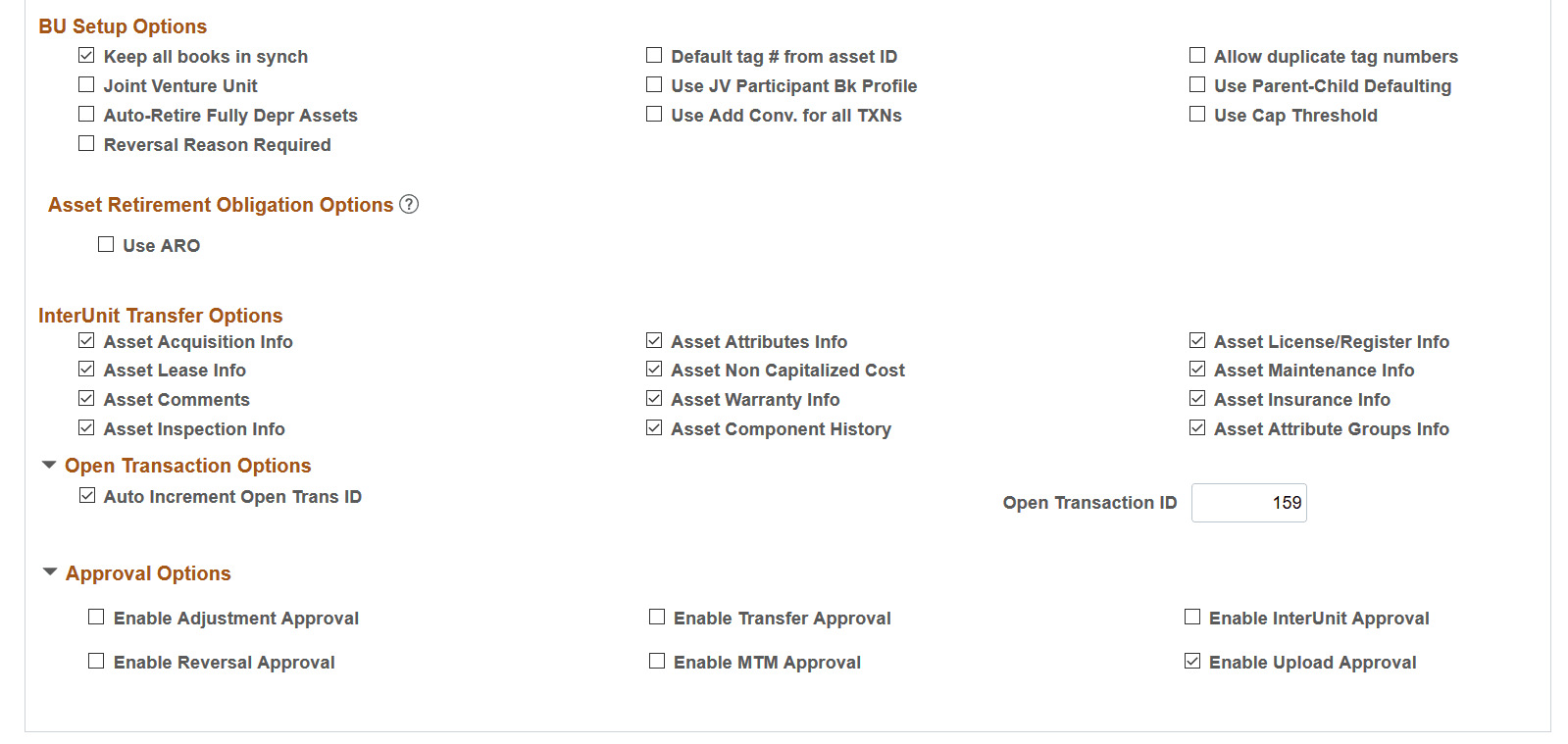

This example illustrates the fields and controls on the AM Business Unit Definition page. You can find definitions for the fields and controls later on this page.
Note: When you create a business unit, PeopleSoft Asset Management automatically defines TableSet defaulting for the business unit so that it copies the TableSet that you entered on this page. You can verify TableSet sharing by using the PeopleTools Utilities TableSet Control Group pages.
See "Planning Records, Control Tables, and TableSets" section in the PeopleTools: PeopleSoft Application Designer Developer's Guide
Field or Control |
Description |
Unit, Description, and Short Description |
Enter descriptive information to uniquely identify the business unit during set up. These fields are already populated when you select an existing business unit for update. |
Define the book to be used as the default book for general ledger entries for the business unit and all secondary books, including Corporate and Tax books (both state and federal).
Field or Control |
Description |
Location |
Select a location for this business unit. Locations available are defined on the location page table. |
Last Asset ID Used |
The last asset ID used displays here or the value is zero by default. To increment automatically from some other starting point, enter your starting point into the Last Asset ID Used field and click the Reset button. If there are no assets for this business unit, this will reset the last asset ID to zero. The Next value displays on the Asset Basic Add, Operational Asset Definition or Express Add pages when you use automatic numbering of asset ID. When the record is saved, the assigned asset ID displays and the value is incremented on this page. |
Default Book |
Select the book that is used by default when you enter assets. (This book is required for subsequent processing.) Note: PeopleSoft strongly recommends making the primary book in the ledger group in PeopleSoft General Ledger the same as the default book in PeopleSoft Asset Management in order to maximize synchronicity of transactions. |
Fed Book (federal book) |
Select the book to calculate the federal tax. |
AMT Book (alternative minimum tax book) |
Select the book to calculate the alternate minimum tax. |
ACE Book (adjusted current earnings book) |
Select the book to calculate the adjusted current earnings. |
CAP Book (capital acquisition planning book) |
Select the book used for capital acquisition planning (CAP). |
Lease Book |
Select the book where leased assets are primarily recorded. |
Suspense Account and Alt Acct (alternate account) |
Enter the translate account and alternate account here. If you have any transactions in a foreign currency within this business unit and want to enable the feature to translate currencies. If you do not have transactions outside of your local currency, you do not need to define these values. See Defining Journal Processing Options for a Business Unit. |
BU Setup Options
Field or Control |
Description |
Keep all books in synch |
Select this check box to keep all adjustments synchronized. Deselecting this check box enables you to create adjusting entries to affect particular books while excluding others. If you select this option in conjunction with a business unit that is also enabled for impairment and revaluation processing, you will have an option to create zero impairment and revaluation costs for other books. This occurs when working in the Impairment Worksheet page, the Revaluation Worksheet page, or the batch run control page and you select the Copy To Other Books check box. Warning! If you use this method to make adjusting entries, you must reselect the option before starting normal asset processing. Deselecting or selecting this option does not enable retroactive adjustments. The function is applied from the point selected going forward until and unless you change it again. |
Default tag # from asset ID (default tag number from asset ID) |
Select this check box to use the same number for the tag as the assigned asset ID. |
Allow duplicate tag numbers |
Select this check box when you are processing physical inventory. This enables you to take physical inventory and process assets that may have the same tag number. |
Joint Venture Unit |
Select if this is a joint venture business unit. Note: You cannot perform interunit transfers on joint venture business units. |
Use JV Participant Bk Profile (use joint venture participant book profile) |
Select this option for participant level. Joint venture participant business units are governed by the book for the participant level business unit or by the book for the overall joint venture business unit. You can use this feature to maintain joint venture participant business units with separate profiles that enable different depreciation methods, conventions, calculation types, and so on, as required. |
Use Parent-Child Defaulting |
Select to enable automatic parent-child inheritance processing for this business unit. For example, when you create a child asset and you want it to inherit the tag or department number from the parent asset (as specified on the Profile Child Asset Inheritance page), select this check box. For more responsive performance of Express Add, Basic Add, and Transaction Loader processes, deselect this check box. General parent-child asset processing is still enabled. |
Auto-Retire Fully Depr Assets (automatically retire fully depreciated assets) |
Select to enable automatic retirement of fully depreciated assets for this business unit. You must also enable the option at the book level. |
Reversal Reason Required |
Select this option to require that users select a transaction reversal reason when reversing transactions. |
Use Add Conv. for all TXNs (use add convention for all transactions) |
Select this option to inherit the same convention used when you added an asset for any new transaction. |
Use Cap Threshold (use capitalization threshold) |
Select to enable Capitalization Threshold processing at the business unit level. You must also enable the Capitalization Threshold feature at the system level from Installation Options. |
For more information, see Accounting for Asset Retirement Obligations
Asset Retirement Obligation Options
Use this section to define asset retirement obligation (ARO) processing parameters.
See Understanding Accounting for Asset Retirement Obligations (ARO) for more information.
Field or Control |
Description |
Use ARO (asset retirement obligation) |
Select this option to enable asset retirement obligation (ARO) processing for the asset business unit. Then, upon creating an asset, you designate it as an ARO-eligible asset within the Basic Add component. ARO functionality provides asset retirement obligation measurement and reporting in compliance with Financial Accounting Standards for leased assets, group assets, and asset impairment. You can enable ARO processing at the asset profile level, the business unit level, and the asset level. When you select this option, the following fields appear:
You can select either US GAAP Standards or IFRS Standards, but not both—all ARO assets within the business unit must adhere to the same processing method. |
US GAAP Standards (U.S. Generally Accepted Accounting Principles) |
Select this option to process ARO using Generally Accepted Accounting Principles. If you select this option, no adjustments are made to the risk-adjusted rate over the life of the ARO asset; the obligation is adjusted only for changes in the amount or timing of cash flows (the obligation continues to be measured using the rate when the decommissioning obligation was incurred). |
IFRS Standards (International Financial Reporting Standards) |
Select this option to process ARO using International Financial Reporting Standards. If you select this option, the risk-adjusted rate is used at the outset, but the rate is adjusted at each reporting date thereafter (the decommissioning obligation is re-measured each reporting period giving consideration to changes in the amount or timing of cash flows and changes in the discount rate). |
Include ARC in Impairment Test (include asset retirement cost in impairment test) |
Select this check box to include the asset retirement cost in the impairment process calculation. This option appears if you have selected the Use ARO field. |
ARO Prefix (asset retirement obligation prefix) |
Enter a prefix to be used for accounting entries that are related to asset retirement obligations. The prefix is for the asset ID that will be created to store the ARO Information (ARO-eligible asset). |
Last ARO Id (last asset retirement obligation Id) |
Specify the numerical value after which the count should be added for each subsequent ARO ID. This works in combination with the prefix. Suppose the prefix is “ARO”, when you start using the feature, the Last ARO Id will be zero. Since Asset ID has 8 characters, the first ARO created will be ARO00001. |
InterUnit Transfer Defaults Options
Select the default asset information to be shared between the business units when you make interunit transfers. The information is derived from the Asset Information component. The selections made here are the default options for the Asset Cost IU (interunit) Transfer (ASSET_COST_02) page.
Field or Control |
Description |
Asset Acquisition Info |
Select to include information derived from the Asset Acquisition Detail (ASSET_ACQ_DETAIL) page and links (ASSET_ACQ_DET_AP, ASSET_ACQ_DET_VAT). |
Asset Attributes Info |
Select to include information derived from the Asset Location/Comments/Attributes (ASSET_IMAGE) page. |
Asset License/Register Info |
Select to include information derived from the Asset Custodian/License/Manufacturer page (ASSET_CUSTODIAN) and links (ASSET_LIC_ADDR_SEC). |
Asset Lease Info |
Select to include information derived from the Leased Assets component pages (ASSET_LEASE_01, ASSET_LEASE_02, ASSET_LEASE_05, ASSSET_LEASE_03). |
Asset Non-Capitalized Cost |
Asset Maintenance Info |
Select to include information derived from the Track Service and Repairs component pages (ASSET_MAINT_01, ASSET_MAINT_01_S) and meter readings. |
Asset Comments |
Asset Warranty Info |
Select to include information derived from the Asset Custodian/License/Manufacturer page (ASSET_CUSTODIAN) and links (ASSET_WARRANTY). |
Asset Insurance Info |
Select to include information derived from the Asset Custodian/License/Manufacturer page (ASSET_CUSTODIAN) and links (ASSET_INSURANCE). |
Asset Inspection Info |
Select to include information derived from the Asset Custodian/License/Manufacturer page (ASSET_CUSTODIAN) and links (ASSET_INSPECTION). |
Asset Component History |
Select to include asset component history (AM_AST_COMP_HIST) information. |
Asset Attribute Groups Info |
Select to include asset attribute groups (AM_ASSET_SD) information. |
Open Transaction Processing Options
Open transactions are asset events such as depreciation and accounting entries that require processing. PeopleSoft Asset Management assigns each open transaction a unique open transaction ID whenever a processing option is requested. For example, changing asset cost, adding or retiring assets, or changing asset depreciation attributes all create open transactions. Depreciation must be calculated, or recalculated, and allocated for each transaction before it is considered closed. An open transaction has a Pending status until it is processed.
Field or Control |
Description |
Auto Increment Open Trans ID (automatically increment open transaction ID) |
If you want to process a large number of transactions as a group, you should deselect the Auto Increment Open Trans ID check box. For example, you enter 300 new computers into PeopleSoft Asset Management, and rather than process depreciation and distribution in 300 separate requests, you want to process all in a single request. To do so, establish an open transaction ID that identifies a single processing request for all 300 computers that you entered. In this case, you should deselect the Auto Increment Open Trans ID check box. |
Open Trans ID (open transaction ID) |
The Open Trans ID field helps you keep track of open transaction processing status. You can enter a beginning open trans ID, or you can have PeopleSoft Asset Management assign it. You can specify that PeopleSoft Asset Management automatically increment the ID value each time a transaction is added to the open transaction table by selecting Auto Increment Open Trans ID. The next processing request that you enter is automatically assigned a number that is one greater than the last assigned value. Subsequent open transaction ID numbers will be incremented by one. |

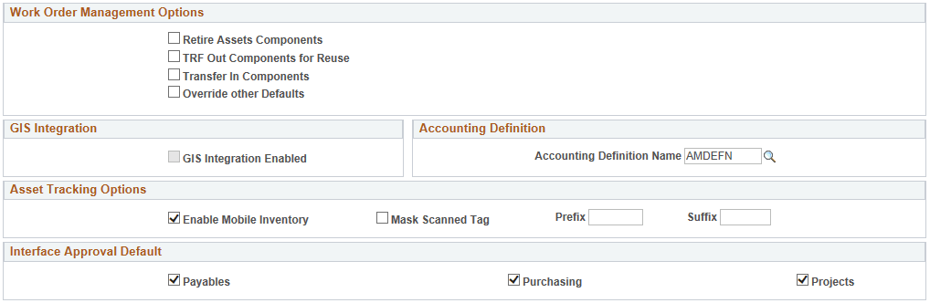

Approval Options
Use the options in this group box to enable the asset approval workflow using PeopleSoft Fluid User Interface:
Enable Adjustment Approval: Select this option to enable cost adjustment, line addition, and revaluation approvals for the selected business unit.
Enable Transfer Approval : Select this option to enable cost recategorization and ChartField transfer approvals for the selected business unit.
Enable InterUnit Approval: Select this option to enable cost fixed price markup and interunit transfer approvals for the selected business unit.
Enable Reversal Approval: Select this option to enable asset addition, adjustment, transfer, and interunit transaction reversal approvals for the selected business unit.
Enable MTM Approval (Enable Mass Transaction Manager Approval): Select this option to enable mass transaction manager approvals for the selected business unit.
The selection criteria on the Run Mass Transactions run control uses business unit to determine whether approval is triggered.
Enable Upload Approval: Select this option to enable approvals for the import data by spreadsheet process (for the selected business unit).
See: Pages Used to Approve Asset Transactions in the PeopleSoft Fluid User Interface

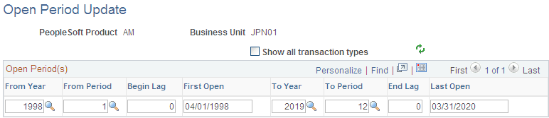

Use the Open Period Update page (OPEN_PERIOD_SINGLE) to define in which periods transactions can be posted for Asset Management.
Navigation:
Click Update Open Periods on the AM Business Unit Definition page. Open Period Update page
This example illustrates the fields and controls on the Open Period Update page. You can find definitions for the fields and controls later on this page.
The Update Open Periods page enables you to define which periods are open (periods in which transactions can be posted) for PeopleSoft Asset Management. These can be defined in relation to, but not strictly governed by, the corresponding open period in General Ledger (GL).

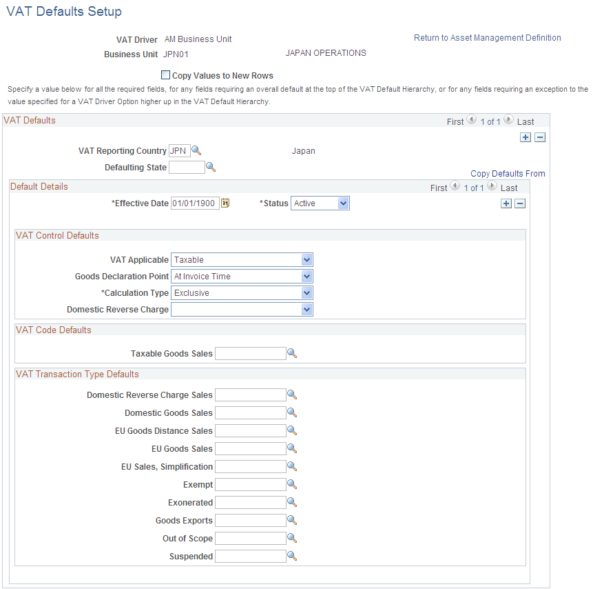

Use the VAT Defaults Setup page (VAT_DEFAULTS_DTL) to specify VAT Defaults Setup.
Navigation:
Click VAT Default on the AM Business Unit Definition page. VAT Defaults Setup page
This section provides an overview of VAT processing options and describes how to set up VAT processing defaults by business unit for PeopleSoft Asset Management.
Understanding VAT Drivers, VAT Driver Keys, and the Defaulting Hierarchy for VAT Defaults
The following table lists the PeopleSoft Asset Management-related VAT drivers and associated VAT driver keys in VAT default hierarchy sequence from most specific to least specific for the VAT Defaults component. The table also indicates which drivers control defaults for the Services VAT Treatment:
VAT Driver |
VAT Driver Keys |
Country |
State |
Applicable to Regular VAT Defaults |
Applicable to Services VAT Treatment Defaults |
ASSET_CLASS_TBL Asset Class |
Asset SetID Asset Class |
Optional |
Optional |
Yes |
No |
CUST_ADDR_SEQ Customer Location |
Customer SetID Customer ID Address Sequence Number |
Optional |
Optional |
Yes |
Yes |
CUSTOMER Customer |
Customer SetID Customer ID |
Optional |
Optional |
Yes |
Yes |
BUS_UNIT_TBL_AM AM Business Unit |
Business Unit |
Optional |
Optional |
Yes |
No |
VAT Entity Registration |
VAT Entity Country |

VAT Defaults Setup Page
This example illustrates the fields and controls on the VAT Defaults Setup Page. You can find definitions for the fields and controls later on this page.
Specify the VAT driver and any VAT driver keys as applicable. You can insert rows for any or all of the VAT driver keys as well as the VAT country or state. You can also delete any existing rows.
Field or Control |
Description |
Copy Values to New Rows |
If you are inserting a row for a VAT driver key, select this check box to copy all the VAT defaults from the previous row to the new row. Otherwise, all VAT default fields for the new row will be blank. |
VAT Defaults
Field or Control |
Description |
VAT Reporting Country |
Select the VAT reporting country or countries for which you are defining VAT defaults. For service VAT treatment defaults, defaults are obtained for the supplier's location country. PeopleSoft Asset Management does not use VAT for services, only goods. |
Defaulting State |
As applicable, enter the state for which you want to define defaulting values. (Optional depending on VAT Country) |
Copying VAT Defaults
Access the VAT Defaults Copy page (Click Copy Defaults From on the VAT Defaults Setup page.
Field or Control |
Description |
Copy From Search Criteria |
Enter the criteria on which you want to search. When copying defaults for the PeopleSoft Asset Management business unit driver, you can search by business unit, VAT reporting country, and defaulting state. |
Search |
Select to retrieve the results based on the criteria entered. The results display in the Copy From Results group box. |
Copy From Results |
In the Copy From Results group box, select the link for any of the results returned to view the details of the VAT setup from which to copy on the Copy VAT Defaults Setup page. Once you have viewed the details, you can select Copy to copy the VAT setup. The system returns you to the VAT Defaults Setup page with the copied fields. Or you can select the appropriate option for any of the results returned and select Copy to copy from the selected row. The system returns you to the VAT Defaults Setup page with the copied fields. |
Default Details
Enter the effective date and status.
The remaining fields on the page vary based on the combination of VAT driver and VAT driver keys. Depending on the combination of PeopleSoft products you are implementing and the VAT transactions conducted between your local country and other countries, you may require some variation in set up. The PeopleSoft Global Options and Reports product documentation explains these variations in working with VAT in greater detail.
You may define the following defaults for the PeopleSoft Asset Management business unit:
VAT Control Defaults
Field or Control |
Description |
VAT Applicable |
Select the appropriate VAT status. Values are: Exempt (not subject to VAT) Outside of Scope of VAT Taxable |
Goods Declaration Point |
Select when you want VAT transaction information for goods to be recognized for reporting purposes. Values are: At Accounting Date: VAT is recognized at the accounting date. At Delivery Time: VAT is recognized at time of delivery. At Invoice Time: VAT is recognized at time of invoice. At Payment Time: VAT is recognized at time of payment. |
Calculation Type |
Select the type of calculation you want the system to use. Values are: Exclusive: VAT is calculated on top of the entered transaction amount, because it excludes any VAT. Inclusive: VAT is calculated from within the entered transaction amount, because it already includes the VAT. |
(UK) Domestic Reverse Charge |
Select Yes to enable the domestic reverse charge default at the business unit level. This default indicates that the goods on transaction lines associated with the VAT Driver are domestic reverse charge goods. |
VAT Code Defaults
You use VAT codes to specify the rate at which VAT is calculated.
The VAT rate is frequently the key to reporting VAT because VAT amounts must often be reported separately by VAT rate on a VAT return. Therefore, the VAT code is part of the reporting definition.
Field or Control |
Description |
Taxable Goods Sales |
Select the VAT code to be used for taxable sales within this VAT reporting country |
VAT Transaction Type Defaults
You use VAT transaction types to classify and categorize transactions at a more detailed level for both VAT reporting and accounting. These are specified for each transaction line when you enter a transaction.
You define the VAT transaction types you need for your VAT setup. PeopleSoft also delivers a set of VAT transaction types with your system as sample data.
Field or Control |
Description |
Domestic Reverse Charge Sales |
Select the transaction type default to be used for domestic reverse charge sales. |
Domestic Goods Sales |
Sale of goods within the same country. |
EU Goods Distance Sales (European Union goods distance sales) |
Sale of goods between European Union (EU) countries in which the supplier is registered in an EU country and the purchaser is not registered in an EU country. The VAT rate charged is the rate applicable in the supplier's country. |
EU Goods Sales (European Union goods sales) |
Sale of goods within the European Union. |
EU Sales, Simplification |
This treatment is used for the transaction between an intermediary and the purchaser in cases when there is a sale of goods between European Union (EU) countries involving three parties: the purchaser, an intermediary (bill-from) supplier, and the actual goods supplier. Each party is located in a different EU country and registered in his own country, and not in either of the other two countries. The only difference between this VAT treatment and that applied to normal EU sales is that the supplier is required to print a different message on the invoice referencing the statute that applies to triangulation, rather than the one that references the statute for normal EU sales. |
Exempt |
Not subject to VAT. |
Exonerated |
Subject to exoneration from VAT. |
Goods Exports |
Export sales of goods. |
Out of Scope |
Outside of the scope of VAT. |
Suspended |
Subject to suspension of VAT. |
Use the Business Unit Info for Japan page (BUS_UNIT_JPN_SEC) to Select the options to process tax and depreciation for Japan.
Navigation:
Click the JPN Info link from the AM Business Unit Definition component.
The JPN Info (Japan information) link appears on the AM Business Unit Definition page when you set up the overall options for user preferences (OPR_DEF_TABLE_FS1) in the Common Definitions component: Set the Localization Country value to JPN (Japan).
This example illustrates the fields and controls on the Business Unit info for Japan page. You can find definitions for the fields and controls later on this page.
Field or Control |
Description |
Corporate Book for Japan |
Select the corporate book for Japan. |
Tax Book for Japan |
Select the tax book for Japan. Note: PeopleSoft recommends that you select the primary book in the ledger group in PeopleSoft General Ledger to be the same as the default book in PeopleSoft Asset Management. As tax books do not usually send accounting entries to PeopleSoft General Ledger this maximizes synchronicity of transactions. |
Memorandum Amount and Currency |
Enter the memorandum amount at the end of the useful life of the asset as required by the Japanese tax regulation. This value is used in conjunction with the following depreciation methods:
The memorandum amount reflects the currency of the tax book for Japan as the default. For books that use one of the aforementioned depreciation methods in a currency other than JPY, the memorandum amount is translated to the respective book's currency. The memorandum value is established for each asset management business unit. |
Advanced Depreciation |
Select if advanced depreciation is used. |
Japan Composite |
Select if composite assets are used. |
Use JPN Local Tax |
Select if local tax reporting is enabled. |

Use the Interface Options page (BUS_UNIT_INTFC_OPT) to enable mobile physical inventory and establish product and application interface default processing options for Payables, Purchasing, Billing, Lease Administration, and Maintenance Management.
Navigation:
This example illustrates the fields and controls on the Interface Options Page (1 of 2). You can find definitions for the fields and controls later on this page.
This example illustrates the fields and controls on the Interface Options Page (2 of 2). You can find definitions for the fields and controls later on this page.
This page provides the options available for interfacing with Payables, Purchasing, Billing, Lease Administration (space management allocation), and Maintenance Management applications.
AP/PO Interface Options
Field or Control |
Description |
Map ChartField |
Select this check box to enable ChartField mapping for Payables and Purchasing asset processing. |
Voucher Close Transaction Type
When a new asset is created from a PeopleSoft Payables voucher and sent to PeopleSoft Asset Management, a new asset is created. If the payables voucher is then closed you have to post the voucher again. The default Voucher Close Transaction is Retirement.
Note: If a voucher is unposted the load type will result in a negative ADD (Load type AAD).
Field or Control |
Description |
Negative Addition |
Results in a negative addition (AAD) to the asset that was originally created by the voucher. |
No Transaction |
No transaction is generated for this event, and the process to remove it from PeopleSoft Asset Management must be entered manually. You can remove the created transaction from open transactions if depreciation has not been run. If depreciation has been run, and the asset has been set up in the system and posted to GL, you must enter a retirement or negative addition transaction to remove it from the books. Acquisition detail will still be inserted for the closed voucher for audit purposes, but no cost rows or financial transaction will be generated. |
Retirement |
Creates a retirement transaction (RET) to retire the asset that was originally created by the voucher. If any depreciation has been taken during the interim period, it will be reversed and removed from the corporate books. Gain and loss will be calculated. This is the default if no other option is specified. |
Note: If either Negative Addition or Retirement are selected and both the first posting and the unposting of the voucher are processed in the same run of the AP/PO Interface (AMPS1000), no assets are created. The two transactions cancel each other out. The load status for both transactions is set to Consolidated.
Lease Payments
Use this group box to enable the options related to the integration between PeopleSoft Asset Management and PeopleSoft Payables for lease payments. This integration enables automatic generation of vouchers for lease payments that are calculated in Asset Management, including both capital and operating leases. In addition, the lease payment schedule segregates the principal and interest of each payment and is used by the AMDPCLOS process to generate the payment accounting entries. The payments can be allocated on a monthly basis, depending upon your setup of payment schedules.
Select the appropriate options for processing automatic vouchers for lease payments in the Lease Payments group box.
The lease payment integration sends to PeopleSoft Payables the information that is stored in the book defined as Lease Book on the AM Business Unit Definition page.
Note: If you have migrated your Asset Management lease data into Lease Administration (per PeopleSoft’s compliance with ASC 842 and IFRS 16 lease accounting standards), you should not utilize the fields in this group box.
For more information, see:
Understanding the Data Migration and Transition Process
Field or Control |
Description |
Lease Interface Processing |
Select to enable the lease payment interface options at the lease entry level. This integration provides the automatic generation of vouchers in PeopleSoft Payables for lease payments that are calculated in Asset Management, including both capital and operating leases. Selecting this check box also activates the other fields in the Lease Payments group box. Note: Lease Interface Processing is deselected by default as the selection of this option makes mandatory certain fields at the lease entry level that are otherwise optional. |
Auto Approve |
Select to enable automatic approval. When selected, the lease payments do not require manual approval before processing to PeopleSoft Payables. |
Payables BU: |
Enter the Payables business unit to be used by default when creating lease schedules for integration to PeopleSoft Payables. |
Warning Action
Field or Control |
Description |
Error Out Capitalization Limit |
Select to receive warning if amount exceeds capitalization limit. |
Credit Memo Notification
Set up Notification of asset-applicable credit memos from PeopleSoft Payables.
Field or Control |
Description |
Notify To |
Select one of the following options to define notification recipients:
This field only appears if you select the E-Mail Notify To option. Supply an email address of the intended recipient of the credit memo notification. |
Roleuser |
This field only appears if you select the Role Notify To option. Select a specific role. Users associated with this role receive credit memo notifications. |
Operator Id |
This field only appears if you select the User Notify To option. Select a specific user ID. Those logged in with the selected user ID receive credit memo notifications. |
See also Load Assets Request Page
Billing Interface Options
Complete the appropriate definitions for processing billing transactions in the Billing Interface group box. The information entered here appears on the Create Bill tab of the Retirement page. The physical nature from PeopleSoft Asset Management is Goods but can be changed in Billing.
Field or Control |
Description |
Billing Interface Processing |
Select to establish processing between PeopleSoft Asset Management and PeopleSoft Billing. This activates integration between the two applications and enables the Create Bill option on the Asset Management Retirement page. Note: PeopleSoft Billing is the only billing interface that is supported by this feature. |
BI Unit |
Select the Billing default business unit. The available Billing business units are established during the Billing application implementation. You can override the BI Unitas needed. Only BI Unitcan be overridden on the retirement page for other PeopleSoft Billing business units whose general ledger business unit matches the PeopleSoft Asset Management business unit. |
Bill Source |
Select the billing source, such as Assets. Available options are established during the Billing application implementation. You cannot override Bill Source. |
Bill Type |
Select the Billing Bill Type, such as AM . Available options are established during the Billing application implementation. You cannot override Bill Type. |
Bill By Identifier |
Select the Billing Bill By Identifier such as Assets . Available options are established during the Billing application implementation. The Bill By Identifier will vary if the business unit is VAT enabled. You cannot overrideBill by Identifier. Note: If the Bill By Identifier should consider VAT transactions, PeopleSoft strongly recommends using the following fields: BUSINESS_UNIT_AM, BILL_SOURCE_ID, VAT_TREATMENT_GRP, COUNTRY_VAT_BILLFR, COUNTRY_VAT_BILLTO, COUNTRY_SHIP_FROM, COUNTRY_SHIP_TO, PHYSICAL_NATURE, SHIP_TO_CUST_ID, RATE_MULT, RATE_DIV, CUR_RT_SOURCE, SHIP_TO_ADDR_NUM. Otherwise: BUSINESS_UNIT_AM, BILL_SOURCE_ID, PHYSICAL_NATURE, RATE_MULT, RATE_DIV, CUR_RT_SOURCE. |
See Integrating with PeopleSoft Billing.
See Understanding PeopleSoft Billing and Asset Management Integration.
Space Management Allocation
Complete the appropriate definitions for processing Lease Administration space allocation transactions in the Space Management Allocation group box. The information entered here creates the default tree name, statistics code, and statistical account for this business unit in the Lease Administration space allocation application.
Field or Control |
Description |
Statistics Code |
Select the statistics code value associated with this space allocation. |
Statistical Account |
Select the statistical account value associated with this space allocation. |
Work Order Management Options
When you integrate PeopleSoft Asset Management with PeopleSoft Maintenance Management, you can define work order transfer default options.
Field or Control |
Description |
Retire Assets Components |
Select this check box to enable retirement processing for components from work orders. |
TRF Out Components for Reuse |
Select this check box to enable component transfers out for reuse from work orders. |
Transfer In Components |
Select this check box to enable component transfers in from work orders. |
Override Other Defaults |
Select this check box to allow default overrides from work order. This option is used for making the set up defined at BU level prevail over set up at other levels. |
GIS Integration Enabled |
Select to enable the integration of a Geographic Information System (GIS) with PeopleSoft Maintenance Management. This check box is available for selection when GIS Integration has been enabled at the system level first (Installation Options - Overall page.) See Installation Options - Overall Page. You must also complete the required setup on the GIS Setup page (Set Up Financials/Supply Chain, Common Definitions, GIS, GIS Setup.) |
Accounting Definition
Enter a value for the Accounting Definition Name field for the selected business unit.
This field provides a default value for the Accounting Definition Name field on the:
Pending Journal Generator page (AM WorkCenter)
Create Accounting Entries page
Close Depreciation page
Note: This field is optional for the Create Accounting Entries and Close Depreciation pages, but required for the Pending Journal Generator page in the AM WorkCenter. The Pending by Business Unit grid requires this default value and Journal Generator cannot be run from the page without it.
Asset Tracking Options
Field or Control |
Description |
Enable Mobile Inventory |
Select the Enable Mobile Inventory option to enable mobile physical inventory for a business unit. |
Mask Scanned Tag |
Select to mask the scan value when tag numbers are scanned in the asset tracking tiles. The Mask Scanned Tag check box is available for selection only when Enable Mobile Inventory check box is selected. You can also provide a prefix or suffix if Mask Scanned Tag check box is selected. Note: If you are using the prefix and/or suffix values, then you need to have the barcode labels attached to the assets replaced with labels that include the prefix and/or suffix values. |
Interface Approval Default
Select the check box to set the Auto Approval Status in the Interface Financial and Physical tables. The Auto Approval status is set at the Business Unit level based on which product the transaction is coming from. The Load Transaction into AM process use this value to validate the transactions and send them to the Asset transaction tables.
