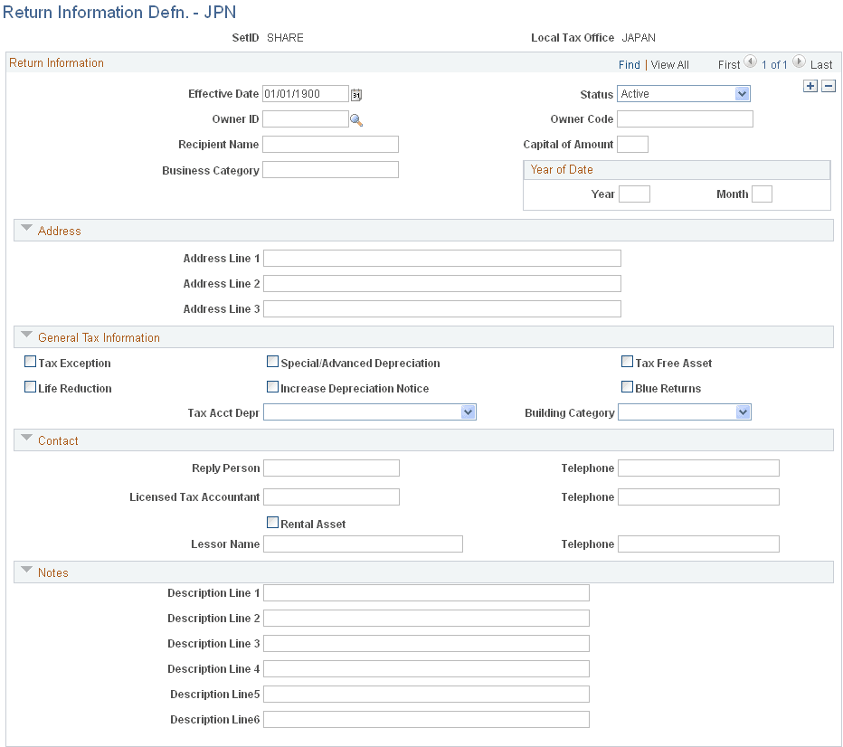

Return Information Page |
RETURN_INFO_DEFN1 |
Enter information that is required for the Depreciable Asset Tax Return (Tax Roll) report. |

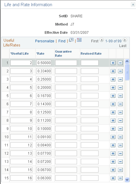

Note: The straight line rates are derived from the Life and Rate Information page for the Tangible/Straight Line Revenue (J7) depreciation method. The final year's depreciation is the annual depreciation amount less the memorandum value (no salvage value). See Understanding Depreciation Processing |
Depreciation Rate - User Defined – Life and Rate Information Page
PeopleSoft Asset Management supports useful life in years as specified for Japan. This is applied from the Rate-User Defined table (UD_DEPR_RATE_TBL, MR_AM_LIFERATE) in the Depreciation Rate-User Defined component. To apply the appropriate depreciation rates, use the delivered depreciation methods for Japan or add new ones as needed.
Use the Depreciation Rate-User Defined page (UD_DEPR_RATE_TBL) to set up useful life and depreciation rate tables.
Navigation:
Select a setID and a depreciation method code matching the depreciation method to be used. Enter the effective date, and click the Life and Rate Information button. The Life and Rate Information page displays.
This example illustrates the fields and controls on the Life and Rate Information page. You can find definitions for the fields and controls later on this page.
Enter the useful life and corresponding rates as determined by regulations issued from the Ministry of Finance. The Guarantee Rate and Revised Rate fields are only used in the Tangible/Declining Balance depreciation method.
Note: Useful Life rates also use the Residual Rate Definition.

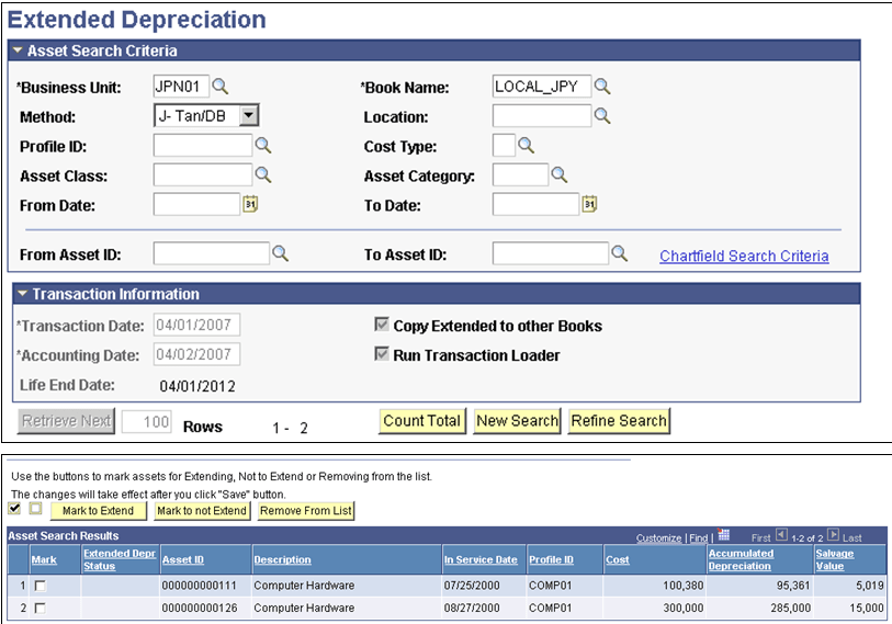

Use the Extended Depreciation Worksheet page (AM_EXTENDED_DEPR) to search for candidate assets according to desired parameters.
Select to extend or not extend the depreciation period, remove from the list and enter the dates to resume depreciation.
Navigation:
The 2007 Japanese Tax Reform affects not only assets that are placed in service after March 31, 2007 but also increases the depreciation basis and expands the depreciation period for those fully depreciated assets that are using the Tangible/Straight Line and Tangible/Declining Balance depreciation methods. As a result, those depreciable assets acquired before April 1, 2007 are allowed, after having depreciated to the final depreciable limit, to depreciate the existing salvage value to the memorandum value of 1 JPY in five years using the Straight Line method.
Use the Extended Depreciation Worksheet to apply the extended depreciation calculation to assets after they have reached the depreciation limit under the Tangible/Straight Line and Tangible/Declining Balance depreciation methods. You can also identify assets that qualify for the extended depreciation using the Extended Depreciation Worksheet.
This example illustrates the fields and controls on the Extended Depreciation page. You can find definitions for the fields and controls later on this page.
Enter the required fields Business Unit, Book Name, and Method to retrieve assets that are candidates for extended depreciation (those assets depreciated using the Tangible/Straight Line and Tangible/Declining Balance methods and are fully depreciated up to 95% of asset cost). You can also search by ChartField by clicking the ChartField Search Criteria link or use a date range to retrieve assets whose original transaction dates fall within the given period.
The Transaction Information section relates to the information needed to perform the extension of the asset useful life. It is applicable to the assets in the Results section. The Transaction Date should match the date that depreciation resumes for extended depreciation. The Life End Date field shows the calculated date in which the depreciation activity stops, including the additional period due to rounding down the remaining depreciation.
Note: It is important to run the Depreciation Reporting Table load process (AMDPREPT) as a prerequisite to retrieve fully depreciated assets from the Extended Depreciation page.

Defining Local Tax Return Information
Use the Return Information page to define local tax return information.
Navigation:
This example illustrates the fields and controls on the Return Information Defn. - JPN page. You can find definitions for the fields and controls later on this page.
Select an owner ID. Enter an owner code, capital amount (in millions of yen), recipient name of the taxation office where the return is filed, business category, and the year and month that the company commenced business.
Enter address information for up to three branch offices within the same city, district, or town (place of tax payment).
Note: If a branch office is located at the same address that is defined on the Owner Information page, you can leave these fields blank.
Field or Control |
Description |
Tax Exception |
Select if you have assets to apply to the special treatment of the taxation standard. |
Special/Advanced Depreciation |
Select if you have assets to be applied to special depreciation under the Special Taxation Measures Law, or to be applied to advanced depreciation under Articles 42 to 50 and Article 142 of the Corporation Tax Law, or from Article 42 to 44 and Article 165, or Article 58 of the Tax on Income Law. |
Tax Free Asset |
Select if you have assets without taxation. |
Life Reduction |
Select if you have assets that have been applied a shorter useful life approved by the Director or the District Tax Office under the Corporate Tax Law − Govt. Order 57-1 and Tax on Income − Govt. Order 130-1. |
Increase Depreciation Notice |
Select if you have assets that have been submitted on a detailed statement for increased depreciation to the tax office under the Corporation Tax Law − Govt. Order 60 and Tax on Income Law − Govt. Order 133. |
Blue Returns |
Select if you file a blue return under the Corporation Tax Law, Article 122. |
Tax Acct Depr (tax account depreciation) |
Select a depreciation method in tax accounting. |
Building Category |
Select the possession classification of the building for the business place. |
Reply Person |
Enter the name and telephone number of the accounting representative. |
Licensed Tax Accountant |
Enter the name and telephone number of the licensed tax accountant. |
Rental Asset |
Select if you have rental assets. |
Lessor Name and Telephone |
Enter the name and telephone number of the lessor. |
Use the Notes region to add any relevant descriptions, such as appendixes or remarks, or to identify any attachments.
