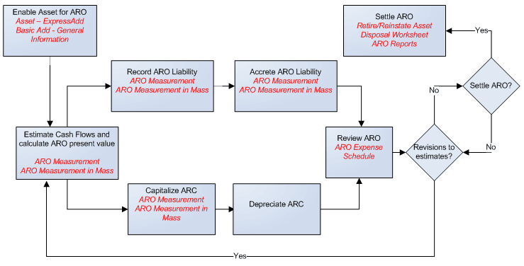

This diagram presents the Asset Retirement Obligation process flow within Asset Management:

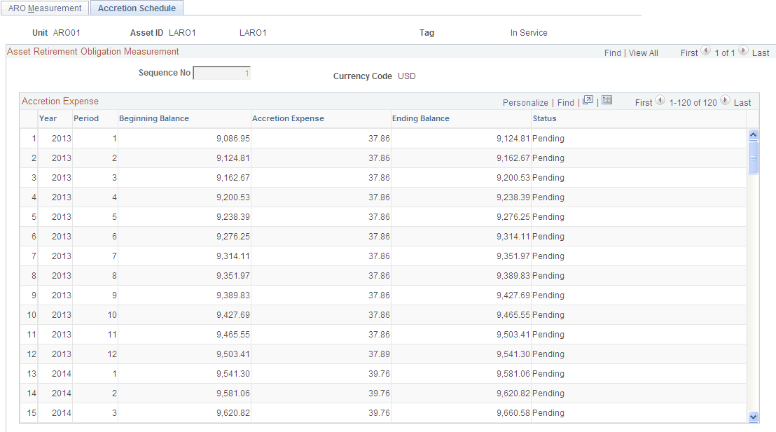

ARO_ACCR_SCHED |
Review the scheduled accretion expense as calculated by month over the life of the asset. |

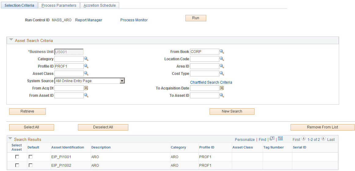

ARO_MASS_SEL |
Retrieve a list of eligible ARO-enabled assets for which to define ARO measurement information. |

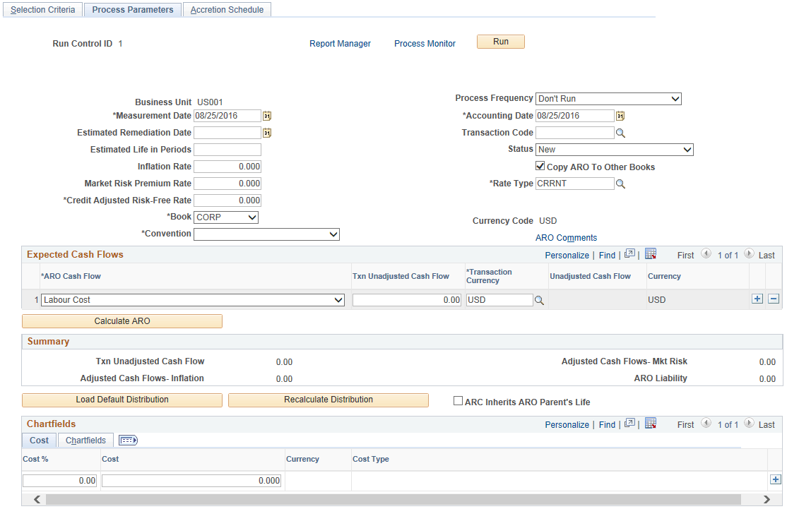

ARO_MASS_PAR |
Define ARO measurement parameters for multiple assets at once. |

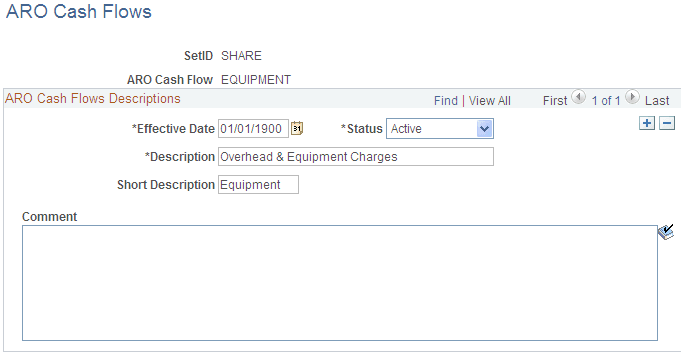

Use the ARO Cash Flows page (ARO_CFLOW_DEFN) to set up expected cash flow definitions to be used in the ARO measurement and describe the specific purpose for the ARO.
This example illustrates the fields and controls on the ARO Cash Flows Page. You can find definitions for the fields and controls later on this page.
Establish effective-dated ARO Cash Flow definitions by SetID to enable consistent data entry of estimated cash flow categories and descriptions.
Field or Control |
Description |
Status |
Select to make the ARO cash flow definition Active or Inactive. This is a required field. |
Description |
Enter a long description that is to be available for selection from ARO Measurement and ARO Measurement en Masse components. This is a required field. |
Short Description |
Enter a short description. If blank, this field adopts the truncated long description to fit this field. |
Comment |
Enter detailed information related to this definition. This field is optional and used for information purposes only. |

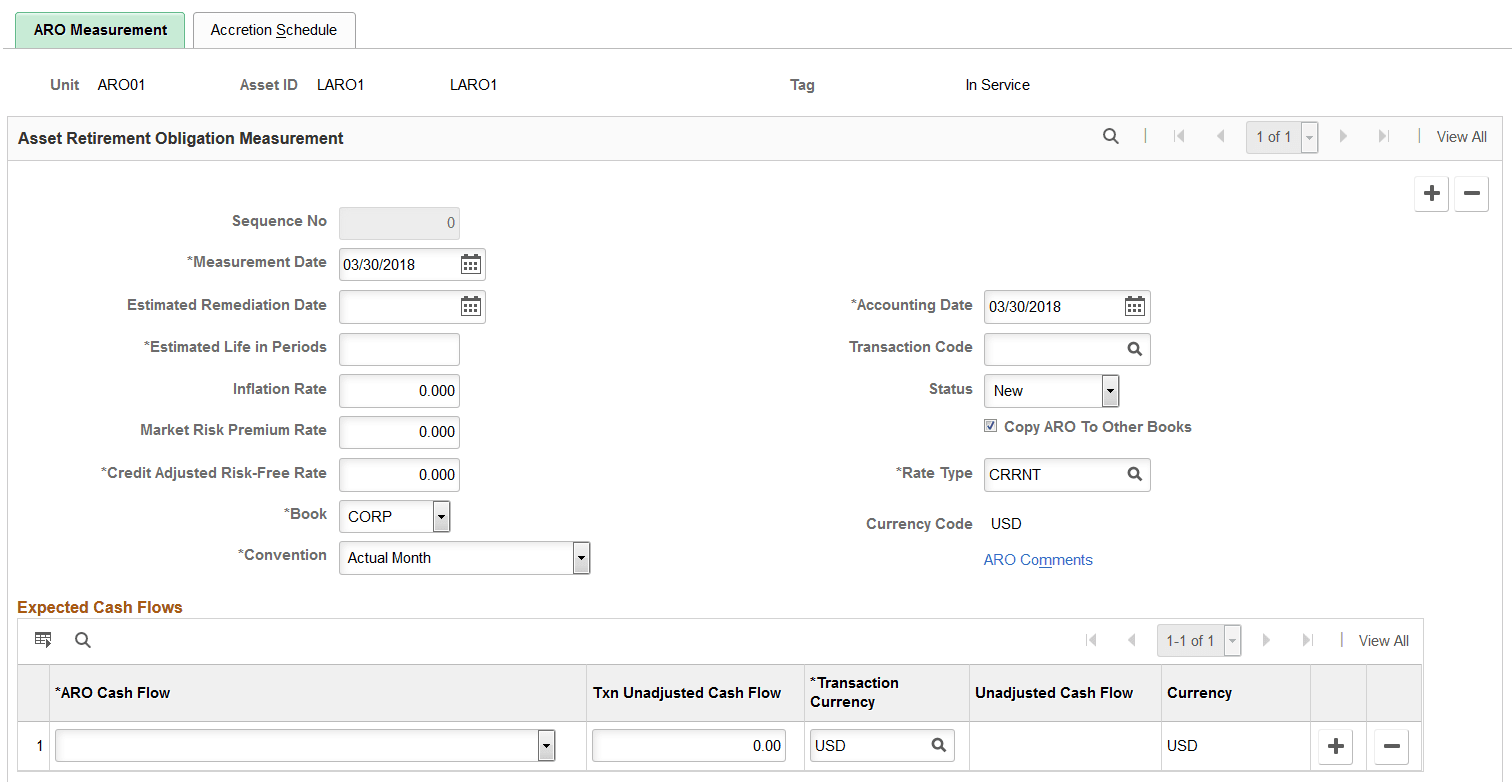

Use the ARO Measurement page (ARO_MEASUREMENT) to define the parameters to be used in the ARO calculations for an individual asset.
The ARO Measurement page displays slightly different characteristics depending on whether you are processing ARO using GAAP or IFRS.
Navigation:
This example illustrates the fields and controls on the ARO Measurement Page. You can find definitions for the fields and controls later on this page.
Asset Retirement Obligations can only be measured for assets that have a status other than Disposed or Transferred. You can search for assets that are eligible for asset retirement obligation treatment (see Enabling Assets for ARO Processing and establish the ARO measurement by asset.
Field or Control |
Description |
Sequence No (sequence number) |
Displays the ARO sequence number that is used to track incremental liability measurements, which are adjustments recorded in a period subsequent to the original measurement. The sequence number is generated upon saving the page. |
Adjusted Sequence Number |
Displays the ARO adjusted sequence number when you create an ARO adjustment. This field appears only when the selected business unit uses IFRS processing and you create a new ARO adjustment. |
Measurement Date |
Enter the date that the asset retirement obligation is initially recognized. This is the transaction date. The default value is the system date or the transaction date from the AM User Preferences page. |
Adjusted Measurement Date |
Displays the ARO adjusted measurement date when you create an ARO adjustment. This field appears only when the selected business unit uses IFRS processing and you create a new ARO adjustment. |
Estimated Remediation Date |
Enter an estimated remediation date for informational purposes only. |
Estimated Life in Periods |
Enter the period (months) to be used in calculating the ARO liability. |
Status |
Select a status for the ARO measurement. Values are:
The ARO measurement information can be updated for Adjustment, New, Error, or On Hold statuses. |
Inflation Rate |
Enter the percentage rate to be used to adjust expected cash flows for the ARO. |
Market-Risk Premium Rate |
Enter a market risk factor percentage to be used to adjust expected cash flows for the ARO. As this is usually difficult to assess, this field is not required. |
Credit-Adjusted Risk-Free Rate |
Enter the percentage to be used in calculating the accretion expense and the present value of the expected cash flows for the ARO. |
Book |
Displays the asset book information will be registered for only one Book since the measurement will be the same for all books. |
Convention |
Select the depreciation convention to be assigned to the resulting asset cost adjustment. The default value is the Actual Month convention. |
Accounting Date |
Enter the accounting date for the measurement of ARO. The default value is the system date or the accounting date from the AM User Preferences page. |
Transaction Code |
Select the value that identifies which accounting entry template to use for the transaction. This field is optional. |
Rate Type |
Enter the currency exchange rate type for the ARO if using multiple currencies. |
Copy ARO to Other Books |
Select this option to copy the asset retirement obligation to all other required books for the asset. If you selected the Keep All Books in Sync option at the business unit level, the system automatically selects this option. |
ARO Comments |
Click this link to access the ARO Comments modal page to optionally include additional information about assumptions used in estimating cash flows, for example. |

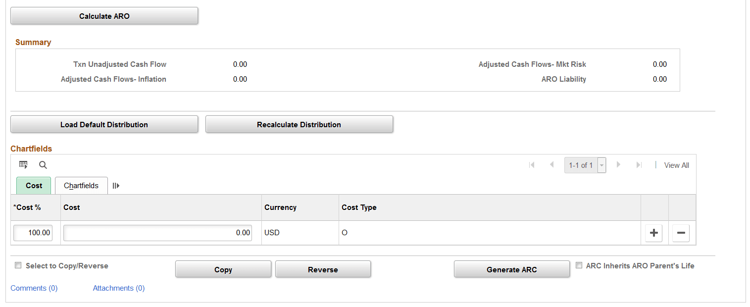

Calculate ARO |
Click this button to initiate the calculation of the ARO liability. |

Displays the sum of amounts entered in the Txn Unadjusted Cash Flow column. |
Adjusted Cash Flows - Inflation |
Displays the (sum of Txn Unadjusted Cash Flow) x ((1+Inflation rate) ^ estimated life)). |
Adjusted Cash Flows - Market Risk |
Displays the (sum of expected cash flows as adjusted for inflation) x (market risk premium). |
ARO Liability |
Displays the (sum of expected cash flows as adjusted for inflation) + (sum of expected cash flows as adjusted for market risk premium) x (1/(1+credit adjusted risk free rate) ^ estimated life). |
Load Default Distribution |
Click this button to load the default ChartFields for the accounting entries for ARO processing. |
Recalculate Distribution |
When making changes to the information, click this button to revise the distribution. |
ChartFields
Field or Control |
Description |
Select to Copy, Reverse, or Adjust |
Select this option to copy, reverse, or adjust the ARO measurement data. When you select this check box, click the corresponding button (Copy, Reverse, Adjustment). |
Copy |
Click to copy ARO measurements for another asset. |
Reverse |
For assets whose ARO measurement status is Processed, you can select the Copy or Reverse option and click this button to revert any measurements already processed. This action marks the row as reverted and it creates a new sequence number with a status of Reversed. The reversed row is the same as the original, display only, and creates a negative ARC request. |
Adjust |
Click to create a new ARO measurement row that you can use to input new measurement values. This button is available only when the selected business unit uses IFRS processing. |
Generate ARC |
Click to insert the information into the INTFC_FIN and INTFC_PHY_A tables, which is then processed by the Transaction Loader to create the ARO asset. When the process is run to generate the Asset Retirement Cost (ARC) entries, the ARC amount is capitalized and increases the carrying amount of the long-lived asset when the ARO liability for an asset is recognized. This process records the initial fair value (or estimated future cash flow) of the ARO liability. |
ARC Inherits ARO Parent’s Life |
Select this option for ARC to inherit ARO Parents life. When an Asset Retirement Cost (ARC) measurement asset is added to the original asset, the measurement asset will use the remaining life of the original asset. |
Click the Comments link to access the ARO Measurement - Comments page and view or add relevant supporting comments to an asset transaction.
Click the Attachments link to access the ARO Measurement - Attachments page and view or add relevant supporting documents to an asset transaction.

Use the Accretion Schedule page (ARO_ACCR_SCHED) to review the scheduled accretion expense as calculated by month over the life of the asset. (Asset Management, Asset Transactions, Asset Disposal, ARO Measurement, Accretion Schedule):
Navigation:
This example illustrates the fields and controls on the Accretion Schedule Page. You can find definitions for the fields and controls later on this page.
The Accretion Schedule page displays the scheduled accretion expense, by period, over the asset life using the parameters from the ARO Measurement page. This page also displays the beginning balance of the ARO liability, increased by the accretion expense for each period, the ending balance of the ARO liability, and the ARO status.
See Accreting the Asset Retirement Obligation.

Use the ARO Measurement en Masse – Selection Criteria page (ARO_MASS_SEL) to retrieve a list of eligible ARO- enabled assets for which to define ARO measurement information. (Asset Management, Asset Transactions, Asset Disposal, ARO Measurement en Masse, Selection Criteria):
Navigation:
This example illustrates the fields and controls on the ARO Measurement en Masse - Selection Criteria Page. You can find definitions for the fields and controls later on this page.
Asset Search Criteria
Enter your selection criteria to retrieve a list of ARO-enabled assets that are eligible for ARO accounting treatment and click the Retrieve button. Once you have selected the assets to process from the search results, defined the process parameters, and reviewed the accretion expense schedule, click the Run button to process the selected assets for ARO. The search criteria fields on this page are the same as those on the ARO Measurement page. See ARO Measurement Page.
Search Results
Field or Control |
Description |
Select Asset |
Select the assets that you want to include in the mass ARO process. You could also click the Select All button, the Deselect All button. |
Default |
Select this check box for the asset whose ChartField combinations are to be used as the default ChartField distribution on the Process Parameters page. |
Remove From List |
Select the Select Asset check box adjacent to the assets that you would like to remove from the search results grid for processing and click the Remove From List button. |
Use the ARO Measurement en Masse – Process Parameters page to define ARO measurement parameters for multiple assets at once.
Navigation:
This example illustrates the fields and controls on the ARO Measurement en Masse - Process Parameters Page. You can find definitions for the fields and controls later on this page.
After selecting the assets to be processed for ARO accounting treatment from the Selection Criteria page, you can set your process parameters on this page for processing those assets at once.
The fields on the Process Parameters page are the same as to those on the ARO Measurement page. The ARO Measurement page, however, is used for processing individual assets as opposed to processing a group set of assets.
When you have entered the process parameters on this page, click the Run button to process the selected assets. The AM_ARO_MASS Application Engine process then populates the tables that are defined in ARO Measurement component. You can review the output of this process from the inquiries and reports that are provided for meeting ARO reporting requirements. See Reviewing ARO Processing Results and Reporting for Asset Retirement Obligations.
