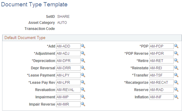

Use the Document Type Template page (AM_DOCTYPE_TMPL) to assign document types to each accounting entry type in Asset Management.
Navigation:
This example illustrates the fields and controls on the Document Type Template page. You can find definitions for the fields and controls later on this page.
Assign document types to be used by default by document sequencing for asset categories and asset transaction codes.
Note: If you are using revaluation, you need to define a template for the revaluation transaction code.
