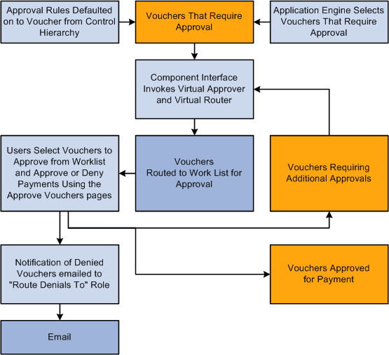

PeopleSoft Payables delivers a model (or example) of how you might set up your own voucher approval workflow using the PeopleSoft Virtual Approver. This model provides a starting point for your project team to understand and modify the approval process workflow to meet your needs.
Voucher approval process flow.

You should have the Voucher Approval Workflow process scheduled to run regularly. After you have saved a voucher, the Voucher Approval Workflow process determines the current approval status for the voucher by calling the Virtual Approver routine. The status of the voucher is updated based on what Virtual Approver concludes according to the approval rules defined in Workflow Administrator.
The Voucher Approval Workflow process uses PeopleSoft Component Interfaces then determines which users (if any) to notify, through workflow worklists or email forms, of the pending approval. Workflow routing is initiated by calling the Virtual Router routine that performs the needed action. You can access the Voucher Approval page from your worklists, manually inspect the voucher information, and either approve or reject a voucher for payment.
When you enter the Voucher Approval component, the voucher is typically presented in a pending status—payment has not been approved or denied.
Note: The Voucher Approval page displays vouchers whose approval status is Pending and whose match status is Matched.
In the Voucher Approval Workflow process, both worklists and emails are generated as follows:
If additional approvals are required, based on what the Virtual Approver concludes, the system generates appropriate worklists for the roles that are eligible to approve the voucher.
If a voucher is denied and is using Virtual Approver, the system sends an email with voucher details to the role you define on the Payables Options - Vouchering Options 1 page.
The person you define as the one to whom all rejection emails should be forwarded receives these voucher details. You can choose not to use email for rejections but to instead create an additional worklist to use for routing. An email was defined for rejections to provide examples of both worklists (approved vouchers are sent to a worklist) and emails (denials are sent by email).
If a voucher is denied and is using Approval Framework, the system sends notifications as defined in the Approval Transaction configuration. The voucher will be available for future updates and submitting for approval again.
If the voucher passes all approvals, its comprehensive approval status is set to Approved, and you can select it for payment.

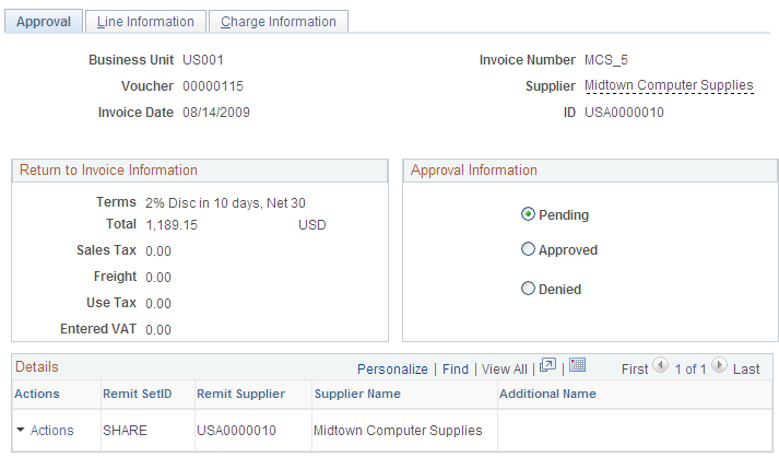

Use the Voucher Approval - Approval page (VCHR_APPRVL_WF) to approve vouchers.
Navigation:
This example illustrates the fields and controls on the Voucher Approval - Approval page. You can find definitions for the fields and controls later on this page.
You can use the Voucher Approval component as part of workflow, or you can use it to approve vouchers manually. Approval processing steps are the same, regardless of whether you arrived there through the worklist or by navigating through the menus manually.
To access the Remit Supplier Address page, click the View Related Links button on the Voucher Approval - Approval page.
To access the Voucher Approval - Line Information page, use the navigation:
To access the Voucher Approval - Charge Information page, use the navigation:
Approval Information
The Approval Information group box displays the current approval status of the voucher: Pending, Approved, or Denied.
Note: If you have the authority, you can deny or approve vouchers. Vouchers do not display on this page after you have approved and saved them. Also, if you do not have the authority to change voucher status, you can only route vouchers to an authorized approver.
Before you approve a voucher, you can also view voucher line and distribution line information on the Voucher Approval - Line Information page and the Voucher Approval - Charge Information page.

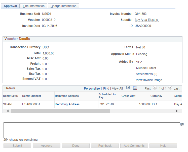

Use the Approval Framework - Vouchers – Approval page (VCHR_APPRVL_AF) to approve vouchers routed for your approval in the Approval Framework.
Navigation:
Worklist, Worklist. For the work item, Approval Routing, click the voucher link on the row.
This example illustrates the fields and controls on the Approval Framework - Vouchers – Approval page.
Field or Control |
Description |
View Invoice Image |
Click to open the scanned invoice image, which was used to create a voucher using a third party imaging solution. This link is available only if Document Content Management Interface is enabled on the Installation Options – Payables page. This link is enabled on this page only after the Voucher Build process runs successfully and creates a voucher. |
Use the Voucher Approval page to perform your approval tasks, including:
Approving vouchers that have been routed to you.
Deny vouchers that have been routed to you.
Pushback vouchers that have been routed to you.
Add comments to the approval routing.
Put a voucher on hold that have been routed to you.
Assign additional approvers.
View or add attachments to the voucher.

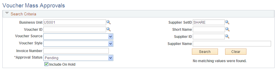

Use the Voucher Mass Approvals page (AP_MASS_APPROVE) to approving or denying multiple vouchers that have been routed to you for approval.
Navigation:
This example illustrates the fields and controls on the Voucher Mass Approvals page. You can find definitions for the fields and controls later on this page.
Field or Control |
Description |
Business Unit |
Enter the business unit to search for vouchers requiring your attention. You must enter at least the business unit. |
Voucher ID |
Click to access the Voucher Inquiry page and view information about this voucher. |
Approval History |
Click to view a graphical representation of the approval history. You can further drill down to view other approvers assigned to this routing. |
