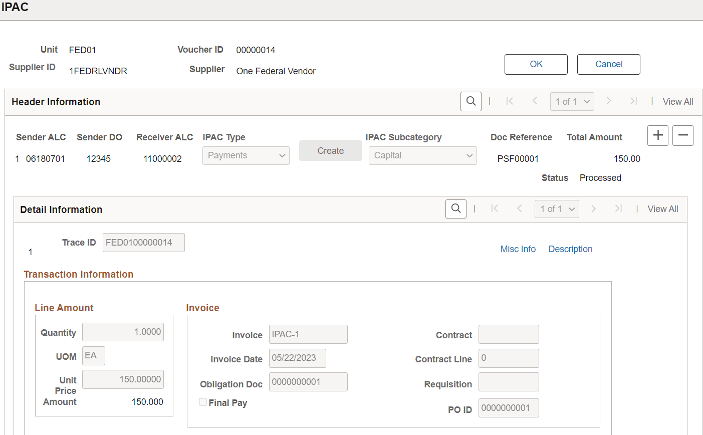

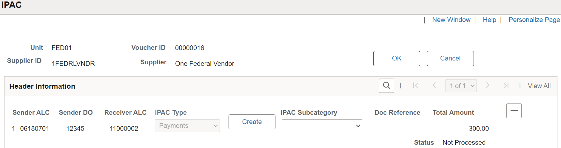

Use the IPAC page (AP_IPAC_SEC) to enter information required for outbound IPAC processing for a voucher.
Navigation:
Click the IPAC link on the Voucher - Payments page.
This example illustrates the fields and controls on the IPAC page
This example illustrates the fields and controls on the IPAC page after clicking create (1 of 2).
This example illustrates the fields and controls on the IPAC page after clicking create (2 of 2).
When you first enter this page, only the header information is displayed. After you select an IPAC type, and click the Create button, the rest of the page is displayed and some fields are populated. Next complete any required fields; this varies based on the selected IPAC transaction type.

Header Information
Field or Control |
Description |
Sender ALC (Sender Agency Location Code) |
Displays the ALC values entered on the Bank Information page. |
Sender DO (Sender Disbursement Office) |
Displays the sender DO value entered on the External Accounts page. |
Receiver ALC |
Displays the receiver's (supplier's) ALC by default from the supplier. You assign the ALC to the supplier on the Supplier Information - Federal page. |
IPAC Type |
The first IPAC header row must be a Payment transaction type with one exception, the first row can be an Adjustment transaction type if the voucher was built from the accounts receivables refund process. Select from: Payment for new transactions that you are sending to the IPAC system. Post SGL to add or change the SGL account information for previous transactions that you sent for collection. This value is available only if the original IPAC payment to which it refers has a status of Processed, which indicates that the payment has been processed by the Pay Cycle process and the Outbound IPAC file has been sent to the IPAC system. Zero for zero-dollar, information-only IPAC transactions. This value is available only if the original IPAC payment to which it refers has a status of Processed, which indicates that the payment has been processed by the Pay Cycle process and the Outbound IPAC file has been sent to the IPAC system. Adjustment for vouchers that originated from the accounts receivables refund process. Users are required to enter at least one debit credit pair of SGL information if you select this value. Only one adjustment transaction can be included per voucher. |
Create |
Select an IPAC type and then click to display the detail IPAC information. |
IPAC Subcategory |
Select the IPAC subcategory. The IPAC Subcategory field is displayed when you click the Create button. This is a required field for IPAC payments. The subcategory field is available only when IPAC Type is Payment. The available subcategory options are the following:
Doc Reference (document reference) |
This value is created during Pay Cycle using the ALC bulk pre-fix/counter defined during set up. The counter is incremented by one for each IPAC payment. |
Status |
Indicates the status of the IPAC voucher: Processed: IPAC vouchers have gone through the Payment Selection part of the Pay Cycle process and cannot be modified. Not Processed: IPAC vouchers have not gone through the Payment Selection part of the Pay Cycle process and can be modified. |
Detail Information
Each row in the Detail Information scroll area displays one invoice line—distribution line combination. With the exception of Final Pay, the rest are optional. Fields required for zero-dollar transactions are noted below.
Field or Control |
Description |
Trace ID |
Displays the business unit code followed by the voucher ID. This auto-populated value enables back-end systems to match transactions. |
Misc Info |
Click to access the IPAC Miscellaneous Description page, where you can enter related free-form text, accounting code information and a fiscal year ID. |
Description |
Click to access the IPAC Description page, where you can enter a free-form description of the IPAC transaction. |
Cross Reference Document |
Displays the document reference number of the original IPAC payment for zero-dollar transactions. |
Original Line # |
Displays the original line number of the original invoice line being adjusted for zero-dollar and adjustment transactions only. |
Contact Name and Phone |
Enter the name and phone number of a contact person at your agency. |

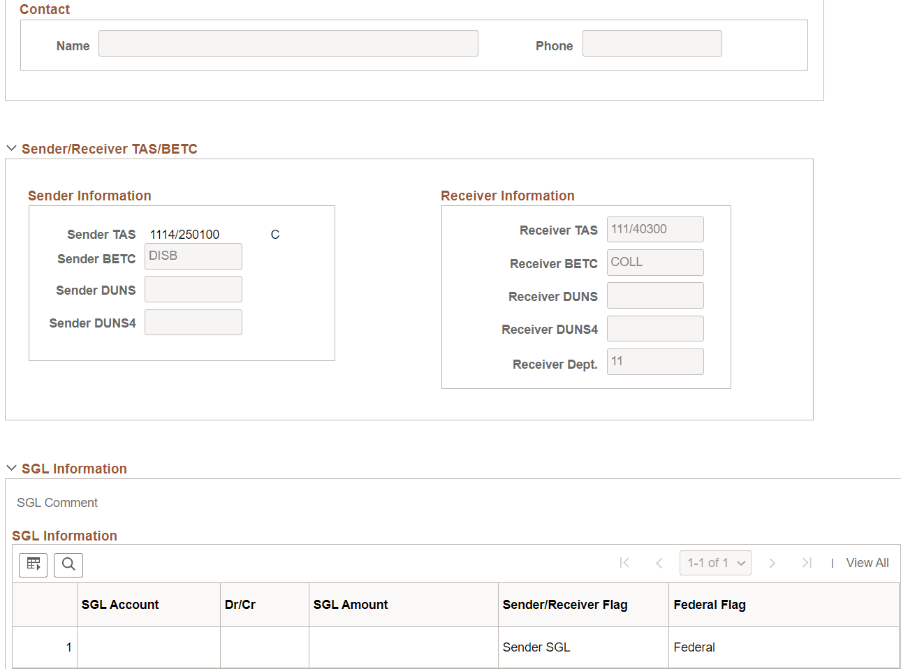

Transaction Information
Field or Control |
Description |
Obligation Doc |
Displays the purchase order identifier. The default is the same as the value that appears in the PO ID field. |
Final Pay |
Select to indicate that payment is final. Deselect to indicate a partial payment. Required for original payment. |
Contract and Contract Line |
Displays the contract ID and contract line item number copied from the voucher, if present. |
Requisition |
Enter the ID of the request for goods or services. This value is not copied from the voucher. |
Sender/Receiver TAS/BETC
Field or Control |
Description |
Sender TAS (Sender Treasury Account Symbol) |
Displays the Sender TAS based on the fund code entered on the distribution line. You associate Treasury Account Symbols with fund codes on the TAS/BETC setup component. Required for original payment. The Sender TAS automatically defaults based on the fund code at the distribution line level. |
Sender BETC (sender business event type code) and Recvr BETC (receiver business event type code) |
Sender and Receiver BETC values are optional if both the Sender or Receiver Agency are not GWA Reporters. If either the Sender and/or Receiver Agency are GWA Reporters, BETC is required. |
Receiver TAS (Receiver Treasury Account Symbol) |
Represents the appropriation of the agency receiving payment. Receiver TAS is required if the Receiver Agency is a GWA reporter. |
Sender DUNS (sender Dun and Bradstreet number) and Recvr DUNS (receiver Dun and Bradstreet number) |
Enter the Dun and Bradstreet number used to identify the sender (your agency) or the receiver (the customer's agency). |
Sender DUNS4 and Recvr DUNS4 (receiver DUNS4) |
Enter the four-character identifier that, along with the DUNS number, identifies individual business locations for federal suppliers and federal customers. |
Receiver Dept. |
Represents the two-digit code assigned by the U.S. Department of Treasury to the agency receiving the transaction. Required for original payment. |
Every IPAC Payment has both a sender and receiver ALC. If the Sender ALC is set up as a GWA Reporter, the TAS/BETC setup allows multiple combinations of SetID and Fund. If a GWA TAS is set up for the fund used on the distribution, the TAS is automatically defaulted. An error message is displayed if GWA TAS is not found for the SetID/Fund Code value. If the Receiver ALC is set up as a GWA reporter, the prompt lookup displays all GWA TAS values. For a Receiver ALC set up as a GWA reporter, Receiver TAS is required. An error message is displayed if a valid TAS/BETC value is not entered.
Receiver TAS is manually entered for the receiver agency. Each TAS has associated BETC codes set up to support GWA reporters. All BETC codes are retrieved for the specified TAS. BETC is required entry for GWA Reporters.
Note: BETC prompt lists cannot be created until the user has selected a TAS value.
If Sender ALC is not set up as a GWA Reporter, the TAS/BETC setup allows only one componentized String TAS to be defined to one unique SetID/Fund code value combination. If a GWA String is setup for the fund used on the distribution, the TAS is automatically defaulted. An error message is displayed if the String TAS value is not found for the SetID/Fund Code value. If the Receiver ALC is not set up as a GWA reporter, the prompt lookup displays all TAS values. Receiver TAS is optional entry for non-GWA Reporters. A prompt lists all BETC codes for the default TAS string value. BETC is an optional value for non-GWA reporters and no error message is displayed if values have not been setup for the TAS.
For more information, see Defining Component TAS and BETC Elements in Compliance with Federal Reporting Requirements
SGL Information
(Optional) Enter Standard General Ledger information. Bear the following in mind:
If you enter data in any SGL Information field, you must enter data in all of the fields.
SGL amounts must balance with the IPAC line amount, and you must have offsetting debit and credit entries.
You must enter SGL account information for Post SGL transaction types, and—optionally—you can enter SGL account information for collection. The SGL information fields are not available for zero-dollar transaction types.

Use the Pay Cycle Manager page to process the appropriate pay cycle.
Navigation:
The following processing is specific to outbound IPAC payments:
The Pay Cycle creates a file of outbound IPAC payments for submission to Treasury's IPAC system.
The Pay Cycle changes the status of all included IPAC vouchers to Processed on the IPAC page.
The Pay Cycle process rejects and creates an error for any vouchers whose payment method is EFT and EFT layout is IPAC and for which no data is entered on the IPAC page.
View errors on the Pay Cycle Error page. The Pay Cycle process does not process the payment until you enter the proper IPAC data.
The Pay Cycle processes zero-dollar and post SGL IPAC transactions (for non-monetary adjustments to original IPAC payment transactions).
