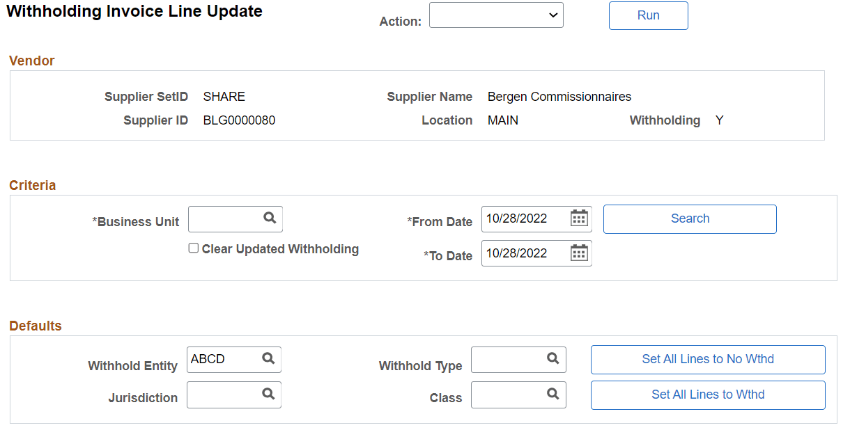

Use the Withholding Invoice Line Update page (WTHD_LINE_UPDT) to enter and store the updated voucher line withholding information which will be used to update the withholding transaction table and underlying voucher tables when you run the Withholding Update process.

This example illustrates the fields and controls on the Withholding Invoice Line Update page (1 of 2). You can find definitions for the fields and controls later on this page.

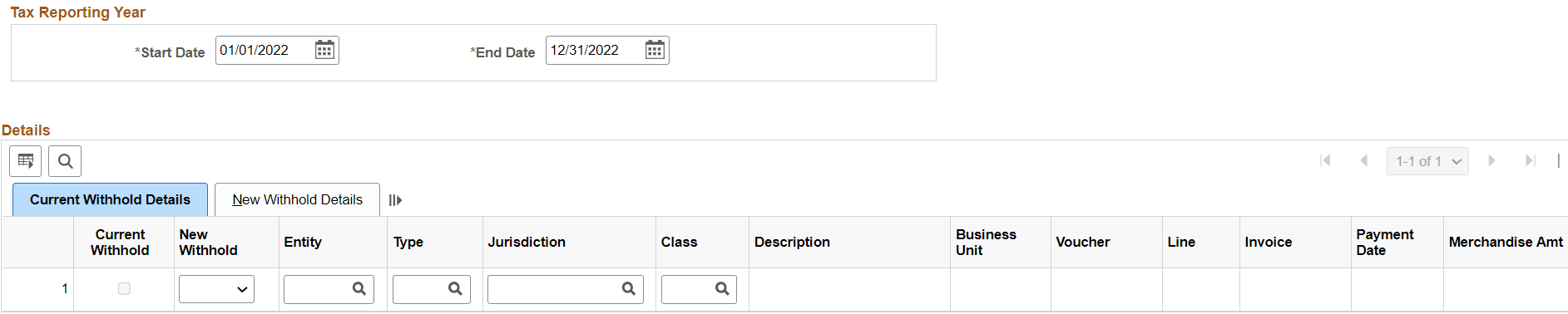

This example illustrates the fields and controls on the Withholding Invoice Line Update page (2 of 2). You can find definitions for the fields and controls later on this page.
Use the Criteria and Tax Reporting Year group boxes to enter the selection criteria for the vouchers you want to update. Click Search when you have entered all of your search criteria in these group boxes.
Use the Defaults group box to enter the withholding class combination you want to apply to your updated voucher lines.
Use the Details grid to view the voucher lines retrieved by your search and select voucher lines for updating.
Criteria
Enter a business unit and date range for the vouchers you want to update. These fields are required.

Clear Updated Withholding |
Select to delete all the previously updated voucher lines from the staging table upon save. This does not delete the voucher lines from the transaction table. It is for cleaning up previous update requests. |

Defaults
Specify any withholding entity, type, jurisdiction, and class you want to apply to all of your updated voucher lines. You can also override these for individual lines on the Details grid after you've applied them to all of the lines.

Set All Lines to Wthd (set all lines to withhold) |
Click to apply the withholding combination you enter here to all of the voucher lines in the Details grid. |
Set All Lines to No Wthd (set all lines to no withholding) |
Click to set all voucher lines in the Details grid to withholding not applicable. |
Tax Reporting Year
Enter the start and end dates of the tax year for which you are reporting withholding.
Details
The Details grid lists the voucher lines returned by your search. The Current Withhold Details tab displays the original withholding information for the selected voucher lines. You can update these by entering new values on each row. If you want to update all the voucher lines to the same new withholding combination, enter the withholding combination in the Defaults group box and click the Set All Lines to Wthd button.
The New Withhold Details tab shows the updated withholding details after you have saved the page.
The following are fields that appear on the Current Withhold Details tab:
Field or Control |
Description |
Current Withhold |
Displays selected to indicate that the voucher line is currently withholdable. |
New Withhold |
Select Y for withholding applicable or N for no withholding on the voucher line. Note: You must complete the remaining line information (Entity, Type, Jurisdiction, and Class fields), regardless of whether selecting Y or N. This ensures the system correctly processes the withholding data. |
Payment Date |
Displays the voucher payment date. Vouchers must be paid before you can update voucher lines. |
The following field appears on the New Withhold Details tab:
Field or Control |
Description |
Status |
Displays the update status: P (pending) means that an update occurs the next time you run the Withholding Update process. U (updated) means that the Withholding Update process has run and the transaction tables are updated. If this field is blank, the line is not selected for update. |

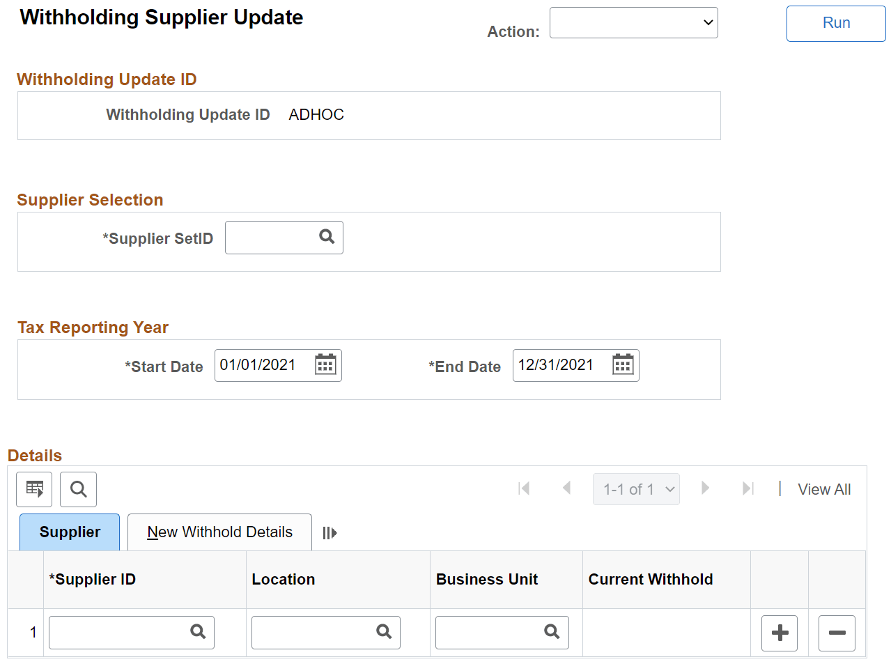

Use the Withholding Supplier Update page (WTHD_VNDR_UPDT) to enter and store updated withholding information for suppliers.
This information will be used to update the withholding transaction table and voucher tables with withholding information for all of the supplier's vouchers when you run the Withholding Update process.

This example illustrates the fields and controls on the Withholding Supplier Update page. You can find definitions for the fields and controls later on this page.
Enter a supplier SetID and tax reporting year before you enter information in the Details grid.
Warning! If you change the supplier SetID, the system deletes all the information in the grid. This is necessary to ensure that only suppliers for the specified SetID exist in the grid.
Details
You must select a supplier ID, supplier location, and business unit. The following fields also appear on the Supplier tab:

Current Withhold |
Displays the current withholding applicability of the supplier location: Y if the supplier location is currently withholding applicable. N if the supplier location is not withholding applicable. |
