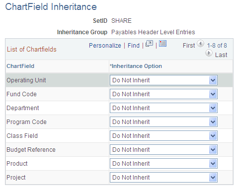

Use the ChartField Inheritance page(CF_INHERIT) to specify inheritance options for all non bank-related accounting entries, such as supplier liabilities, customer receivables, VAT, expenses, and so on.
Navigation:
This example illustrates the fields and controls on the ChartField Inheritance page. You can find definitions for the fields and controls later on this page.

Inheritance Group |
PeopleSoft Payables is delivered with three inheritance groups: Payables Header Level Entries: Defines the inheritance to use when generating entries for the vouchering PeopleSoft General Ledger business unit. The PeopleSoft Payables liability entry uses this inheritance group. Payables Distrib Level Entries (payables distribution level entries): Defines the inheritance to use when generating entries for the distribution line PeopleSoft General Ledger business unit. Allocated freight uses this inheritance group. Payables VAT Non-Recoverable: Defines the inheritance to use in generating nonrecoverable VAT entries. Note: To fully understand how these inheritance groups work, you must also understand how allocation and proration work in PeopleSoft Payables. |
Field or Control |
Description |
Inheritance Option |
Select an inheritance option for each ChartField within each of the three PeopleSoft Payables inheritance groups. Values are: Always Inherit: The ChartField value is always inherited from the distribution entries on the transaction, regardless of whether the ChartField value is in the same PeopleSoft General Ledger business unit. Select this value only if all business units share the same ChartField values; otherwise, the inherited value could be invalid. Do Not Inherit: The ChartField value is inherited from the accounting template for that distribution account type (DST_ACCT_TYPE), not from the transaction itself. Inherit Within Unit: The ChartField value is inherited from the distribution entries on the transaction, but only if the other entry is in the same PeopleSoft General Ledger business unit. Otherwise, the system uses the business unit default (of the nondistribution PeopleSoft General Ledger business unit). Use Unit Definition: The ChartField value is the default value that is associated with the PeopleSoft General Ledger business unit. Default values come from the values on the Inter/IntraUnit page in the General Ledger Definition component (BUS_UNIT_TBL_GL). |

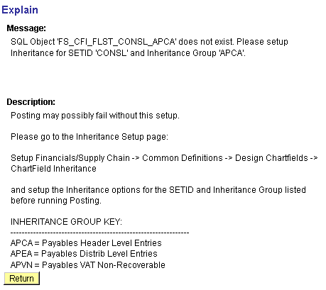

Use the Posting Setup Validation page (AP_VAL_INHRIT_RQST) to run the Validate Posting Setup Application Engine process (AP_VALCFINH) to verify that you have set up inheritance correctly and completely for PeopleSoft Payables.
Navigation:
Use this page to run the Validate Posting Setup Application Engine process (AP_VALCFINH), which verifies that you have set up your ChartField inheritance correctly. This process finds any set up issues that might cause problems for the PeopleSoft Payables Voucher and Payment Posting processes and posts them to the Process Message Log. Potential issues include:
Any SetID/AP inheritance group combinations in which ChartField inheritance has not been defined.
Any bank ChartField inheritance that has not been defined for banks with PeopleSoft Payables setup.
Any SetID/AP inheritance group that has been defined but has an invalid option.
Any procurement accounting controls for business units with invalid allocations.
To view the error messages:
Click the Process Monitor link on the Posting Setup Validation page.
Click the Details link on the Process List page.
Click the Message Log link on the Process Details page.
Click the Explain button on the Message Log page.
This diagram shows the posting setup issues on the Explain page (PMN_MSG_EXPLAIN).
