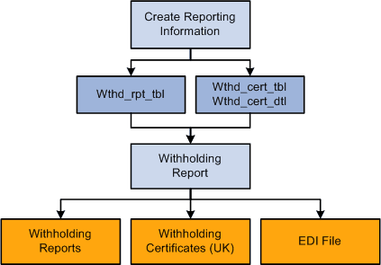

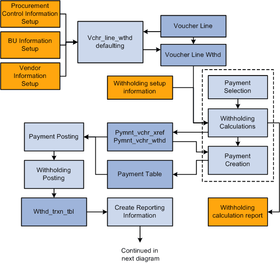

The following diagrams illustrate the general process flow for withholding in PeopleSoft (the withholding process for your location may differ slightly).
The following diagrams illustrate the general process flow for withholding in PeopleSoft (part 2).
