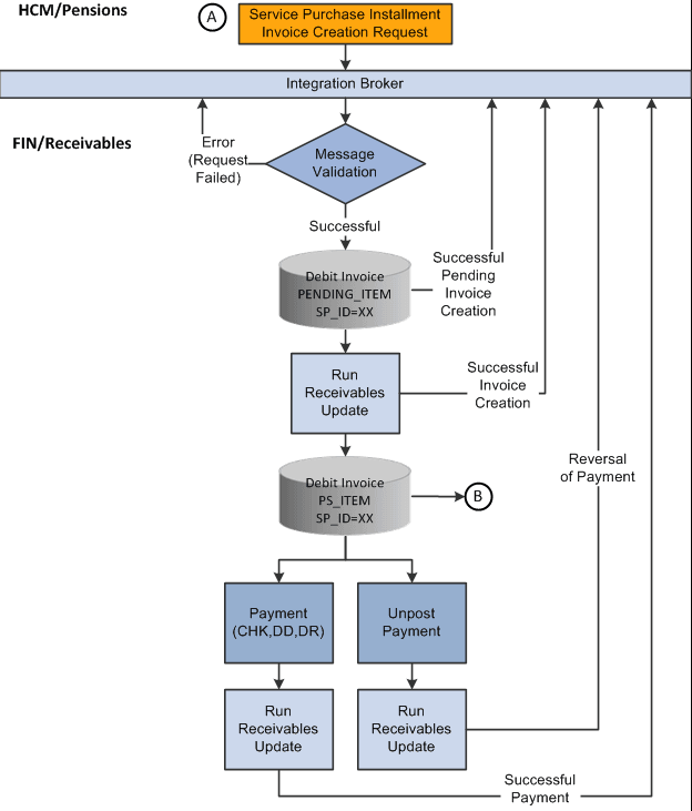

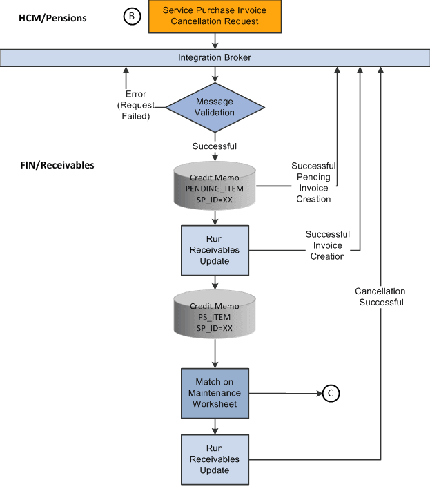

The following diagrams illustrate
Standard Service Purchase Invoice Creation Request (Step A)
Maintenance Worksheet cancellation of a Service Purchase transaction without refund of paid amount (Step B)
