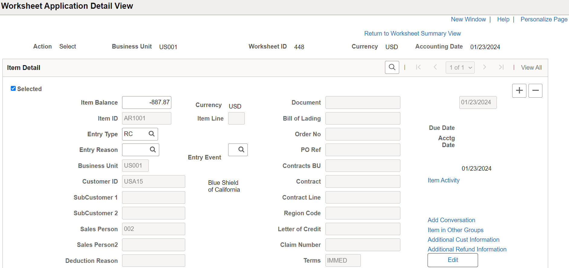

Maintenance Worksheet - Worksheet Application Detail View Page |
WS_WORKSHT_IC_DTL |
View or change details about a selected item on a worksheet. Write off a remaining balance for the worksheet. |

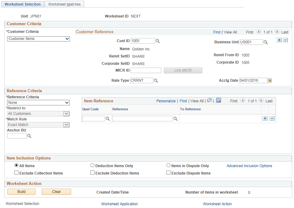

Use the Maintenance Worksheet - Worksheet Selection page (WS_IDENTIFY_IC) to create a new worksheet, or add and change items on an existing maintenance worksheet.
Navigation:
This example illustrates the fields and controls on the Maintenance Worksheet - Worksheet Selection page. You can find definitions for the fields and controls later on this page.
Customer Criteria
The Customer Reference fields and the Item Reference fields work together depending on how you choose the criteria. In the Customer Reference group box, you can select items based on Customer, and selection on the worksheet will be restricted to the specified Customer ID.
If you choose Customer Criteria = None, no items for the customer will be on the worksheet.
If you choose Customer Criteria = Customer Items, you only need to enter a Customer ID to build the worksheet with all items for the specified customer, regardless of business unit. If you enter a business unit, the selection is restricted to items with the Customer ID and Business Unit combination.
If you choose Customer Criteria = Corporate Items or Remit from Items, you must include a Business Unit as well as a Customer ID. The business unit will determine the SetID used in the Corporate or Remit customer part of the search. First, the selection will return all open items for the Customer ID and Business Unit specified. Second, the selection will also return any open items for all customers that are Corporate or Remit customers of the specified Customer ID and SetID combination (remember, SetID is determined by the specified Business Unit).
Note: None of the items built onto the Worksheet from Customer Reference criteria will be automatically selected on the worksheet.
For example scenarios using multiple selection criteria, see Working with Multiple Selection Criteria on the Worksheet.

Customer Criteria |
Select the type of customer that you want to include in the worksheet. Values are: Corporate Items, Customer Items, Remit From Items, and None. If you select None, the system creates a worksheet based on your other selection criteria and does not limit items to specific customers. In addition, if you select None, the Customer Reference fields are not available. |
Cust ID (customer ID) and Business Unit |
Enter a customer ID and business unit. Note: If you select Corporate Items or Remit From Items in Customer Criteria, you must enter a business unit. The system needs a business unit to determine the SetID of corporate and remit from customers. The resulting worksheet displays all open items that have the specified corporate or remit from customer for the selected business unit. |
Rate Type |
Required if you are working with multiple currencies. The default value for the rate type comes from the value that you defined for the business unit on the Receivables Options - Payment Options page. Warning! If you do not enter a rate type and you select multicurrency items, the system returns you to the Worksheet Selection page, and you must start from the beginning. None of your work on the worksheet will be saved. To avoid accidentally losing your work, enter a rate type on the Receivables Options - Payment Options page so that you always have a default value on the Worksheet Application page. |
MICR ID (magnetic ink character recognition ID) |
(Optional) Enter the customer's MICR ID. |
Link MICR |
Link the customer's MICR ID to other customers who have the same MICR ID. |
Accounting Date |
For new worksheets, select the accounting date that you want to apply to all items that you select on the worksheet. For existing worksheets, you can change the accounting date only if no items have been selected on the worksheet. If you have selected items, click the Clear button to clear the selections. Then change the accounting date. |
Reference Criteria
The Item Reference grid is used to add and select items not found by the Customer Reference criteria onto the worksheet. Or, if the item is already found using the Customer Reference criteria, it will be automatically selected on the worksheet.
If you choose Reference Criteria = Specific Value or Range of References, the Restrict to field becomes active. You can restrict the Item search to the following selections:
Customer Only – Selects items matching the Item Reference values for only the customer(s) specified in the Customer Reference fields.
All Customers – Ignores any specified customer(s). The worksheet is built from items matching the Item Reference values, for all customers regardless of customers listed in the Customer Reference fields.
Corporate Cust Only - Selects items matching the Item Reference values for only the Customers listed in the Customer Reference fields and all Corporate Customers associated with those Customers by business unit.
Remit Cust Only - Selects items matching the Item Reference values for only the Customers listed in the Customer Reference fields and all Remit Customers associated with those Customers by business unit.
Note: The only instance in which you can use reference criteria independently of customer criteria is when the Restrict to field is All Customers
Field or Control |
Description |
Reference Criteria |
Select a value that indicates how you will identify the items for the worksheet. Values are Specific Value, None, and a Range of References. If you select either Range of References or Specific Value, you work with the other two Item Reference fields. |
Restrict To |
Select a value to qualify items by customer. Values are All Customers, Corporate Cust Only, Customer Only, and Remit Cust Only. |
Match Rule |
If you selected Specific Value in the Reference Criteria field, specify whether the item information is an exact match or a like match. A like match enables you to use a percent (%) wildcard to identify the reference, as long as you provide the beginning letters or numbers. For example, if you enter a purchase order (PO) number of 24% and select Like Match, the worksheet will contain all items having PO numbers beginning with 24xx, but will not catch a PO number of x24x. |
Anchor Business Unit |
Select a business unit. The system uses the currency for the business unit as the anchor currency for conversion when items on the worksheet are in different currencies. The system also uses the maintenance control code (AR distribution code) that you assigned to this business unit to create offsetting accounting entries. The system uses this business unit when you perform an automatic write-off of a remaining balance. If items are selected on the worksheet, you cannot change an anchor business unit. To change an anchor business unit, click the Clear button to clear the selections. |
Currency |
Enter the control currency for the worksheet. This field appears only if you enter reference values. |
Reference and To Reference |
If you selected Specific Value in the Reference Criteria field, enter the specific item reference. If you selected Range of References, enter the starting and ending values for the range of references. |
Reference Qualifier Code |
Select the type of reference, such as document, item, purchase order, or any other criteria that you set up on the Reference Qualifier page. Note: You must enter a qualifier code before you enter a reference number if you do not have a default value assigned to the business unit. |
Item Inclusion Options
Field or Control |
Description |
All Items, Deduction Items Only, or Items in Dispute Only |
Select one of these options to indicate the type of items to include in the worksheet. |
Exclude Deduction Items, Exclude Collection Items, and Exclude Dispute Items |
If you select All Items, you can also select one or more of the check boxes to exclude collection, deduction, and dispute items. |
Advanced Inclusion Options |
Click this link to access the Filter Items secondary page (WS_ITEMSRCH_SEC), where you can create, edit, and save selection criteria for items to include in the worksheet. You can filter items using values in the following categories:
Worksheet Action
Field or Control |
Description |
Build |
Click to create a new worksheet or to add items that meet your selection criteria to an existing worksheet. |
Clear |
Click to remove all items from an existing worksheet. |

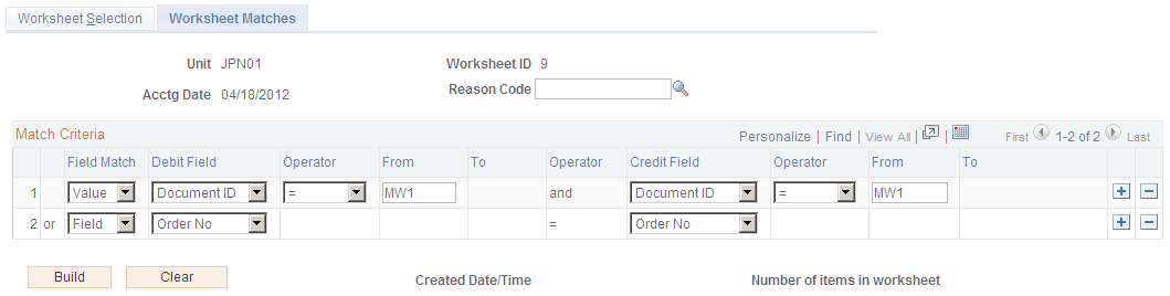

Use the Maintenance Worksheet - Worksheet Matches page (WS_WORKSHEET_MTCHS) to specify matching criteria to create match groups in the worksheet and build the worksheet.
Navigation:
This example illustrates the fields and controls on the Maintenance Worksheet - Worksheet Matches page. You can find definitions for the fields and controls later on this page.
You specify the criteria for matching debit items to credit items in the Match Criteria group box. When you build the worksheet, the system displays groups of matching debit and credit items on the Worksheet Group View page.
Field or Control |
Description |
Field Match |
Select an option for matching the field values. Options are: Field: Select to match any value in a specific debit item field to the exact same value in a specific credit item field. When you select this option, only the Debit Field and Credit Field are available. Value: Select to match a specific or partial value in a specific debit field to a specific or partial value in a specific credit field. |
Debit Field and Credit Field |
Select the matching criteria for debits in the debit fields and the matching criteria for credit items in the credit fields. For each line, select the field on the Item table (PS_ITEM) that you want to match. Values are Bill of Lading, Broker ID, Carrier ID, Claim Number, Class of Trade, Contract, Division, Document ID, Entry Reason, Family, Invoice, Item ID, Major Classification, Order No, Proof of Delivery, Purchase Order Ref, Sales Person, and Sales Person 2. |
Operator |
Select the operator for each field match: = (equal): Matches the exact value that you enter in the From field. BTW (in between): Matches a range of values that you enter in the From and To fields. For example, if you enter C to DZ, it matches all values that begin with C to DZ. LIKE (like comparison): Includes references that begin or end with the same characters or numbers by entering a partial value and the percent (%) wildcard in the From field. For example, if you enter a PO number of 24%, it matches items that have PO numbers beginning with 24xx, but won't match a PO number of x24x. Note: The To field is available only if you selected BTW for the operator. If you selected LIKE, you must enter a percent wildcard in the From field. |
The system creates one match group that contains all of the items that meet your matching criteria for each line. For example, enter the following matching criteria:

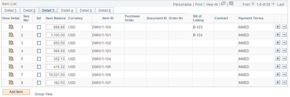

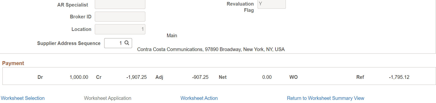

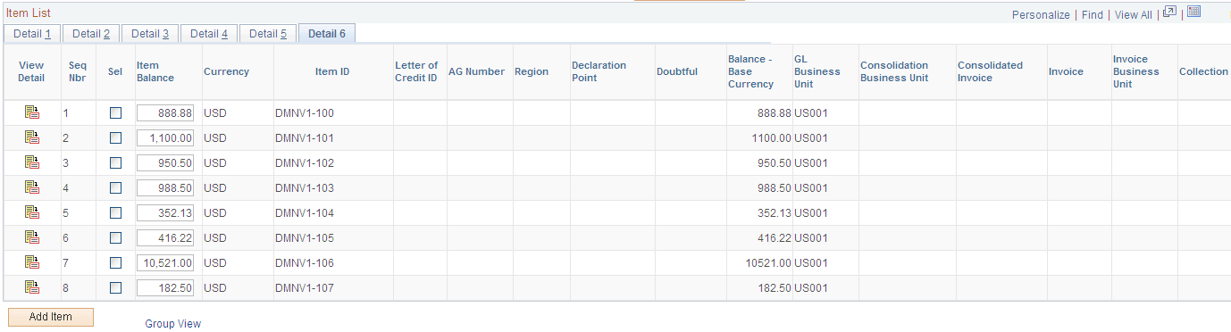

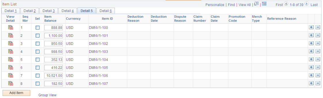

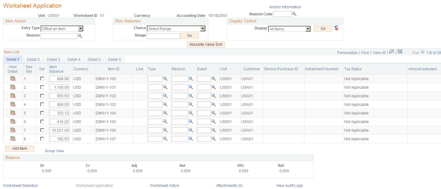

Use the Maintenance Worksheet - Worksheet Application page (WS_WORKSHEET_IC) to offset individual debits and credits, write off items, create new items, or refund items.
Navigation:
Click the Normal View link on the Worksheet Group View page.
This example illustrates the fields and controls on the Maintenance Worksheet - Worksheet Application page (Detail 1 tab).
This example illustrates the fields and controls on the Maintenance Worksheet - Worksheet Application page (Detail 2 tab).
This example illustrates the fields and controls on the Maintenance Worksheet - Worksheet Application page (Detail 3 tab).
This example illustrates the fields and controls on the Maintenance Worksheet - Worksheet Application page (Detail 4 tab).
This example illustrates the fields and controls on the Maintenance Worksheet - Worksheet Application page (Detail 5 tab).
This example illustrates the fields and controls on the Maintenance Worksheet - Worksheet Application page (Detail 6 tab).
The page appears in normal view if you did not enter any matching criteria on the Worksheet Matches page or if the matching criteria did not generate any match groups.
Field or Control |
Description |
Anchor Information |
Click this link to access the Anchor Information page (AR_WS_ANCHOR_SEC), where you select an anchor business unit and anchor currency for multicurrency processing. Select a control distribution code for accounting entries. If an item is selected on the worksheet, then you are unable to change or select any of these fields. |
Absolute Value Sort |
Click to sort the worksheet by the absolute value of the item balance, in descending order. The default order displayed in the worksheet is by Item ID. To resort by Item ID after sorting by absolute value, you must rebuild the worksheet. Note: The system will sort by absolute value of the item balance only on grids that have not been personalized. |
Working with Item Selection Controls
The item selection controls enable you to work with all items in the worksheet at once or a specified range of items.
Field or Control |
Description |
Entry Type and Reason |
Select the entry type for the activity that you want to perform for the selected items. You must enter a valid entry reason in the Reason field if you selected the Require Reason check box for the entry type on either the Item Entry Type - Selection page or the Automatic Entry Type - Selection page. Valid entry types are: Offset an Item: Select to offset all of the selected items. Refund a Credit: Select to refund selected credit items. If you also have debit items selected, the system ignores them. Write off a Debit: Select to write off selected debit items. If you also have credit items selected, the system ignores them. The system issues a message if you try to write off more than the write-off tolerances permit. If approval framework is activated, then the system requires the approval of write-off amounts entered on the worksheet that are below the write-off tolerances but above the approval-needed limit. Write off a Credit: Select to write off selected credit items. If you also have debit items selected, the system ignores them. The system issues a message if you try to write off more than the write-off tolerances permit. If you receive a warning message that the write-off exceeds the tolerances, you can bypass the message, as long as you are enabled to override tolerances in user preferences and the write-off meets your tolerance requirements. If approval framework is activated, then the system requires the approval of write-off amounts entered and saved on the worksheet that are above the approval-needed limit. Note: If you select an item that is selected in another worksheet, and you selected the No Mult Pending Item Selection field on the Installation Options - Receivables page, the system does not select the item in the grid. To determine whether the item is selected in another group, click the Items in Other Groups link on the Detail View page for the item. The system also does not automatically select an item that you added to the worksheet by clicking the Add Item button if that item is selected in another worksheet. Important! The system allows you to select Write off a Debit or Write off a Credit if the business unit for both items being matched requires VAT (value added tax) only if VAT applicability is set to Exempt or Out of Scope. |
Choice and Range |
Select an option to select or deselect multiple items at a time. Values are Select All, De-Select All, Select Range, De-Select Range. If you select Select Range or De-Select Range, enter the range in the Range field. For example, enter 4-7. |

Using Item Display Controls
Field or Control |
Description |
Display |
Specify which items to display in the grid, such as All Items, Unselected Items, or Selected Items. |
Go |
Click to refresh the item list and balances. |
Click the Currency Conversion Panel icon to access the Currency Conversion page (EU_CUR_CNV_WS_SEC), where you select a display currency for the Conversion Amount - Currency column and specify whether to use today's date, the accounting date for the item, or a date that you specify to determine which exchange rate to use. |
Sort All |
Use the Sort All field to sort all items in the worksheet, not just the items that are displayed in the scroll area. This field is not available if the number of rows does not exceed the maximum chunk size. Select Match to place matching credits and debits together. The worksheet matches the items by comparing the item ID and line number with the document and document line number. Select Items to sort the worksheet in the order that you entered the items on the Worksheet Selection page. Then click Go to resort all items in the worksheet. The page displays the selected rows that currently appear in the list. Click the arrows to view different chunks of data. For better performance, you can limit the number of rows that appear in the scroll area on the Installation Options - Receivables page. Oracle recommends a maximum chunk size of 100 rows, although larger chunks may perform satisfactorily. These fields and buttons are not available if the number of rows does not exceed the maximum chunk size. |
Working with Item Summary Information
Use the Customize link to sort by column and reorder, hide, and freeze columns. This enables you to put the key fields that you want to review on the Detail 1 tab and sort your data.
See the section on using grid and scroll area controls in the the product documentation for PeopleTools: Applications User's Guide.
Field or Control |
Description |
Click the View Detail icon to access the Worksheet Application Detail View page, where you view and update details for an item. Note: If you selected the option to view all items in the grid, the Detail View page displays information about all items in the grid and the page takes longer to open. |
Seq Nbr (sequence number) |
This number relates to the order in which the items were entered on the Worksheet Selection page. Initially the items appear in this order. If you sort the worksheet based on the value in another column or by using the Sort All field, the number stays with the item, but the grid order changes. Use this column to resort the worksheet in the original order. |
Item Balance |
Displays the amount of the item on which you are taking action. Change the amount if you do not want to take action on the full amount of the item. For new items that you create, add the amount for the item. |
Item ID and Line |
If you added a new item to the worksheet to balance the worksheet, enter the item ID and line number. If you need to add additional information for the item, use the Worksheet Application Detail View page. |
Type and Reason |
Select the entry type and reason for the activity. If you are working with an existing item, select one of these entry types: MT (Offset an Item): Select to match the item. Note: If you are offsetting a vendor rebate claim or claimback item derived from PeopleSoft Purchasing or PeopleSoft Order Management and the item's business unit is associated with a VAT entity, you create two items, one with the base amount of the item in the Item Balance field and one with the VAT amount for the item in the Item Balance field. Use the MT (Offset an Item) entry type for each item. Use the CRBSE entry reason for the row with the base amount and CRVAT entry reason for the row with the VAT amount. You also must enter the reference number for the claim item in the Document field on the Worksheet Application Detail View page. RC (Refund a Credit): Select to refund a credit item. WO (Write-off a Debit): Select to write off a debit item. WOC (Write-off a Credit): Select to write off a credit item. If you are working with a new item in the worksheet that you created by adding a new row to the worksheet, select one of these entry types: MC (Create New Credit): Select to create a new credit memo and add the amount to the adjustment total. The amount in the balance field must be negative. MD (Create New Debit): Select to create a new debit memo and add the amount to the adjustment total. The amount in the balance field must be positive. RRC (Refund Remaining Credit): Select to refund the remaining balance for the worksheet in the Net field. WRC (Write-off Remaining Credit): Select to write off the remaining credit balance for the worksheet in the Net field. The system creates a credit (MT-05) and adds the amount to the adjustment total. It also creates a credit write-off (MT-06) and adds that amount to the write-off total. WRD (Write-off Remaining Debit): Select to write off the remaining debit balance for the worksheet in the Net field. The system creates a debit memo (MT-04) and adds the amount to the adjustment total. It also creates a debit write-off (MT-07) and adds that amount to the write-off total. Note: If you receive a warning message that the write-off exceeds the tolerances, you can bypass the message, as long as you are enabled to override tolerances in user preferences and the write-off meets your tolerance requirements. If approval framework is activated, then the system requires the approval of write-off amounts entered and saved on the worksheet that are above the approval-needed limit. Important! The system allows you to select Write off a Debit or Write off a Credit if the business unit for both items being matched requires VAT only if VAT applicability is set to Exempt or Out of Scope. |
Add Item |
Click to add an existing item that is not already in the worksheet. When you add an item, enter the business unit, customer ID, and item ID. The system selects the item and assigns an MT offset entry type. If you are using line items, all line items for the item are selected. If you attempt to add an invalid item ID or any open item that does not meet the current editing criteria, it will not be added to the worksheet. Note: To add all of another customer's open items as opposed to a single item, access the Worksheet Selection page, where you can add a customer ID and rebuild the worksheet. |
Group View |
Click to access the Worksheet Group View page, where you match items in match groups. |
Write Off Remaining Amount |
Click to write off the remaining balance for the worksheet. The link is available only if a balance is in the Net field. The system creates two new pending items—the new debit or credit and the write-off—and assigns an item ID to each item. Override the item ID if you want to assign your own number. If the net amount is greater than zero, the system creates a debit memo (MT-04) and adds the amount to the adjustment total. It also creates a debit write-off (MT-07) and adds that amount to the write-off total. If the net is less than zero, the system creates a credit (MT-05) and adds the amount to the adjustment total. It also creates a credit write-off (MT-06) and adds that amount to the write-off total. |
Revenue Distribution |
Click to distribute revenue amounts for control budgets when an item has multiple revenue lines and you are only partially taking action on it. This link is available only if you enabled commitment control processing and if you enabled the entry of multiple revenue lines for the business unit. |
Item Entry Type |
Displays the original entry type of the item when the worksheet is built. |
Balance
The system updates the balance information when you click Go or Refresh, or you save the worksheet. You must have a zero balance before you can post the worksheet.
Field or Control |
Description |
Dr (debit) |
Displays the total of positive amounts. |
Cr (credit) |
Displays the total of negative amounts. |
Adj (adjustment) |
Displays the amount of new debit and credit pending items that you created. |
Net |
Displays the remaining or unmatched amount for selected items (debits – credits + adjustments). |
WO (write-off) |
Displays the total of both item and remainder write-offs. |
Ref (refund) |
Displays the total of refunded items. |

The page opens in group view if you entered matching criteria on the Worksheet Matches page and your criteria generated match groups.
Each match group contains the items that matched based on your matching criteria. Match group number 99999 contains all items that did not match any other items. The group balance for each match group must be zero before you can post the worksheet. Also, the net amount for the worksheet must be zero.

Use the Worksheet Application Detail View page (WS_WORKSHT_IC_DTL) to view or change details about a selected item on a worksheet. Write off a remaining balance for the worksheet.
Navigation:
Click the View Detail icon on the Worksheet Application page or the Worksheet Group View page.
This example illustrates the fields and controls on the Maintenance Worksheet - Worksheet Application Detail View page (1 of 2). You can find definitions for the fields and controls later on this page.
This example illustrates the fields and controls on the Maintenance Worksheet - Worksheet Application Detail View page (2 of 2). You can find definitions for the fields and controls later on this page.
Field or Control |
Description |
Item Balance |
To partially take action on an item, change the amount and click Edit to update the worksheet balance information. |
Entry Type and Entry Reason |
Select the entry type and reason for the activity. |
Location |
Enter the address sequence number for new items. You must enter a value in this field to include the item in correspondence if you selected the Item Address option for the correspondence customer on the Correspondence Options page. |
Supplier Address Sequence |
Displays the default remit to address from the supplier location in Payables. You can accept or override the default value. A prompt view provides a list of valid values for the supplier, from which you can choose. The valid address sequence numbers are specific to each supplier ID. The Supplier Address Sequence field is available when you use one of these actions: Refund a Credit (MT-09) or Refund Remaining Credit (MT-08). The selected Supplier Address Sequence is added to the item details and the refund process passes the value to Payables. |
Document |
If you are applying the payment to a vendor rebate claim item or claimback item that is derived from PeopleSoft Purchasing or PeopleSoft Order Management, you must enter a reference ID. When you run the Rebate Notification process, it sends the reference ID to PeopleSoft Purchasing and PeopleSoft Order Management to use to reconcile the claims on the claims management workbench. This field is available for existing items only if you enter entry reasons on the AR Integration page. |

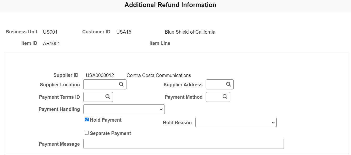

Additional Refund Information Page
Click Additional Refund Information link to update additional refund information. Additional Refund Information link is available only if Entry Type is RC (Refund a Credit) or RRC (Refund Remaining Credit). Similarly, the link is not available for single payment suppliers.
Fields or controls and descriptions for Additional Refund Information page.
Hold Payment check box is not available if Payment Method is Manual (Manual Check). An error message is displayed if any of these payment methods EFT, ACH, BEF or GE are selected, and a bank account is not set up for the supplier.
To view the additional refund information after the Maintenance group is posted, you can use the Posting Results components. The Additional Refund Information link is available on the Pending Item 1 tab for Maintenance groups with refund transactions only. For additional information, see Reviewing Posting Results.
