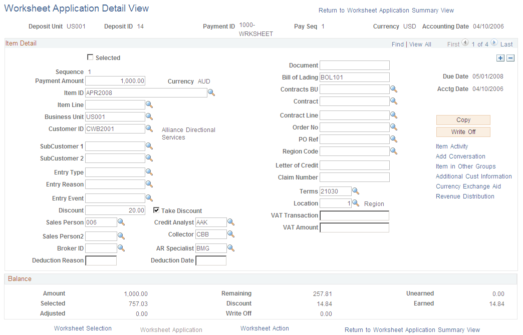

Worksheet Application Detail View Page |
PAYMENT_WS_IC_DTL |
Click the View Detail button on the Worksheet Application page to view or update details about a selected item on a worksheet or copy, write off, or edit items. |

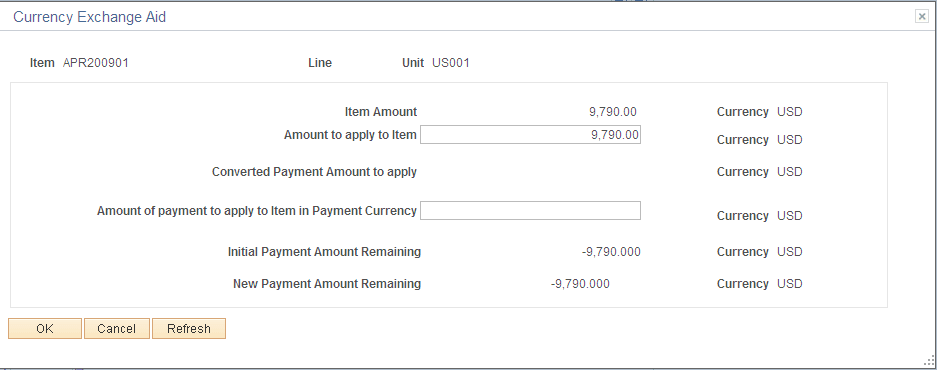

Currency Exchange Aid Page |
CURR_EXCHG_AID_SEC |
Click the Currency Exchange Aid link on the Worksheet Application Detail View page to use as an aid in converting the payment amount to the currency of a selected item making a partial payment. |

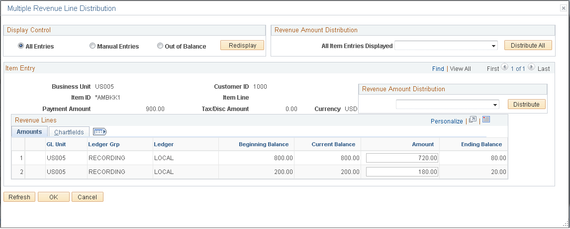

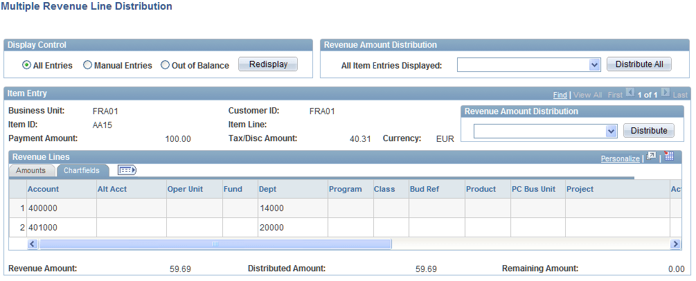

Multiple Revenue Line Distribution Page |
AR_MRL_SEC |
Click the Revenue Distribution link on the Worksheet Application page to distribute amounts for multiple revenue lines for control budgets. |

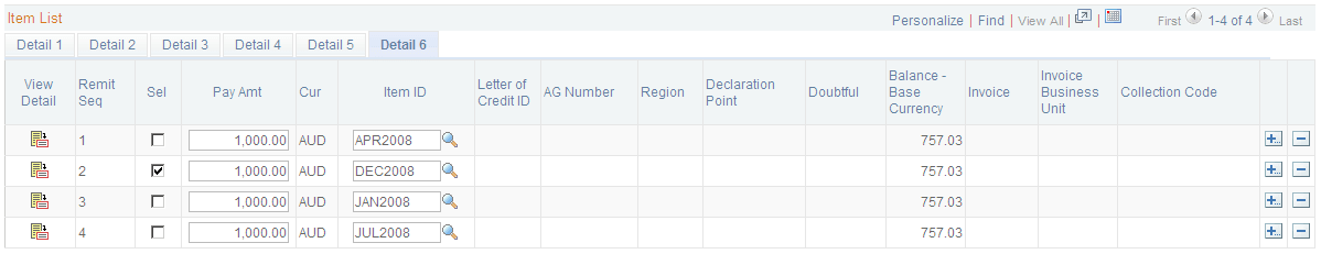

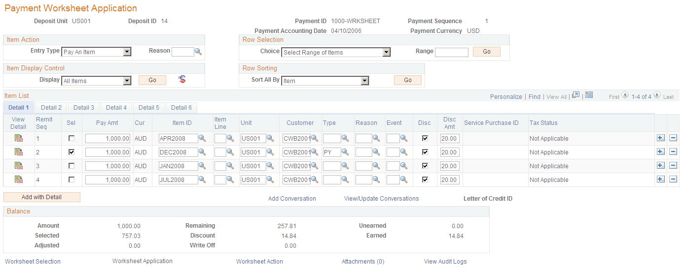

Use the Worksheet Application page to apply the payment to items.

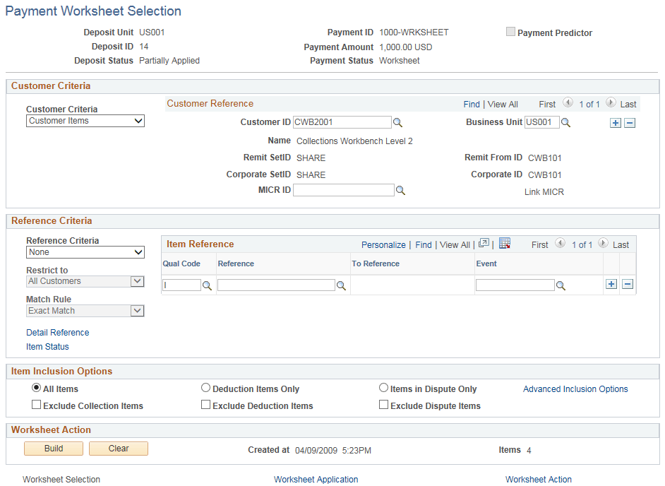

Use the Payment Worksheet Selection page (PAYMENT_IDENT_IC) to create a new worksheet, modify an existing one, and select items to include in the worksheet.
Navigation:
This example illustrates the fields and controls on the Payment Worksheet Selection page. You can find definitions for the fields and controls later on this page.
Field or Control |
Description |
Payment Predictor |
Select to apply the payment automatically the next time that you run the Payment Predictor process. If you select Payment Predictor and then attempt to build a worksheet, the system clears the Payment Predictor check box. Note: The Payment Worksheet Selection page and the Payments page in regular and express deposit entry both have the Payment Predictor check box. If you select the option on either of these pages, the system automatically selects the check box on the other page. Set the default for the Payment Predictor process using the bank account on the External Accounts page. |
Selecting Customer and Item Reference Criteria
The information that you enter about customers and items determines the information that appears on the worksheet. The more information that you provide, the more focused your worksheet will be. For example:
If you enter only customer information, the worksheet lists all open items for the customer.
If you enter only item information, the worksheet lists all open items that match your item criteria for all customers.
If you enter both customer and item information, the worksheet lists all the open items that match any of the customer or item criteria that you select.
Note: If you enter no customer or item information, the system creates a blank worksheet.
Customer Criteria
The Customer Reference fields and the Item Reference fields work together depending on how you choose the criteria. In the Customer Reference group box, you can select items based on Customer, and selection on the worksheet will be restricted to the specified Customer ID.
If you choose Customer Criteria = None, no items for the customer will be on the worksheet.
If you choose Customer Criteria = Customer Items, you only need to enter a Customer ID to build the worksheet with all items for the specified customer, regardless of business unit. If you enter a business unit, the selection is restricted to items with the Customer ID and Business Unit combination.
If you choose Customer Criteria = Corporate Items or Remit from Items, you must include a Business Unit as well as a Customer ID. The business unit will determine the SetID used in the Corporate or Remit customer part of the search. First, the selection will return all open items for the Customer ID and Business Unit specified. Second, the selection will also return any open items for all customers that are Corporate or Remit customers of the specified Customer ID and SetID combination (remember, SetID is determined by the specified Business Unit).
Note: The items built onto the Worksheet from Customer Reference criteria will be added but not automatically selected on the worksheet.
Field or Control |
Description |
Customer Criteria |
Select the type of customer that you want to include in the worksheet: Corporate Items, Customer Items, or Remit From Items. If you select None, the system creates a worksheet based on the other selection criteria and does not limit items to specific customers. You can also select None and enter a customer ID and business unit. In this case, the system uses the customer reference criteria in conjunction with the item reference criteria to choose only items that match both criteria. |
Customer ID and Business Unit |
Enter the customer ID and business unit. Note: If you select Corporate Items or Remit From Items in the Customer Criteria field, you must enter a business unit. The system needs a business unit to determine the SetID of corporate and remit from customers. The resulting worksheet displays all open items having the specified corporate or remit from customer across all business units, not just the business unit that you select. |
MICR ID |
(Optional) Enter the customer's MICR ID (magnetic ink character recognition ID). |
Link MICR |
Click to link the customer's MICR ID to other customers who have the same MICR ID. |
Reference Criteria
The information that appears on the Worksheet Selection page comes from the Regular Deposit - Payments page or the Express Deposit - Payments page, or from payment information received from a payment interface, such as Electronic Data Interchange) (EDI) or a lockbox. If you did not enter information on the Payments page, enter it on the Worksheet Selection page.
The Item Reference grid is used to add and select items not found by the Customer Reference criteria onto the worksheet. Or, if the item is already found using the Customer Reference criteria, it will be automatically selected on the worksheet.
If you choose Reference Criteria = Specific Value or Range of References, the Restrict to field becomes active. You can restrict the Item search to:
Customer Only - Selects items matching the Item Reference values for only the customer(s) specified in the Customer Reference fields.
All Customers - Ignores any specified customer(s). The worksheet is built from items matching the Item Reference values, for all customers regardless of customers listed in the Customer Reference fields.
Corporate Cust Only - Selects items matching the Item Reference values for only the Customers listed in the Customer Reference fields and all Corporate Customers associated with those Customers by business unit.
Remit Cust Only - Selects items matching the Item Reference values for only the Customers listed in the Customer Reference fields and all Remit Customers associated with those Customers by business unit.
Note: The only instance in which you can use reference criteria independently of customer criteria is when the Restrict to field is All Customers.
Field or Control |
Description |
Reference Criteria |
Specify whether to use a Specific Value, None, or a Range of References. If you select either Range of References or Specific Value, you enter information in the Item Reference fields. If you click the Detail Reference link to enter reference information, the Reference Criteria field displays Detailed References. |
Restrict to |
Select to qualify items by customer. Values are All Customers, Corporate Cust Only, Customer Only, and Remit Cust Only. |
Match Rule |
If you select Specific Value in the Reference Criteria field, specify whether the item information is an Exact Match or a Like Match. A Like Match enables you to use a percent (%) wildcard to identify the reference, as long as you provide the beginning letters or numbers. For example, if you enter a purchase order number of 24% and select Like Match, the worksheet will contain all items with purchase order numbers beginning with 24xx, but will not include a purchase order number of x24x. |
Reference and To Reference |
Qual Code (qualifier code) |
Enter the type of reference, such as documents, items, purchase orders, or any other criteria that you set up on the Reference Qualifier page. |
Detail Reference |
Click this link to access the Detail Reference Information page (PAYMENT_REF_DET2), where you enter a list of items to which you are applying the payment. This page works like a worksheet, and enables you to quickly enter items and specify the payment amount and enter some of the available entry types for processing the items. |
Item Status |
Click the Item Status link on the Worksheet Selection page or the Detail Reference Information page to view the Items NOT open on ITEM table page (PAYMENT_REF_DET3), which displays items that are not open on the Item table (PS_ ITEM). Use to list items that have been selected on the Detail Reference Information page but have already been paid or that do not exist on the Item table to determine whether to delete items on the Detail Reference Information page. |
Item Inclusion Options
Field or Control |
Description |
All Items, Deduction Items Only, or Items in Dispute Only |
Select one of these options to indicate the type of items to include in the worksheet. |
Exclude Collection Items, Exclude Deduction Items, and Exclude Dispute Items |
If you select All Items, you can also select one or more of the check boxes to exclude collection, deduction, and dispute items. |
Advanced Inclusion Options |
Click this link to access the Filter Items secondary page (WS_ITEMSRCH_SEC), where you can create, edit, and save selection criteria for items to include in the worksheet. You can filter items using values in the following categories:
Worksheet Action
Field or Control |
Description |
Build |
Click to create a new worksheet or to add items meeting your selection criteria to an existing worksheet. The following may occur if the payment is out of balance or there are duplicate payments:
Clear |
Click to remove all items from an existing worksheet. |

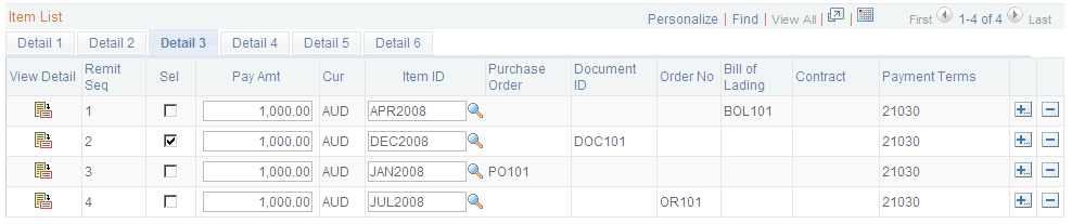

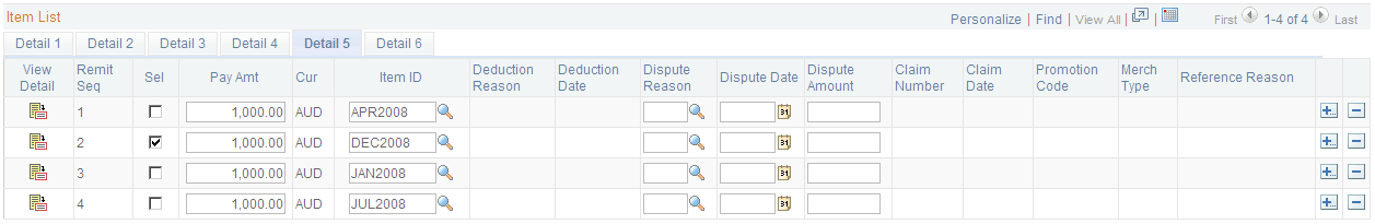

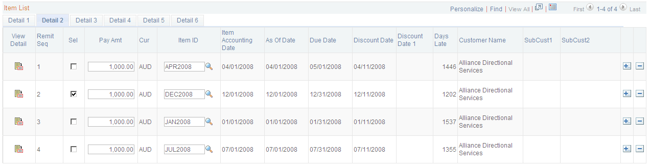

Use the Payment Worksheet Application page (PAYMENT_WS_IC) to apply payments to selected items.
Navigation:
This example illustrates the fields and controls on the Payment Worksheet Application page. You can find definitions for the fields and controls later on this page.
To use the payment worksheet, follow these steps:
Use the item display or sort controls to adjust the view.
Select the items to pay.
Handle underpayments, overpayments, and discounts.
Check the information in the Balance group box to determine whether you have used the entire payment.

This example illustrates the fields and controls on the Payment Worksheet Application page - Detail 1 tab.
Use the Customize link to sort by column and to reorder, hide, and freeze columns. This enables you to put the key fields that you want to review on the Detail 1 tab and sort your data.
Field or Control |
Description |
Click the View Detail icon to view or update details for a selected item on a worksheet and to copy or write off the item. |
Remit Seq (remit sequence number) |
This sequence number relates to the order in which the items were entered on the Worksheet Selection page. Initially, the items appear in this order. If you sort the worksheet based on the value in another column, the number stays with the item, but the grid order changes. Use this column to sort the worksheet in the original order. |
Sel (select) |
Select each check box for applying payments. You can control the rows that are selected with the Row Selection group box at the top of the page. |
Pay Amt (payment amount) |
Initially displays the open amount for the item. Change the amount to make a partial payment. |
Cur (currency) |
Displays the currency applied used for this payment. |
Item ID |
Enter or the system displays the item associated with this payment. You can also select a different or new item. |

This example illustrates the fields and controls on the Payment Worksheet Application page - Detail 2 tab.
Field or Control |
Description |
Item Accounting Date |
Displays the accounting date entered for online and external pending items. The date determines the fiscal year and accounting period used to post the item for both PeopleSoft Receivables and PeopleSoft General Ledger. |
As of Date |
Displays the date, which is usually the same as the accounting date that is entered for entering online and external pending items. You can also use this date to record the invoice date used to calculate payment terms. |
Due Date |
Displays the payment due date. If the due date falls on a bank holiday, the system adjusts it automatically. This field is required for the Aging Application Engine process (AR_AGING). |
Discount Date |
Displays the date on which you can apply a payment and receive a discount. You can set up default discount terms on the Payment Terms page for an item You can also enter discount terms on the |
Discount Date 1 |
Displays a second date closer to the payment due date on which you can apply a payment and receive usually a smaller discount. For example, if a payment is due on May 1, 2008 and the item details indicate that if a customer makes a payment on or before April 25, 2008, the customer receives a 5% discount. You also set up a second discount date (Discount Date 1) so that if the payment is made after April 25 but on or before April 28, the customer will receive a 2% discount. |
Days Late |
Displays the number of days that a customer is late in making a payment on this item. |
Customer Name |
Displays the customer's name associated with this customer's profile. |
SubCust1(subcustomer 1) |
Displays a subcustomer1 based on the setup on the Installation Options – Overall page and the set up of subcustomer 1 on the SubCustomer Qualifier 1 page (Set Up Financials/Supply Chain, Product Related, Receivables, Customers, SubCustomer Qualifier 1, SubCustomer Qualifier 1) |
SubCust2(subcustomer 2) |
Displays a subcustomer2 based on the setup on the Installation Options – Overall page and the set up of subcustomer 2 on the SubCustomer Qualifier 2 page (Set Up Financials/Supply Chain, Product Related, Receivables, Customers, SubCustomer Qualifier 2, SubCustomer Qualifier 2). |
This example illustrates the fields and controls on the Payment Worksheet Application page - Detail 3 tab.
Field or Control |
Description |
Purchase Order |
Displays a purchase order ID associated with the original invoice if a purchase order was used to purchase this item if you integrate with PeopleSoft Purchasing. If you enter a value that matches an existing item ID, the system automatically populates this field. |
Document ID (document identification) |
Displays a user-defined reference value, which is entered on the maintenance, payment, or draft worksheet to help identify the claim in the Claim Management workbench. If the document reference ID for deduction items in the Item table matches the document reference field for credit items in the Item table, the Automatic Maintenance process matches items for all customers associated with the remit from customer. |
Order No (order number) |
Displays the number of the PeopleSoft Inventory order number associated with the item on the original invoice. If you enter a value that matches an existing item ID, the system automatically populates this field. |
Bill of Lading |
This is the bill of lading associated with this item. A bill of lading lists all items in a shipment destined for a particular ship to location. If you enter a value that matches an existing item ID, the system automatically populates this field. |
Contract |
Displays the contract number associated with the original invoice if you integrate with PeopleSoft Contracts. If you enter a value that matches an existing item ID, the system automatically populates this field. |
Payment Terms |
Defines payment terms for this payment. The payment term is selected on the Pending Item 1 page The selected payment term specifies the rules for calculating an item due date and the discount terms. |

This example illustrates the fields and controls on the Payment Worksheet Application page - Detail 5 tab.
Field or Control |
Description |
Deduction Reason |
Displays the default reason code entered for the AR business unit or you can select a unique reason based on the entry reason for the deduction. If you want to use unique reasons for entry reasons, you must create deduction reason codes that are the same as the entry reason codes for the deduction (DED) entry type. |
Deduction Date |
Displays the date based on the default setting in on the Receivables Options – Payment Options page. This date will either be the accounting date or the item date depending on your selection on the Payment Options page. This date You can override the default date in this field. Note: You can also override the Receivables Options deduction fields in the View Update/Item Details - Detail 1 page. Warning! If you mark an item as a deduction using the Deduction check box rather than creating a deduction (WS-08 item) using the payment worksheet, you do not generate any accounting entries or close the original item and create a new deduction item. Once you select this check box and save the page, you cannot deselect your selection. |
Dispute Reason |
Displays a default value based on values that you set up in the Customer Relations group box on the Detail 1 page (Accounts Receivable, Customer Accounts, Item Information, View/Update Item Details) for a selected customer. If security was set up for you to set up these values in the View/Update Item Details component, then you can add, update, and delete the default dispute reason, dates, and values that appear in the worksheet. When you apply a partial payment to an item based on a dispute in the payment worksheet and every item row appears once, you can enter dispute information for each item. If an item row appears more than once on the worksheet, then you must enter the same dispute information for each row. If you enter the dispute information for an item row, and then enter a partial payment row for the same item, the dispute information that you entered on the first row will also appear in the partial payment row. However, if you enter the partial payment row first and enter the dispute information in that row, you must also enter the dispute information for the original item row. See View/Update Item Details - Detail 1 Page. See Dispute Reason Page. |
Dispute Date |
Displays the default date that you entered on the View/Update Item Details – Detail 1 page. You can override this date on the worksheet. |
Dispute Amount |
Displays the amount that you entered on the View/Update Item Details – Detail 1 page. You can override this date on the worksheet. |
Claim Number |
Displays the debit memo number that the customer sent you for a deduction. This number is entered on the View/Update Item Details – Detail 1 page. |
Claim Date |
Displays the date on which the customer created the debit memo for a deduction. This number is entered on the View/Update Item Details – Detail 1 page. |
Reference Reason |
Displays the reference reason which is associated with an item on the Reason Maintenance page (). You can select Reference Criteria when you build a payment worksheet. See Applying Payments: Building a Payment Worksheet |

Field or Control |
Description |
Letter of Credit ID |
Displays an ID if a letter of credit is associated with this the payment of the item. |
AG Number (acceptgiro reference number) |
Displays the acceptgiro (AG) reference number assigned to the item or invoice when you ran the Statements process (AR_STMTS) or the AR Dunning process (AR_DUNNING) for business units enabled for acceptgiro processing. It also displays the acceptgiro reference number assigned to the invoice when you printed the invoice in PeopleSoft Billing. |
Region |
Displays the code for the team members that are assigned to the item. This code is selected when entering a pending item. |
Declaration Point |
Displays the point at which you report VAT to the tax authorities—at the accounting date, at invoice time, at delivery, or at the time of payment. Values only appear in this field if VAT is enabled for this customer. See Invoice, Delivery, Accounting Date, or Payment Declaration Point. |
Doubtful |
Indicates that you transferred the item to a Doubtful Receivables account using the transfer worksheet. |
Balance - Base Currency |
Displays the open amount for the item in the entry currency and the base currency. The base amount appears only if the balance differs from the base currency for the business unit. |
Invoice |
Displays the number of the related invoice associated with the item. |
Invoice Business Unit |
Displays the business unit associated with the invoice. |
Collection Code |
Displays a collection code indicating that one or more payments have not been made for this item or by this customer. |
Use the Multiple Revenue Line Distribution page (click the Revenue Distribution link on the Worksheet Application page) to distribute amounts for multiple revenue lines for control budgets.
This example illustrates the fields and controls on the Multiple Revenue Line Distribution page - Amount tab.
This example illustrates the fields and controls on the Multiple Revenue Line Distribution page - Chartfields tab.
The only item entries that appear on the page are ones for which you are making a partial payment.
Field or Control |
Description |
Display Control |
If you are viewing all item entries, select an option to limit the list of item entries and click Redisplay. Options are: All Entries: Displays all item entries. Manual Entries: Displays only item entries that the user is changing manually. Out of Balance: Displays only item entries that have a remaining amount. |
Revenue Amount Distribution |
Specify how to distribute the revenue. Enter the instruction for an individual item entry by completing the Revenue Amount Distribution field for the item entry and clicking Distribute. Enter the instruction for all items displayed in the scroll area by completing the All Item Entries Displayed field and clicking Distribute All. Options are: System Distribution: This is the default. The Revenue Estimate Application Engine process (AR_REV_EST) calculates the revenue distribution amount for each line by prorating the revenue balance for all lines. If you have selected a manual method, select this option to enable the process to calculate the amounts. Reset to Zero: Select to reset all the amounts to 0. Weighted Open Balance: Select to have the system prorate the revenue amounts based on the revenue balance for each distribution line. Then readjust the amounts as needed. Even Across Revenue Lines: Select to distribute the revenue amount evenly across all lines for the item entry. Then readjust the amounts as needed. |
Revenue Amount |
Displays the total revenue amount for the item entry. |
Distributed Amount |
Displays the total of the revenue amount that has been entered for the revenue lines. |
System Distribution |
Select to have the Revenue Estimate process calculate the revenue distribution amounts. |
Remaining Amount |
Displays the difference between the total revenue amount for an item entry and the amount entered. The amount must be 0 to post the worksheet. Click the Refresh button to update the totals. |
Use the Worksheet Application Detail View page (click the View Detail button on the Worksheet Application page).
This example illustrates the fields and controls on the Worksheet Application Detail View page. You can find definitions for the fields and controls later on this page.
View item details to identify an item or change the details as needed.
Field or Control |
Description |
Deduction Reason |
If you are creating a new deduction, enter the reason why the customer took the deduction. You define reason codes on the Deduction Reason page. |
AR Specialist (accounts receivable specialist) |
The system populates the AR Specialist field for deduction items based on the default specialist that you assigned to the business unit. If you overrode the default specialist for the deduction reason or customer, the system uses that value. |
Document |
If you enter a value that matches an existing item ID, the system automatically populates the Bill of Lading, Order No (order number), PO Ref (purchase order reference), Contract # (contract number), Letter of Credit ID, and Due Date fields with the values for the existing item when you save or refresh the page. If you receive different information for these fields with the payment, override those values. If you are applying the payment to a vendor rebate claim item or claimback item from PeopleSoft Purchasing or PeopleSoft Order Management, you must enter a reference ID. When you run the Rebate Notification process, it sends the reference ID to PeopleSoft Purchasing and PeopleSoft Order Management to use to reconcile the claims on the claims management workbench. This field is available for entry for existing items only if you enter entry reasons on the AR Integration page. |
Location |
Enter the address sequence number for new items. You must enter a value in this field to include the item in correspondence if you selected the Item Address option for the correspondence customer on the Correspondence Options page. |
Copy |
Click to copy selected and unselected items on the payment worksheet to a new row to the worksheet. This enables you to create deductions and other adjustments to lines that have already been selected for payment. You must add the amount and entry type to the new row. |
Write Off |
For a new item, click this button to write off an overpayment or underpayment amount. |
Dispute |
Click to access the Dispute Status Tracking page and view dispute status information for an item. This link appears only when dispute tracking data exists for the item. |
Note: To save your changes on this page, return to the Worksheet Application page.

Use the Currency Exchange Aid page (CURR_EXCHG_AID_SEC) as an aid in converting the payment amount to the currency of a selected item making a partial payment.
The Currency Exchange Aid page can only be used with items that have been selected with an entry type of payment.
Navigation:
Click the Currency Exchange Aid link on the Worksheet Application Detail View page.
This example illustrates the fields and controls on the Currency Exchange Aid page.
The Amount to apply to Item field initially displays the amount from the Worksheet Application page in the entry currency. If you want to partially pay the item, you have two options:
Change the amount to pay using the item currency in the Amount to apply to Item field.
When you press the Tab key to exit the field, the system updates the Amount of payment to apply to Item in Payment Currency field with the amount of the payment that you will apply to the item in the payment currency.
Enter the amount of the payment to apply to the item in the payment currency in the Amount of payment to apply to Item in Payment Currency field.
When you press the Tab key to exit the field, the system changes the item amount (the amount of the item you will pay) in the Amount to apply to Item field.
Each time that you change one of these amounts, the system updates the New Payment Amount Remaining field so that you can track how much of the initial payment remains.
