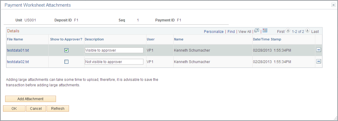

The user has the option to select which attachments must be made visible to the approver of the write-off. When the approver or reviewer opens the approval page, they are able to view only the attachments for which they have been granted visibility by the user.
This example illustrates the requester view of the Attachments page.

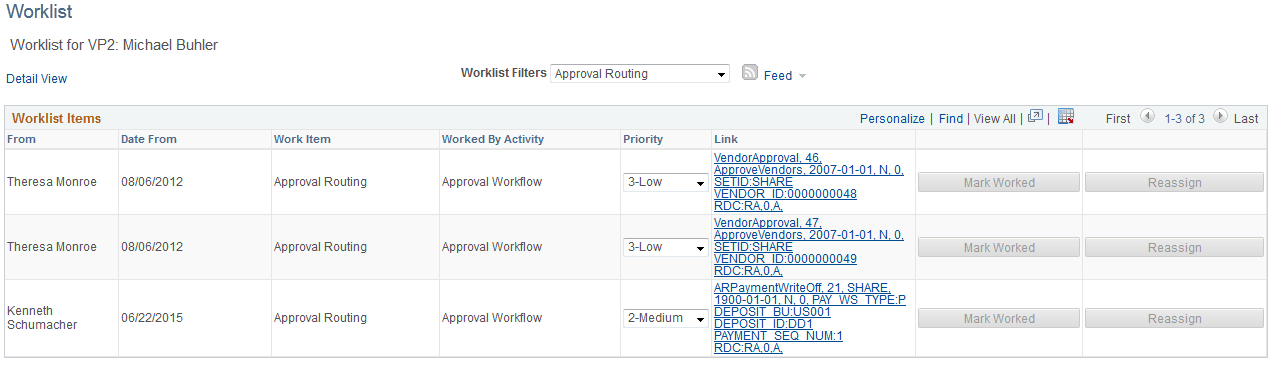

The approver receives a notification on the Worklist page or on the Actions tab in the PeopleSoft Fluid User Interface that a write-off amount requires approval. From the worklist, the approver can access the Worksheet Application page for the Payment worksheet, Maintenance worksheet, Credit Card worksheet, or Draft worksheet to view details of the write-off. From the Action tab, the notification link takes the user to the classic approval page; when conditional navigation is enabled, the link takes the user to the PeopleSoft Fluid User Interface approval page.

This example illustrates the fields and controls on the Worklist page, including notification for a pending payment write-off approval.

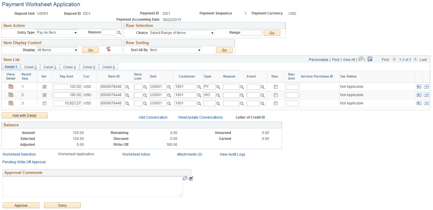

On the Worksheet Application page for the Payment worksheet, Maintenance worksheet, Credit Card worksheet, or Draft worksheet, the approver can review the write-off and choose to approve, deny, or push back. The bottom of the Worksheet Application page displays buttons to approve or deny the write-off amount and contains a section to enter comments. A reviewer can also add comments.
This example illustrates the fields and controls on the Payment Worksheet Application page with Approve and Deny action buttons.

Once the write-off amount is approved or denied, the Worksheet Application page displays a link to view approval details. For approvals, the Approved Write-Off link displays. For denials, the Denied Write-Off link displays. For Push Back, Pending Approval is displayed on the page.
Click the Approved Write-Off link or the Denied Write-Off link to access the Writeoff Approver Stage page (AR_APPR_MONITOR). This page enables you to view the approval steps and any comments entered when approving or denying the write-off on the Worksheet Application page.
