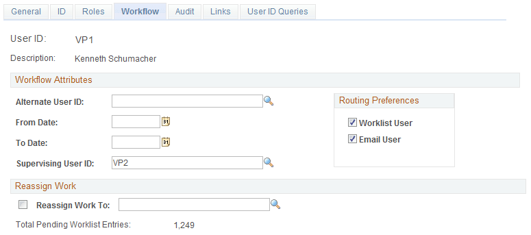

Use the User Profiles - Workflow page to define supervisors and worklist users.

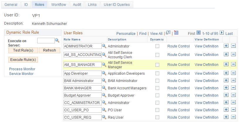

Use the User Profile-Roles page to enter the roles of the user.
Use the User Profiles - Workflow page (USER_WORKFLOW) to define supervisors and worklist users. Identify the supervisor who should approve the write-off transactions.
Navigation:
This example illustrates the fields and controls on the User Profile - Workflow page.
For the requester's user profile, identify the supervisor (Supervising User ID field) who should approve the write-off transactions. The supervisor is important if you are using the SQL definition EOAW_SUPERVISOR_BY_OPRID in the WriteOffApprovers user list. Verify that Worklist User check box and the Email User check box located in the Routing Preferences group box are selected.
For the supervisor's user profile, select both the Worklist User check box and the Email User check box located in the Routing Preferences group box.
Use the User Profiles - Roles page (USER_ROLES) to attach workflow roles to users. Add the roles with the authority to approve write-off amounts.
Navigation:
This example illustrates the fields and controls on the User Profile - Roles page.
A role is a class of users who perform the same type of work, such as a collector, credit analysis, AR specialist, or manager. A role describes how people fit into workflow. Roles are defined under PeopleTools, Security, Permissions & Roles, Roles. Roles are important because you define a role on the User List Definition page (Enterprise Components, Approvals, Approvals, User List Setup), and then add the role to each user ID with the authority to approve write-off amounts.

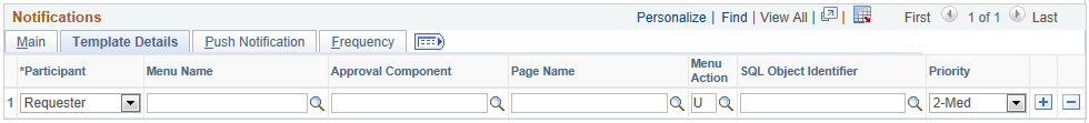

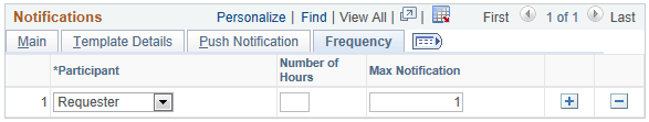

Use the Configure Transactions page (EOAW_TXN_NOTIFY) to select and define elements that determine what triggers a notification, who receives the notification, and the content of the notification. Notifications are mapped to work with the approval transaction registry and include menus and components and SQL definitions.
The Approval Framework supports email, worklist, and push notifications.
Navigation:
The Configure Transactions page uses the same process IDs as the Register Transactions page, including the following process IDs for AR write-offs:
ARPaymentWriteOff
ARDraftWriteOff
ARMaintWriteOff
The following example shows the fields and controls on the Configure Transactions page for the ARPaymentWriteOff process ID:
This example illustrates the fields and controls on the Configure Transactions page displaying the Notifications - Main tab, for payment and credit card write-off approvals in Receivables.
This example illustrates the fields and controls on the Configure Transactions page displaying the Notifications - Template Details tab, for payment and credit card write-off approvals in Receivables.
This example illustrates the fields and controls on the Configure Transactions page displaying the Notifications - Push Notification tab, for payment and credit card write-off approvals in Receivables. Use the Push Notification tab to identify the SQL that retrieves data for display on the push notification alert or approval tab.
This example illustrates the fields and controls on the Configure Transactions page displaying the Notifications - Frequency tab, for payment and credit card write-off approvals in Receivables.
