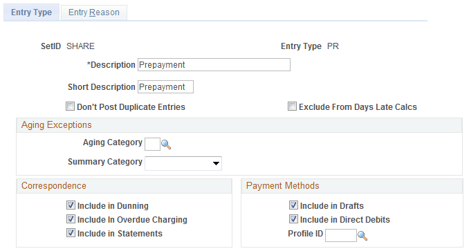

Use the Entry Type page (ENTRY_TYPE_TABLE1) to create and define entry types.
Navigation:
This example illustrates the fields and controls on the Entry Type page. You can find definitions for the fields and controls later on this page.
Field or Control |
Description |
Don't Post Duplicate Entries |
This check box handles:
Select when you post a subsequent event—such as a debit memo or a credit memo—that has the same business unit, customer ID, item ID, and item line as the invoice before you post the invoice. This occurs if:
Normally, the system creates an Item record for each new item with its entry type. Subsequent entries create item activity lines but do not alter the entry type on the Item table (PS_ITEM). If the original item is a debit or credit memo instead of an invoice, then the debit or credit memo entry type will be on the Item record. What you really want is the invoice entry type. You need to have the appropriate entry type on the Item record, because entry types determine aging redirection, correspondence inclusion, and weighted average days late calculations. If a prepayment or credit memo posts first and the invoice posts second, you need to update the Item record with the entry type and date of the invoice. Selecting the Don't Post Duplicate Entries check box for an entry type means that:
Note: Be sure that you select this check box only for invoice type or dominant transaction types and that only dominant entry types can be posted against an item. |
Exclude From Days Late Calcs (exclude from days late calculations) |
Select to exclude items with this entry type from history calculations for average days late and weighted average days late. |
Aging Category |
Enter an aging category in which to place items, rather than aging them normally. Note: If you define a rule for aging deductions, disputes, or collections in an aging ID other than aging normally, that rule takes precedence over a category that you select here. |
Summary Category |
Select a summary category to place items in a different summary category from the one associated with the aging category. |
Include in Dunning, Include in Overdue Charging, and Include in Statements |
Select to include items with the entry type in dunning letters, on overdue charge invoices, and on statements. In the delivered system, all entry types are included; deselect the check boxes to exclude those that you do not want to appear in correspondence. This applies only to the entry type on the item itself, not to item activities. |
Include in Drafts, Include in Direct Debits, and Profile ID |
Select to include items of this entry type in drafts and direct debits. If you select Include Direct Debits, enter a profile ID to use a specific direct debit profile for all items using this entry type. Otherwise, leave Profile ID blank to use the profile ID assigned to the customer. If you enter a profile ID, you must select the Use Entry Type field on the Direct Debit Profile page. |

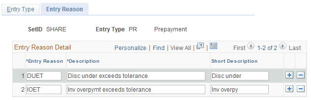

Use the Entry Reason page (ENTRY_TYPE_TABLE2) to specify the appropriate entry reasons for an entry type.
Navigation:
This example illustrates the fields and controls on the Entry Reason page.
For each entry type that you define, you can set up as many valid entry reasons as needed.
