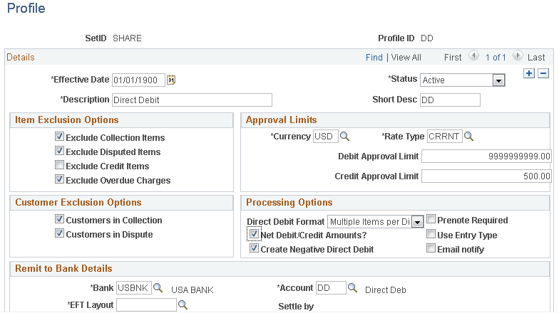

Use the Direct Debit Profile - Profile page (DD_PROFILE) to create direct debit profiles, select item and customer exclusion options, define approval limits and processing options.

This example illustrates the fields and controls on the Direct Debit Profile - Profile page. You can find definitions for the fields and controls later on this page.
Item Exclusion Options
Use the check boxes in the Item Exclusion Options group box to prevent the Create Direct Debits process from selecting certain types of items when it creates direct debits and builds the worksheet.
Customer Exclusion Options
Use the check boxes in the Customer Exclusion Options group box to prevent the Create Direct Debits process from selecting items for customers who are in collection or dispute.
Approval Limits
The values that you enter in the Approval Limits group box determine whether the Create Direct Debits process automatically approves a direct debit or a direct credit. If the direct debit amount is within the approval limits, it assigns the status of Accepted. If the process does not approve the direct debit because it is over the approval limit, it assigns the status of Pending Approval.

Processing Options

Remit to Bank Details
