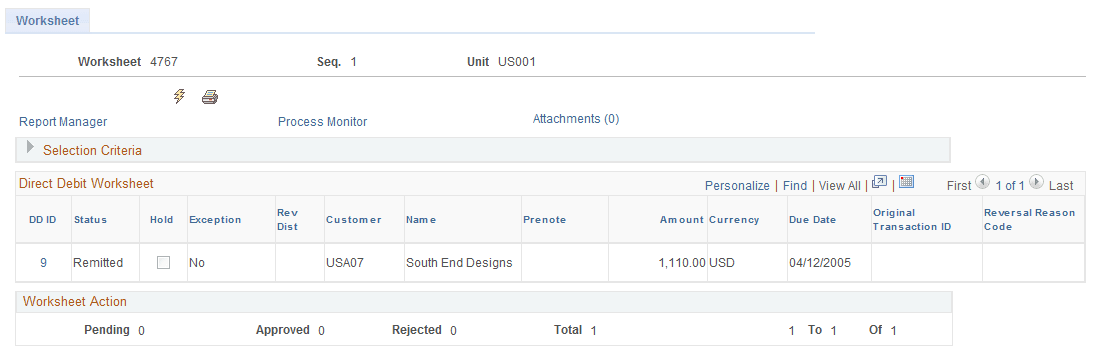

Use the Update Direct Debits - Worksheet page (DD_WORKLIST) to approve, hold, or reject direct debits.
Mark the direct debits as ready for remittance to the bank.
Create an EFT file for the direct debits on the worksheet.
Navigation:
Click the Direct Debit button on the Create Direct Debits page.
This example illustrates the fields and controls on the Update Direct Debits - Worksheet page. You can find definitions for the fields and controls later on this page.
Field or Control |
Description |
Accounting Date |
The accounting date is set to the current date if you leave the field blank. This field is available only when the worksheet can be remitted; that is, when the status of each direct debit in the worksheet is set to the Accepted value or the No Action value. The system edits the accounting date to ensure it is in an open accounting period. |
Entering Selection Criteria
In the Selection Criteria group box, select the direct debits that you want to display.
Field or Control |
Description |
Status |
Select the status for the direct debits. Options are: Accepted, Complete, No Action, Pending, Rejected, or Remitted. |
Exception |
Select all the direct debits or only those that have the specified exception condition. |
DR/CR (debit or credit) |
Select :
Direct Debit Amounts >= (direct debit amounts greater than or equal to) |
Enter a direct debit amount value. When you click the Change Criteria icon, the system displays the direct debits that have an amount greater than or equal to this specified amount. |
Click the Change Criteria icon to update the list of direct debits based on your new selection criteria. |

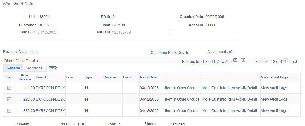

Use the Worksheet Detail page (DD_WORKSHEET_SEC) to view or change details about a direct debit, such as the bank account or individual items.
Navigation:
Click the DD ID (direct debit ID) link for the direct debit on the Update Direct Debits - Worksheet page.
This example illustrates the fields and controls on the Worksheet Detail page. You can find definitions for the fields and controls later on this page.
Use the information at the top of the page to view or change details about the direct debit.
Field or Control |
Description |
Bank and Account |
Displays the bank account where the funds are deposited. |
Due Date |
Displays the date that the funds should be deposited in your organization's bank account. Override the date if needed. |
MICR ID (magnetic ink character recognition ID) |
Displays the MICR ID associated with the customers bank account from which the funds are withdrawn. Change the ID to another account if needed. |
Revenue Distribution |
Click to access the Multiple Revenue Line Distribution page (AR_MLR_SEC) where you distribute revenue to control budgets for partial payments when an item has multiple revenue lines. See Distributing Amounts for Multiple Revenue Lines for Control Budgets. |
Document Sequencing |
Click to view document sequencing information. |
Customer Bank Details |
Click to view or change information about the customer's bank account (identified by the MICR ID) on the Customer Bank Account Details page (CUST_BANKINFO_SEC). |
Click the Edit icon to change information for the direct debit. The status on the Worksheet page changes to Pending. The fields on the Worksheet Detail page become available to edit. |
Sel (select) |
Remove items from the direct debit by clearing their check boxes. When you deselect an item, the total amount of the direct debit decreases and the item is available for selection in another direct debit request. |
Item Balance |
To partially pay for an item, change the amount to the amount you want to pay. This decreases the amount of the direct debit. The Receivables Update process adjusts the balance for the item when you post the direct debit group, and the remaining balance of the item will be available for selection in another direct debit request. |
Event |
Enter the entry event code to generate the appropriate supplemental accounting entries for the item activities. Federal financial systems require supplemental accounting entries. |
After you make changes, select another action by clicking one of the following icons. This changes the status of the direct debit on the Worksheet page.
Field or Control |
Description |
Click the Approve icon to change the direct debit's status to Accepted. |
Click the Reject icon to reject the direct debit and change its status to No Action. The items in the direct debit will be available for selection in another direct debit request. Or you can click the Item ID to change from direct debit to another payment method on the item details page (ITEM_MAINTAIN). |
Click the Hold icon to put the direct debit On Hold. The status on the Worksheet page remains Pending. If you put a direct debit on hold, you cannot change the status to Remitted. You must first approve the direct debit. |
