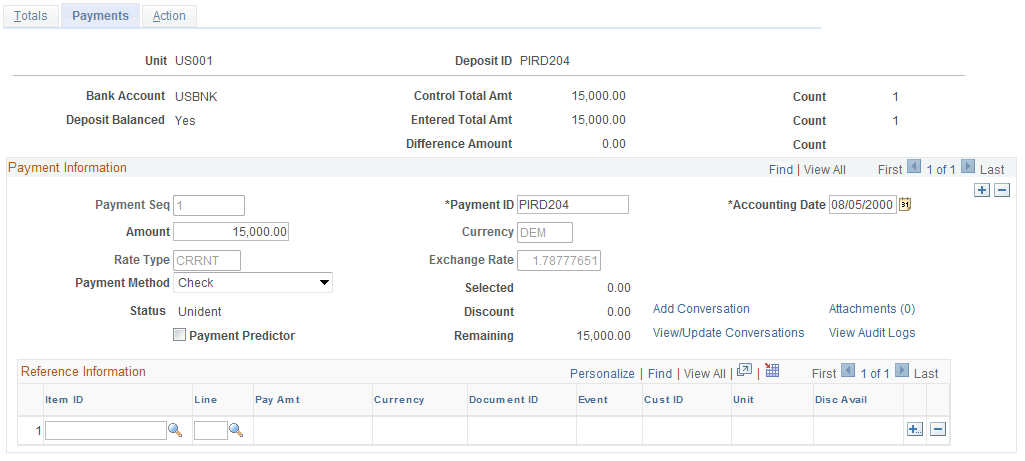

Use the Express Deposit - Payments page (PAYMENT_EXPRESS2) to enter and apply payments with item IDs in a deposit after you enter the deposit control totals.
Navigation:
This example illustrates the fields and controls on the Express Deposit - Payments page. You can find definitions for the fields and controls later on this page.
Field or Control |
Description |
Deposit Balance |
Displays the deposit status. When the amount total and number of entered payments equals the control amount and count from the Express Deposit - Totals page, the status changes from No to Yes. |
Control Total Amt (control total amount) |
Displays the control totals entered on the Express Deposit - Totals page. |
Entered Total Amt (entered total amount) and Difference Amount |
Displays the amount of the payments that you have entered and the difference between the payments entered and the control totals. If the control and entered totals are not the same, you cannot apply any of the payments. Balancing these control totals is a necessary first step in payment application. |
