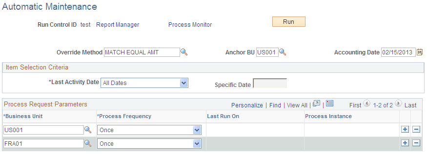

Use the Automatic Maintenance page (AUTOMNT_REQUEST) to run the PS/AR Automatic Maintenance Application Engine process (AR_AUTOMNT) and/or reports.
Navigation:
This example illustrates the fields and controls on the Automatic Maintenance page.
Field or Control |
Description |
Override Method |
Select an automatic maintenance method if you want to use the same method for all items instead of the method assigned to the business unit. Select one of these methods:
Anchor Business Unit |
Select the business unit to use for transactions that cross business units for interunit accounting entries. Leave blank to use the business unit of the first item in each group as the anchor business unit for the maintenance group. If you enter an anchor business unit, the system uses the format currency for the business unit to convert transaction amounts to a common currency. Otherwise, it uses the format currency for the lowest-value business unit that you enter in the Process Request Parameters grid. The process assigns the same anchor currency to each Maintenance worksheet that it creates. The system displays the worksheet totals in the anchor currency. Note: The system uses the anchor business unit to perform an automatic write-off of a remaining amount. |
Accounting Date |
Enter the accounting date for the process to use as the accounting date for any new items that it creates. If you leave the field blank, the process uses the date at the time of the run as the accounting date. |
Last Activity Date and Specific Date |
Select one of the following values for the last activity date:
Business Unit |
Enter the ID of all business units for which you want to match items. If you do not want to create match groups that include items across all business units, enter only one business unit. |
