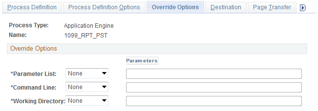

Override Options Page |
PRCSDEFNOVRD |
Enter override options for the Format EFT File process. See Entering Override Options for the Format EFT File Process. See the Override Options Page for more information. |

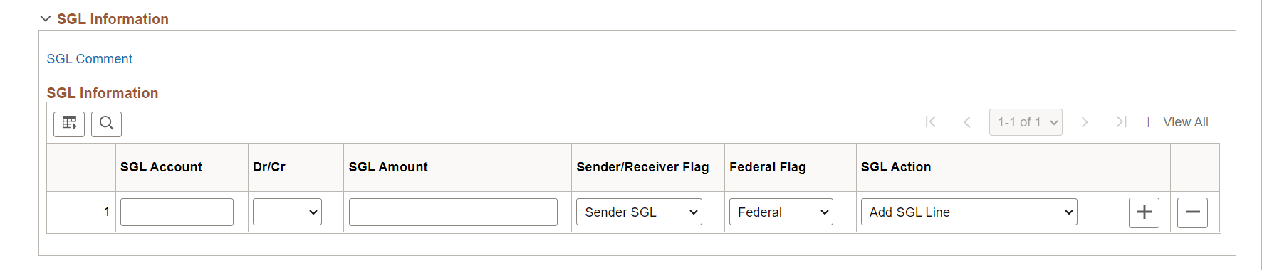

The SGL account information is now optional, however, if you want to automatically supply this information, you must perform these tasks:

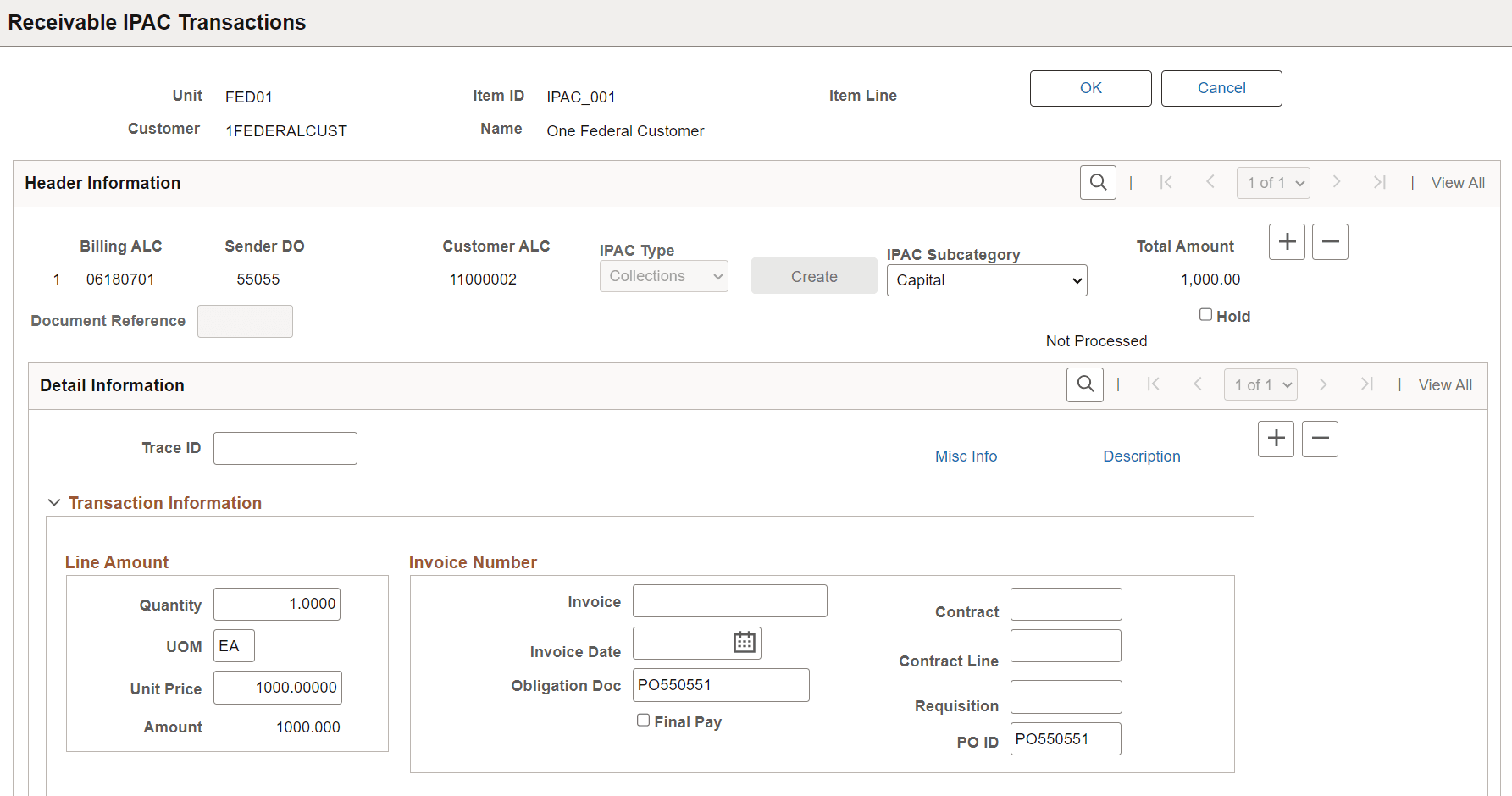

Use the Receivable IPAC Transactions page (AR_IPAC_SEC) to enter information required by IPAC.
Navigation:
Click the Transfer to IPAC Transactions link on the View/Update Item Details - Detail 1 page.
This example illustrates the fields and controls on the Receivable IPAC Transactions page (1 of 3). You can find definitions for the fields and controls later on this page.
This example illustrates the fields and controls on the Receivable IPAC Transactions page (2 of 3). You can find definitions for the fields and controls later on this page.
This example illustrates the fields and controls on the Receivable IPAC Transactions page (3 of 3). You can find definitions for the fields and controls later on this page.
Some of the information displayed on this page comes from the default values for IPAC that you assigned to business units, customers, and contacts. You can override the default values as needed.
Header Information
Field or Control |
Description |
Billing ALC (billing agency location code) |
Displays the billing agency location code that you assigned to the SetID for the business unit. Override the code if needed. |
Sender DO (sender disbursing office) |
Displays the five-digit ID that you assigned to the SetID for the business unit. Override if needed. |
Customer ALC (customer agency location code) |
Displays the agency location code that you assigned to the customer associated with the item. Override if needed. |
IPAC Type |
Select an IPAC transaction type. Values are: Collection: Use for new transactions that you are sending to the IPAC system. Adjustment: Use for IPAC payment transactions received from another agency to add information and adjust the amount due. This option is not available if you initiated the transaction. Post SGL: Use to add or change the SGL account information for prior transactions that you sent for collection. Zero: Use for IPAC transactions that you have already sent to the IPAC system to change information other than the amount or the SGL account information. None: Use for information purposes only. No data is sent to the Department of Treasury. Note: The fields that require entry on the page vary based on the transaction type. |
Subcategory |
Displays the IPAC subcategory you defined on the Receivables Options - General 1 Page. Subcategory values can be:
Create |
Click to validate that no previous transactions exist for the item and to create IPAC transactions. Any previously entered transactions for the item must have a process status of Processed. After you click the Create button, the system enables data fields based on the IPAC record type selected. If you click the Create button after IPAC detail records have been created, the system issues a message warning that the existing IPAC detail records for this IPAC transaction will be re-created. You can proceed or cancel the action. Note: If you want to create additional IPAC transactions for an item that has prior transactions with a Processed status, you must insert a new record and IPAC type prior to clicking the Create button. |
Total Amount |
Displays the total amount of the IPAC transaction for all item lines. |

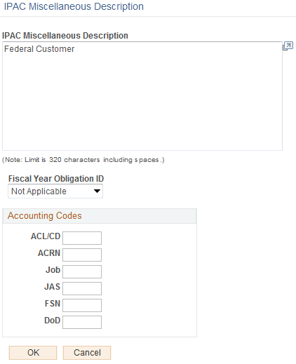

Misc Info (miscellaneous information) |
Click to add additional information about the transaction. |
Description |
Click to add information about the IPAC description on the IPAC Description page (AR_IPAC_DESCR_SEC). |

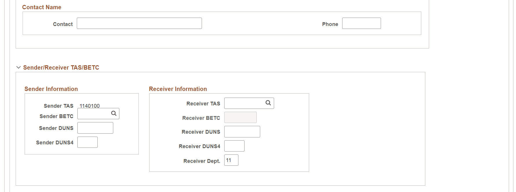

Sender/Receiver TAS/BETC
The fields that are available in this section vary based on the IPAC transaction type. This table shows the fields that are available based on the IPAC type:
IPAC Transaction Type |
Available Fields |
Collection |
All fields. |
Adjustment |
All fields except sender and receiver DUNS and DUNS4. |

TAS (Treasury Account Symbol) |
For the sender, select the account number assigned by the U.S. Department of Treasury to classify transactions. Indicates the agency that initiated the billing. For the receiver, select the account of the fund that will receive the payment. The following table summarizes the TAS format for Sender ALCs and Receiver ALCs, and field dependencies in PeopleSoft Receivables. |
Agency Location Code |
GWA Type |
Consider Fund Code? |
TAS Format |
27th column |
TAS Field |
Sender ALC |
GWA Reporter |
Yes |
GWA TAS |
‘C’ |
Required |
Sender ALC |
Non-GWA Reporter |
Yes |
String TAS |
Optional |
Receiver ALC |
GWA Reporter |
No |
GWA TAS |
‘C’ |
Required |
Receiver ALC |
Non-GWA Reporter |
No |
String TAS |
Optional |
Field or Control |
Description |
BETC (business event type code) |
Select the code used in the Governmentwide Accounting and Reporting Program (GWA) to indicate the type of activity being reported, such as payments, collections, and so on. This code must accompany the Treasury Account Symbol (TAS) and the dollar amounts to classify the transaction against the fund balance with the Treasury. The selected TAS determines the available BETC codes. Most TAS will have the following four BETC codes:
The following table summarizes the BETC requirements and selections for Sender ALCs and Receiver ALCs, and field dependencies in PeopleSoft Receivables. |
GWA Type |
BETC Field |
BETC Defaulting Logic |
Number of BETC codes <=4 |
Number of BETC codes > 4 |
Sender ALC |
GWA Reporter |
Required |
Yes – default BETC |
No Defaulting. User has to manually select the BETC code. |
Sender ALC |
Non-GWA Reporter |
Optional |
No |
No. |
Receiver ALC |
GWA Reporter |
Required |
Receiver ALC |
Non-GWA Reporter |
Optional |
No |
No |
Field or Control |
Description |
DUNS and DUNS4 |
Enter the Dun & Bradstreet numbers used to identify the sender (your agency) or the receiver (the customer's agency). The Sender DUNS and Sender DUNS4 appears by default from the values defined on the Agency Location Code Page, if the DUNS fields were set up as required on the IPAC Fields Page. The Receiver DUNS and Receiver DUNS4 appear by default from the values defined on Customers - Additional General Information page. |
Department |
Displays the receiver department code of the customer. This field appears by default from the first two characters of the Receiver ALC. |
Entering SGL Information
If you entered an entry event code for the item in PeopleSoft Billing or during pending item entry on the Pending Item 1 page, the Receivables Update process populates the fields in the SGL Information grid. You can override the values if needed. If you did not enter an entry event code, you must enter SGL account information for Post SGL transaction types, and you can optionally enter SGL account information for the Collection and Adjustment transaction types. The SGL information fields are not available for zero dollar transaction types.
Field or Control |
Description |
SGL Comment (standard general ledger comments) |
Click to access the AR Post SGL Comments page (AR_IPAC_SGLCMT_SBP), where you can enter standard general ledger comments. This link is active only when Post SGL is selected in the IPAC Type field. |
SGL Account (standard general ledger account) |
Enter a chart of accounts used by the U.S. Department of Treasury for central agency reporting. |
Dr/Cr (debit/credit) |
Select a debit or credit, which determines the type of amount entered. When this value is saved, the system validates that the total debit amount is equal to the total credit amount. |
SGL Amount (standard general ledger amount) |
Enter an SGL amount. The Dr/Cr field determines the type of amount to enter. This value is used to verify that the total SGL debit amount is equal to the total SGL credit amount. It also verifies that the individual SGL amount is no greater than the amount on the IPAC detail record |
Sender/Receiver Flag |
Select a value to indicate whether the SGL account information for the line is for the sender (your agency) or the receiver (the customer's agency). |
Federal Flag |
Select a value to indicate whether the SGL account information for the line is Federal or Non-Fed (non-federal). |
SGL Action (standard general ledger action) |
Select a value that indicates the action for the line. Values are: Add: Indicates that this is a new line. Edit: Indicates that this is a changed line. For Post SGL transaction types, the action is Edit for existing lines and Add for new lines. For Adjustment transaction types, the action is Edit even though no existing rows exist. |
Use the IPAC Miscellaneous Description page (AR_IPAC_MISC_SEC) to enter additional text to describe an IPAC transaction and additional sender and receiver information.
Navigation:
Click the Misc Info (miscellaneous information) link on the Receivable IPAC Transactions page.
This example illustrates the fields and controls on the IPAC Miscellaneous Description page. You can find definitions for the fields and controls later on this page.
Enter comments about the collection request in the text box.
Field or Control |
Description |
Fiscal Year Obligation ID |
Select a value to indicate the fiscal year of the obligation. Values are Not Applicable, Current Fiscal Year, and Prior Fiscal Year. |
ACL/CD (account classification code) |
Displays a project code and is supplied to the billing agency by the customer on the original request for services. |
ACRN (account classification reference number) |
Appears for adjustment type only. |
Job |
Not available for adjustment type. |
JAS (job agency site) |
Displays a combination of job order number, accounting classification record number, and site ID. |
FSN (fiscal station number) |
Displays an 8-digit number identifying the subdivision of an agency location code. |
DoD (activity address code) |
Displays the activity address code. |
The fields that are available on this page vary based on the IPAC transaction type. This table shows the fields that are available based on the IPAC type:
Available Fields |
Collection |
All fields. |
Adjustment |
All fields. |
Zero Dollar |
All fields except Fiscal Year Obligation ID. |
Post SGL |
Only the text box. |
Use the Override Options page (PRCSDEFNOVRD) to enter override options for the Format EFT File process.
Navigation:
This example illustrates the fields and controls on the Override Options page for the Format EFT File process. You can find definitions for the fields and controls later on this page.
If you run PeopleSoft Receivables on a DB2 database on a Microsoft Windows or IBM OS390 server, you must manually insert an owner ID parameter in the list of parameters for the process definition before you can run the Format EFT Files process.
Field or Control |
Description |
Parameters List |
Enter Prepend. |
Parameters |
In the Parameters field next to the Parameters List field, enter %%OWNERID%% :EFT_WRK_PARM1 as shown in the preceding example. Note that a space is between the owner ID parameter (%%OWNERID%%) and :EFT_WRK_PARM1. |
