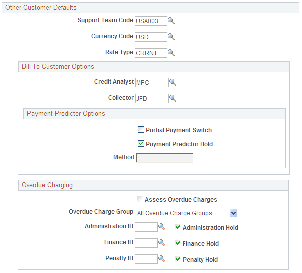

Select the Add An Item check box for each Overdue Charge ID on the Overdue Charging - Setup 2 page ().
By default, the setup for customers representing employees prevents them from being processed for overdue charges. Default settings include hold check boxes selected for Administration ID, Finance ID, and Penalty ID, and the Assess Overdue Charges check box deselected. You can change these options on these pages:
The Service Default Options page during the process of customer creation initiated by HCM.
The General Information - Correspondence Options page after the customer has been created in Receivables.
After Order Management receives an Integration Broker message from HCM to create a customer, you can access the Service Default Options page ().
We recommend deselecting the Hold check boxes only for the overdue charge IDs that have been specified in the customer setup.
If you deselect the Hold check box associated with an empty overdue charge ID field, the charge ID from the business unit will be used. If the Overdue Charge ID of the business unit does not have the Add An Item check box selected, the service purchase item’s balance would change. As a safeguard, the Overdue Charge processing will skip service purchase items and add a warning to the message log that indicates the service purchase items have been bypassed due to an overdue charge setup problem.

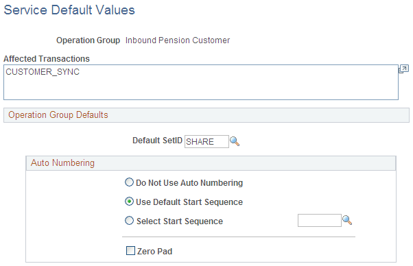

Use the Service Default Values page (SCM_SVC_DFLTS) to change default values for Pension Administration customers.
Navigation:
This example illustrates the fields and controls on the Service Default Values page for Pension Administration customers (1 of 2).
This example illustrates the fields and controls on the Service Default Values page for Pension Administration customers (2 of 2).
