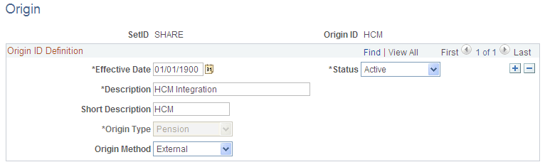

Use the Origin page (ORIGIN_TABLE1) to define group origin IDs.
Navigation:
See the documentation for the Origin Page.
This example illustrates the fields and controls on the Origin page for integration with HCM.
To create an origin ID to be used for integration with Pension Administration, use the following values:
Origin Type = Pension
Origin Method = External
