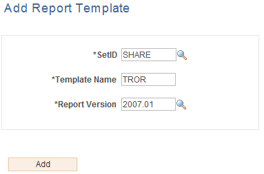

Use the Add Report Template page (AR_ADD_TEMPLATE) to define a new TROR report template name and version.
Navigation:
This example illustrates the fields and controls on the Add Report Template page. You can find definitions for the fields and controls later on this page.
Field or Control |
Description |
SetID |
Select the SetID that applies to your organization. |
Template Name |
Assign an identifiable name for this TROR template. |
Report Version |
Select the version of this report. This number represents the most current report version and is derived from the version control record (AR_RPT_VERSION), which is delivered as system data. |

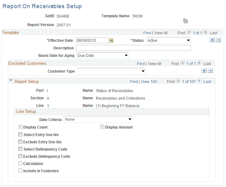

Use the Report On Receivables Setup page (AR_UPDATE_TEMPLATE) to search for an existing template and set up the characteristics of each system-defined line, which is associated with a system-defined part and section.
Navigation:
This example illustrates the fields and controls on the Report on Receivables Setup page. You can find definitions for the fields and controls later on this page.
Click the Copy Template icon to display the Report on Receivables Template Copy page. You can select a new SetID and enter a new template name on this page. The version is display only and is controlled by the system defined version control table. For example, user can create a new template using sample template TRORV1 under SetID SHARE, report version 2007.01, if wish to reuse the set up data for the sample template.
Once the new template has been copied, you can return to the Update Report Template search page and search for the new template that you just created. You can modify the characteristics of this template as needed.
Field or Control |
Description |
Effective Date |
Select the date from which this report template setup is applicable. |
Status |
Select whether the data on this report template is an Active or Inactive. Note: You can modify the information on this template as of a selected effective date by clicking the Add (+) icon, changing the effective data and making that date active. |
Description |
Enter a description of this template. |
Basis Date for Aging |
Select either the Due Date, which is the due date assigned to an item, or the As of Date of an item. |
Customer Type |
Select a specific type of customer to exclude from this report or you can leave the field blank to include all customer types in the report. Customer types are defined based on your implementation setup. If you want to exclude more than one customer type, you can click the Add (+) icon to the right of the Customer Type field and select another customer type to exclude from the report. You can continue to add the customer types that you want to exclude using the Add (+) icon. |
Report Setup |
Expand the section to display the Report Setup and Line Setup group boxes. The Report Setup group box consists of a consecutive series of Parts, Sections, and Lines along with their descriptions. When you click View All on the right side of the Report Setup header row, you can display all of the Report Setup and Line Setup for each part, section, and line of the report. Name indicates the name of the part, section, and line that will be printed on the report. |
Line Setup |
Select from these options (some of which are active or inactive due to your selection) to define the Line Setup:
For example, to define the line setup for:
Part I Name: Status of Receivables
Section A Name: Receivables and Collections
Line 4A Name: (A) At Agency (-)
You can select from these options:
Date Criteria
Same choices as Line 4.
Display Count check box
Display Amount check box
Select Entry Use IDs check box selected
System Function ID – WS-01 –
Description – Pay an Item
Entry Type –PY – A payment would be considered a collection.
Entry Reason - The entry reason can be left blank which allows all payments to be selected.
Exclude Entry Use ID check box will be unavailable since the option to select entry use IDs is already selected.
Select the Delinquency Code check box.
Delinquency Code – AGN (At Agency) will select receivables that have a delinquency code of AGN.
Exclude Delinquency Code check box not be enabled since the option to select Agency Codes is enabled.
Calculation check box will not be enabled based on report version control data.
Include in Footnotes check box not be enabled based on report version control data.

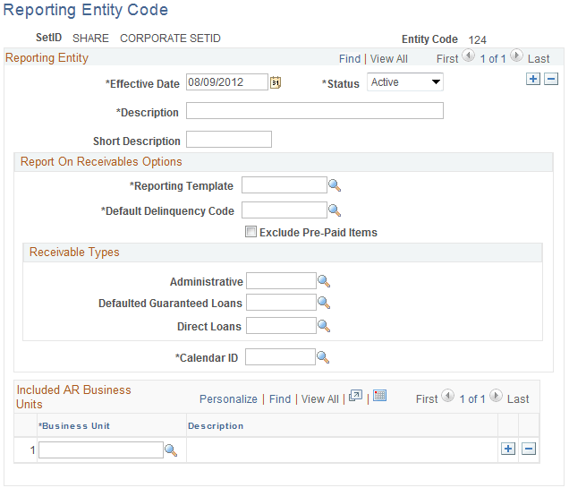

Use the Reporting Entity Code page (ENTITY_TBL) to define report entity codes for the government agencies or divisions to which the TROR is submitted.
The entity code component includes TROR reporting options. These reporting options enable users to set up and report behavior and map Receivable business units to the entity code.
Navigation:
This example illustrates the fields and controls on the Reporting Entity Code page. You can find definitions for the fields and controls later on this page.
The report entity code is unique for each reporting entity. The first two digits identify the agency, the next two digits identify the bureau, and the remaining digits identify the entity.
Field or Control |
Description |
Entity Code |
Enter the entity code for the reporting entity that you want to define. The first two digits identify the agency, the next two digits identify the bureau, and the remaining digits identify the entity. |
Reporting Template |
Select the TROR reporting template to use when generating the Treasury Report On Receivables based on the selection of this reporting entity code. |
Default Delinquency Code |
Select the delinquency code that you prefer as the default value for new receivables. |
Exclude Prepaid Items |
Select this check box if you want to exclude prepaid items on the Treasury Report on Receivables for this reporting entity code. |
Receivable Types |
Select the Receivable Types that identify a receivable as Administrative, Default Guaranteed Loans, and Direct Loans. The receivable type can be defined as any value in the system and is mapped from this entity code to the receivable type on the TROR. Note: Only one Receivable Type appears on a given report. |
Calendar ID |
Select the calendar that you want to apply to the generation of data for the Treasury Report on Receivables. The calendar ID that you select for the entity code determines the fiscal year and accounting periods that appear on the report. |
Included AR Business Units |
Select any business units that you want to include in the processing of the data for the Treasury Report on Receivables. An error message will display If the calendar ID for the selected business unit does not match the calendar ID selected for this reporting entity code. |

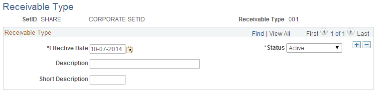

Use the Receivable Type page (REC_TYPE_TBL) to define codes that represent the loan types.
Navigation:
This example illustrates the fields and controls on the Receivable Type page.
The Receivable Type code identifies the loan as a direct loan, defaulted guaranteed loan, or noncredit receivable. This code appears at the top of the Treasury Report on Receivables report to identify the types of items for which amounts are included in the various report lines.

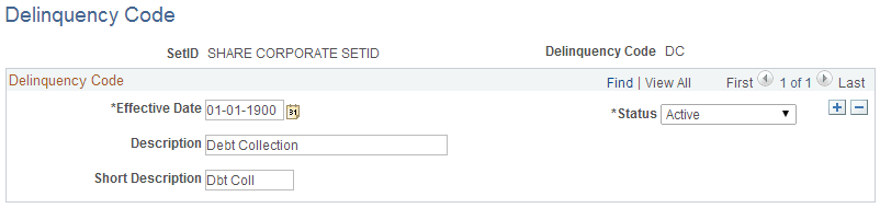

Use the Delinquency Code page (DELINQ_TBL) to define delinquency codes.
Navigation:
This example illustrates the fields and controls on the Delinquency Code page.
Be sure that the code values exactly match those in the list described earlier in this section.
