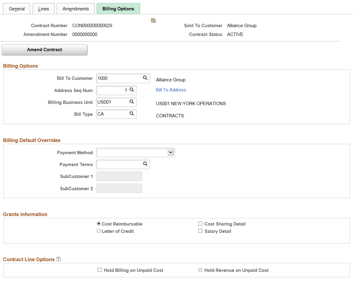

Use the Billing Options page (CA_HDR_BILLOPT) to enter billing option defaults for the contract.
These billing options appear by default on the billing plans created for contract lines within this contract. You can override these options at the billing plan level.
Navigation:
Select Billing Options in the Go To drop-down list box on any page in the contract component.
This example illustrates the fields and controls on the Billing Options Page. You can find definitions for the fields and controls later on this page.
