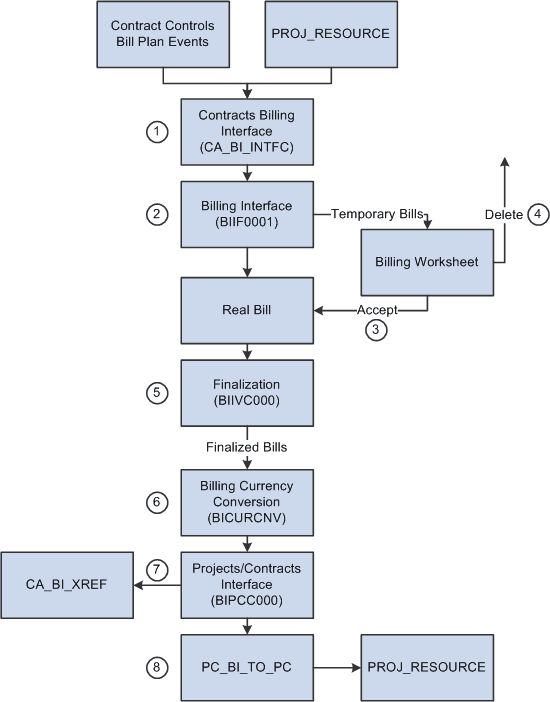

The numbers in the following flowchart correspond to the updates that occur to the PeopleSoft Contracts controls (billing plans and billing events), the Billing Cross-reference table (CA_BI_XREF), and the PeopleSoft Project Costing table (PROJ_RESOURCE).
Warning! It is not recommended for you to make any billing adjustments to the contract lines outside the PeopleSoft Contracts system (for example, in PeopleSoft Billing or PeopleSoft Project Costing), as these changes will not flow back into PeopleSoft Contracts.
Here is the billing flowchart:
Contracts billing process flow diagram
The billing process consists of these steps:
Run the Contracts Billing Interface process Contracts- and Project Costing-related billing activity to PeopleSoft Billing.
Run the Billing Interface process (BIIF0001) in PeopleSoft Billing to create temporary bills that you can work on in the billing worksheet.
The billing worksheet is a temporary work area where you can review and adjust resource lines that come from PeopleSoft Project Costing before you create an actual bill. For bill lines that are generated from fixed-amount contract lines, you can approve or delete the worksheet based on your review.
Approve the billing worksheet.
When you accept a billing worksheet, the system creates a real bill with an assigned invoice number and updates PeopleSoft Contracts and PeopleSoft Project Costing accordingly.
Delete the billing worksheet.
When you delete a billing worksheet, the system cancels the bill and updates PeopleSoft Contracts and PeopleSoft Project Costing accordingly.
Run the Finalization process (BIIVC000).
Run the Finalization process on the real bills that you have created. The Finalization process performs a variety of tasks, including calculating taxes, setting the invoice date, and calculating the due date.
Run the Billing Currency Conversion process (BICURCNV).
Billing Currency Conversion process (BICURCNV) must be run prior to running the Billing to Project Costing/Contracts Interface process (BIPCC000) to ensure that correct conversion rates are sent to project costing/contracts. For more information on Billing Currency Conversion process, see Running the Currency Conversion Process (BICURCNV). You must run the Billing Currency Conversion process prior to running the Billing to Project Costing/Contracts Interface process even if you are not using multiple currencies.
Run the Projects/Contracts Interface process (BIPCC000).
After you have run the Finalization process, you run the Projects/Contracts Interface process. This process updates PeopleSoft Contracts and PeopleSoft Project Costing with the finalized bill information from PeopleSoft Billing and updates the billing plan event statuses to event billed.
Run the Billing to Projects process (PC_BI_TO_PC).
Run the Billing to Projects process for rate-based contract lines to update PeopleSoft Project Costing tables with billing data.
Note: You can utilize streamlined billing to reduce the number of steps for invoicing bills. Streamlined billing enables you to process transactions from PeopleSoft Contracts to PeopleSoft Billing and back to PeopleSoft Contracts, with one job.

See Understanding the Relationship Between PeopleSoft Contracts and PeopleSoft Project Costing.
Rate Based Retainage Rows
For the as-incurred billing method, you can choose to withhold a portion of the billable amount for each transaction; this is referred to as a retainage. When the billing for these transactions is finalized, these new items (portion of the original) are written back to projects as BRT (analysis type) rows and may be handled in one of three ways, depending on the selection that you make for the Items previously held as Retainage option on the Billing Plan - Billing Plan General page:
Hold the items in PeopleSoft Project Costing.
Bill the items at a later date.
Write the items off at a later date.
If you choose to hold the items, the Contracts Billing Interface process ignores these rows.
If you choose to write off the items, the Contracts Billing Interface process sends the rows to PeopleSoft Billing with an analysis type of WTO.
If you choose to bill for the items, the items may or may not be applied against limits. How the system handles this is based on the setting that you define for the Apply Released Retainage field on the Installation Options - Contracts page. If you do not select the Apply Released Retainage field, then all rows are sent to PeopleSoft Billing with an analysis type of BIL. If you selected the Apply Released Retainage field, then each row is checked against the limit. If the row falls under the limit, the row is sent to PeopleSoft Billing as RRT; otherwise, the row is sent as over-the-limit (OLT).
