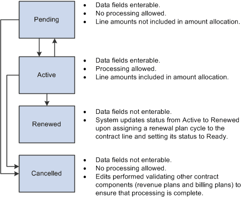

Contract Line Process Flow
The flow for the contract line status is basic:
The contract line status values can never move backwards—with the exception of moving an Active line to Pending on a contract with a Pending processing status.
Only the system can change the status to Renewed.
This diagram shows the flow between status values and functionality for each line status value:
The flow between status values and functionality for each line status value is showed
