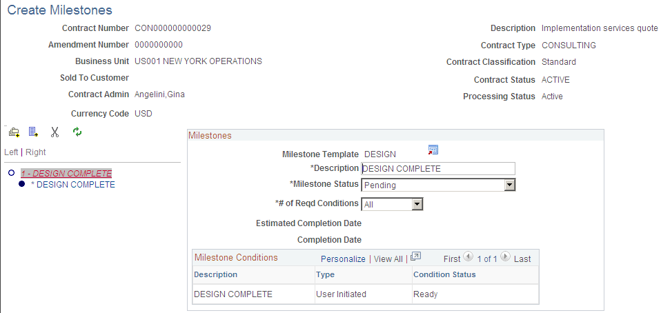

Use the Create Milestones page (CA_MS_ENTRY) to associate previously defined, generic milestone templates with a contract.
Review the milestone conditions that were established for the generic milestone template on which you based the contract-specific milestone. Edit existing conditions and define new contract-specific milestone conditions. Changes do not affect the generic milestone template.
Navigation:
This example illustrates the fields and controls on the Create Milestones page. You can find definitions for the fields and controls later on this page.
If milestones are already associated with the contract, when you access this page, the milestone tree and Milestones group box appear. If milestones are not associated with the contract, these items do not appear on the page. The Milestone page consists of several different functional areas, including:
Toolbar buttons.
Milestone tree and visual indicators.
Milestones group box.
Milestone Conditions group box.
Toolbar Buttons
Use these buttons to create, delete, and refresh milestones and milestone conditions:

Milestone Tree and Visual Indicators
Use the milestone tree to understand the structure of the milestones attached to the contract. In the tree, milestones appear at the highest level. Any attached milestone conditions are indented under each milestone. The Milestones or Milestone Conditions group box that appears on the page corresponds with the selected milestone or milestone condition in the tree.
Field or Control |
Description |
Appears next to milestone or milestone conditions that are in Pending status. |
Appears next to milestone or milestone conditions that are in Ready status. |
Appears next to milestone or milestone conditions that are in Completed status. |
Appears next to milestone or milestone conditions that are in Cancelled status. |
Note: An asterisk next to a milestone condition indicates that the milestone condition type is User Initiated. You must manually update the status of User Initiated milestones to Completed.

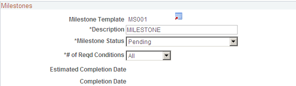

Milestones Group Box
Use the Milestones group box to change the milestone template, enter milestone completion dates, and so forth:
This example illustrates the fields and controls on the Create Milestones page: Milestones group box. You can find definitions for the fields and controls later on this page.
Field or Control |
Description |
Milestone Template |
Displays the milestone template name. Change the milestone template by clicking the Milestone Definition button. |
Click the Milestone Definition button to select a different milestone template. If you did not specify a type for the contract, the list of values contains all existing milestones. If you specified a contract type, then the list is limited to the milestones specified in CA_MS_DEFN_CT. If a milestone has no contract types, then it is applicable for all types by default. After selecting a new milestone template, click the Refresh button to update the milestone tree with the new milestone associated milestone conditions. |
Description |
Accept the default description or enter a contract-specific description. This enables you to easily take a generic milestone description (such as Product Delivery) and make it specific (such as AR Product Delivery). Note: It is recommended that when you use the same milestone template more than once on a contract, you give each instance of the milestone a unique description. This aids you when you are referencing specific milestones for billing and revenue recognition, where you must pick the milestone from a list. |
Milestone Status |
Select a milestone status. Values are: Pending: Milestones are not processed by the Milestone Processing Application Engine. Ready: Milestones are eligible for processing by the Milestone Processing Application Engine. Completed: The Milestone Processing Application Engine updates the milestone status to Completed after its conditions are met. Cancelled: Cancel a milestone by manually setting the milestone status to cancelled. |
Estimated Completion Date |
Displays the estimated completion date, which is a system-calculated value based on the milestone conditions. The system uses the selection in the # of Reqd Conditions field to determine the estimated completion date. If the selection is Any, then the system chooses the earliest estimated completion date assigned to a milestone condition. If the selection is All, then the system chooses the last estimated completion date assigned to a milestone condition. The system takes into account any value in the Days Lag field. |
Completion Date |
The Milestone Process Application Engine (CA_MS_PRCS) updates this field with the milestone completion date. This field is display-only. Note: This field is populated by the Milestone Process when it updates the status of the milestone to complete. |

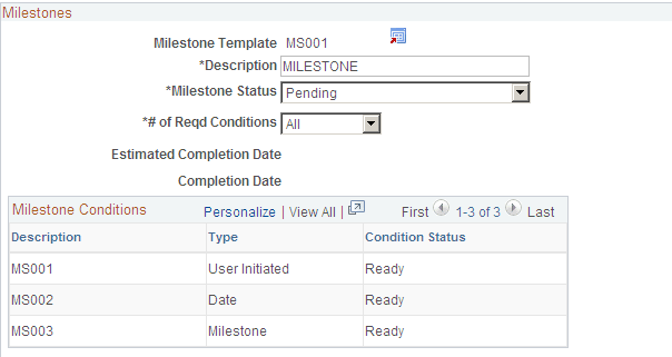

Milestone Conditions Group Box
The fields that appear in this group box depend on the milestone condition type:
This example illustrates the fields and controls on the Create Milestones page: Milestone Conditions group box. You can find definitions for the fields and controls later on this page.
Field or Control |
Description |
Description |
Condition description of the milestone template. Accept the default description or enter a contract-specific description. |
Type |
Select a milestone condition type of Date, Milestone, SQL, or User Initiated. |
Completion Date |
For Date milestone condition types, enter the completion date. The milestone condition is complete when the system date reaches the completion date. For User Initiated milestone condition types, the completion date is an optional field. The milestone condition is complete when you click the Mark Complete button. If you do not specify a completion date prior to selecting the Mark Complete button, when you select Mark Complete,the system records the completion date as the current date. |
(Optional) Enter an estimated completion date. This date has no effect on milestone processing. The field is available for milestones with User Initiated and SQL milestone condition types. |
Mark Complete |
Click to manually set the status of a User Initiated milestone condition type to Completed. This field is available only for User Initiated milestone condition types. Note: When you click the Mark Complete button, the system changes the Milestone Condition Status to Completed and the value in the Completion Date field is set to any date specified by you prior to clicking the Mark Complete button. If you did not specify a completion date prior to selecting the Mark Complete button, the system records the current date. |
Milestone Source |
Select the milestone source for milestones with a condition type of Milestone. Values include: Contracts: Milestone condition is associated with a milestone that you defined in PeopleSoft Contracts. When selecting Contracts, you must complete the Prerequisite Milestone and Days Lag fields. Projects: Milestone condition is associated with a milestone that you defined in PeopleSoft Project Costing. When you select Projects, you must complete the Days Lag, PC Business Unit, Project ID, Activity ID, and Activity Status fields. |
Prerequisite Milestone |
Displays the milestone template and milestone sequence (milestone number) to which you are linking this condition. The list of values contains all milestones that are attached to this contract. This field is available for milestones with a Milestone condition type and a milestone source of Contracts. Note: The milestone number, also known as the sequence number, does not affect the order in which milestones or milestone conditions are processed. It's a unique number assigned by the system to enable you to use the same milestone template more than once on a contract. |
SQL Statement |
If you selected a milestone condition type of SQL, then you must enter a SQL statement. Enter the SQL statement representing the condition that the system should test. Precede the SQL statement by WHERE, and ensure that it makes sense with the surrounding SQL. |
