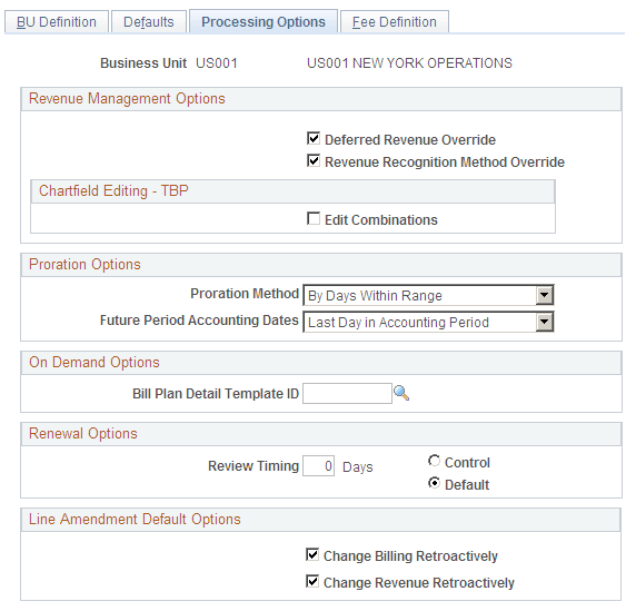

Use the Contracts Definition - Processing Options page (BUS_UNIT_OPT_CA2) to select the Edit Combinations check box if you want the Accounting Rules process (PSA_ACCTGGL) to run combination editing.
This step is optional. For recurring transactions, define the parameters in the Proration Options group box so that the PeopleSoft Transaction Billing Processor can process the PeopleSoft CRM recurring transactions. For on-demand transactions, select a bill plan detail template ID to use to override the fields on the billing plan (optional). If you select a template on this page, when the billing plan is created, the billing plan detail template overrides the corresponding fields on the billing plan.
Navigation:
ChartField Editing - CRM
Field or Control |
Description |
Edit Combinations |
Select this check box to indicate that you want the Accounting Rules process (PSA_ACCTGGL) to run combination editing. |
Note: This step is optional. If you want to use combination editing, set up the ChartField combination editing rules in PeopleSoft General Ledger.

Use the Contracts Definition - Processing Options page (BUS_UNIT_TBL_CA2) to define processing attributes to incorporate flexibility and automation in your PeopleSoft Contracts system when managing revenue, or performing billing and revenue credits and adjustments.
Navigation:
This example illustrates the fields and controls on the Contracts Definition - Processing Options page. You can find definitions for the fields and controls later on this page.
Proration Options
Field or Control |
Description |
Proration Method |
Values are:
Future Period Accounting Dates |
Values are:
Note: Use this page when setting up recurring transactions from PeopleSoft CRM. This page is not used for one-time and on-demand transactions.

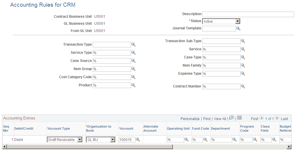

Use the Accounting Rules for CRM page (CA_ACCT_RULES) to define the accounting rules to apply to PeopleSoft CRM transactions.
Navigation:
This example illustrates the fields and controls on the Accounting Rules for CRM page. You can find definitions for the fields and controls later on this page.
Note: You can select or deselect combination editing for the Accounting Rules process (PSA_ACCTGGL) on the Contracts Definition - Processing Options page.
Note: Wildcarding—use of the percent sign symbol to indicate any possibility (%)—is supported on this page. Partial wildcarding—the use of alphanumeric symbols in combination with the percent sign symbol—is not.
The fields and functionality of this page are similar to those on the Accounting Rules page in the PeopleSoft Project Costing documentation.
Field or Control |
Description |
Contract Business Unit |
Displays the PeopleSoft Contracts business unit. |
Description |
Enter a description for the accounting rules. |
GL Business Unit (PeopleSoft General Ledger business unit) |
Displays the PeopleSoft General Ledger business unit (GLBU) of the sending application. The GLBU defines where the accounting entry is booked. This field is display-only. |
Status |
Displays the status of the accounting rules. The user controls this status. |
From GL Unit (from general ledger unit) |
Displays the source PeopleSoft General Ledger business unit. With the exception of employee-related transactions (service orders), this value should always be the same as the value in the GL Business Unit field. This field is display-only. This field applies to PeopleSoft FieldService and PeopleSoft Support only. This flexibility exists to enable cross-charging revenue to the PeopleSoft General Ledger business unit of the resource who performed the service. |
Journal Template |
Enter the journal template to attach to accounting entries when they are sent to the PeopleSoft General Ledger system. |
Copy Accounting Entries to |
Click to copy the accounting entries that you specify in the Accounting Entries group box for use with another set of header criteria. |
Accounting Entries
Use this grid to define the accounting debits and credits to create for the specified PeopleSoft CRM transaction. There must be an equal number of debits and credits. When defining accounting rules for billable activity for one-time transactions, you must specify one Contract Liability) accounting distribution. This accounting distribution is stamped on the row when it is sent to PeopleSoft Billing. If you do not establish an Contract Asset, the system does not send the row to PeopleSoft Billing.
During the Accounting Rules process (PSA_ACCTGGL), all transactions are converted to currency based on the PeopleSoft General Ledger currency.
Note: The As Incurred revenue recognition process (PSA_ACCTGGL) is only applicable to one-time transactions.
Field or Control |
Description |
Seq Nbr (sequence number) |
Displays the sequence in which these accounting lines are applied. The sequence number groups the debit and credit together and is used to determine whether interunit entries should be created. |
Debit/Credit |
Displays whether this accounting line is a debit or credit. |
Account Type |
Select the type of accounting entry. |
Billing Business Unit |
Enter a business unit that matches the business unit entered in the GL Business Unit field. This ensures that the receivables accounting entries are booked to the same PeopleSoft General Ledger business unit as the contract asset account. This field appears only if the account type is Contract Asset. |
Organization to Book |
Values are:
