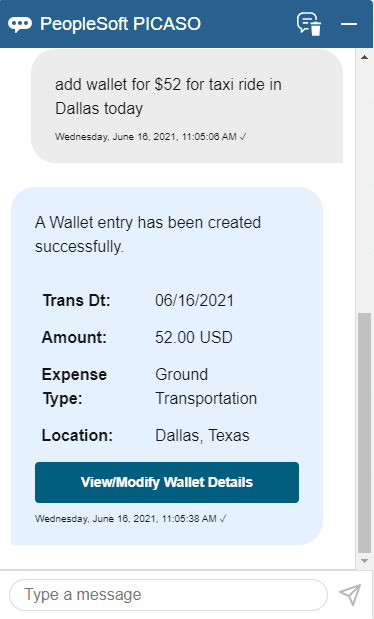

This topic explains how to create a wallet entry using the Expenses Skill and save it to the Wallet Entry page.
Steps to creating a wallet entry:
You enter this text, "add wallet for $52 for taxi ride in Dallas today".
The Expenses Skill response, "A Wallet entry has been created successfully" and provides this information:
Trans Dt: <mm/dd/yyy>
Amount: 52.00 USD
Expense Type: Ground Transportation
Location: Dallas, Texas
This example illustrates the fields and controls after a Wallet transaction is created successfully.

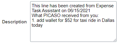

Use the Wallet Entry page to view or modify entries after the Expenses Skill confirms that the entry is created.
The Wallet Entry Page provides this information in the Description field. This description captures all information entered into the Expenses Skill.
This example illustrates the Description field on the Wallet Entry page after an entry is saved.
