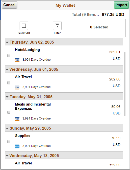

Use the My Wallet page (EX_TRANS_DTL_SCF) to import wallet entries into an expense report.
Navigation:
Small form factor: . Select the Create Expense Report button.
Large form factor:
From the Expense Report page, select the Add from My Wallet button.
Note: The number indicated in the Add from My Wallet button is the number of available wallet entries that can be imported into an expense report.
This example illustrates the fields and controls on the My Wallet page for a smartphone.
Select the wallet entries, and then select the Import button. The selected wallet entries including the file attachment will be imported into the current expense report. A confirmation message is displayed after you import the wallet entries into the expense report.
The icon on My Wallet page indicate the source of the transaction such as Text Message, Manual Entry, and Credit Card upload.
Note: You can also import wallet entries using the Wallet action button on the Expense Details page.

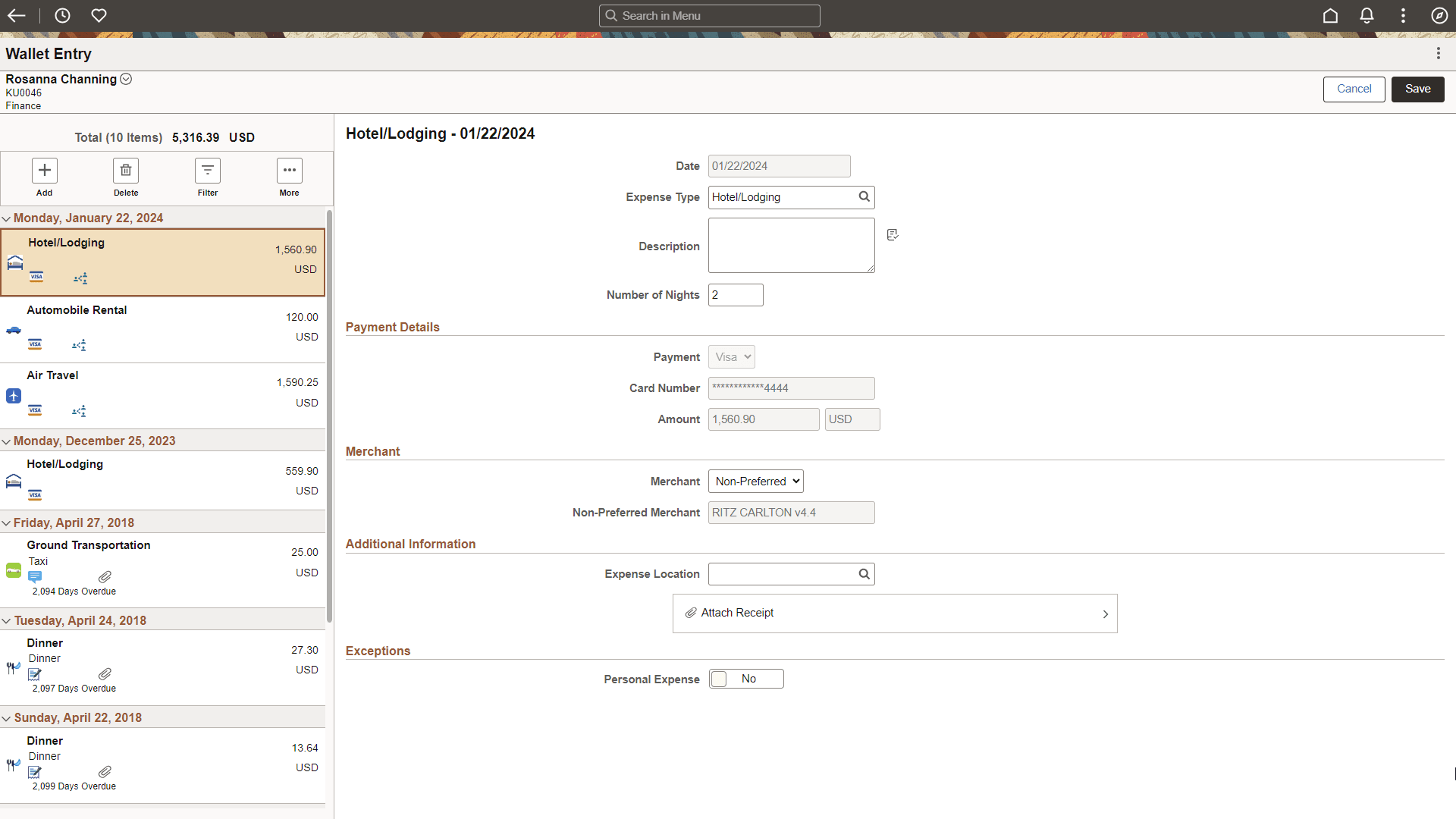

Use the Wallet Entry page (EX_TRANS_LN_FL) to add, modify, or to view a list of outstanding wallet entries that have not been imported into an expense report.
Navigation:
Fluid Homepage:
This example illustrates the fields and controls on the Wallet Entry page.
This page provides a listing of all outstanding wallet entries that have not yet been imported into an expense report for reimbursement. Transaction data can come from credit card feeds and the Add Quick Expense in Fluid Expenses. The amount is displayed in the base currency of the employee’s business unit.
You can review and edit transactions prior to importing them into an expense report, as well as delete one or many transactions. Credit card feed transactions cannot be edited or deleted here.
When adding an new entry to your wallet, fields are dynamically displayed on the page based on the expense type selected. For example, when you select Hotel/Lodging, the Merchant fields appear (some exceptions apply). For more information, see Expense Types 1 Page.
When using a tablet or a desktop, when you complete your entry and select Save, the left panel updates the new expense line with the entered expense type.
You can save a Wallet entry without entering any data. You can fill in the fields later, or fill in the fields when you import the wallet entry to the expense report.
Field or Control |
Description |
Date |
Displays the transaction date. The current date is the default value. |
Expense Type |
Select an expense type to add an expense item. The system displays the additional fields associated with the expense type after this field is selected. For more information, see "Selecting Expense Types using PeopleSoft Fluid" in Expense Entry Page After selecting the expense type, the user default values are populated based on the user profile set up for the employee in the Employee Profile - User Defaults Page. |
Description |
Enter free text in this field. |
Originating Location and Destination Location |
If your expense type is Automobile Mileage, then you must enter the originating and destination locations. In the Originating Location field, select the location from where you began your business travel. PeopleSoft Expenses prepopulates this field if you enter an originating location on the Employee Profile - User Defaults Page. If this wallet entry was imported using the load data process, these fields are also imported into the expense report. |
Payment Details |
Select a payment method. If a Payment Type default is specified on the Employee Profile - User Defaults Page, that default appears in the Payment field. |
Card Numer |
If the payment is made using a card, enter the card details. |
Amount |
Enter the amount of the expense transaction and select the transaction currency. The currency default value is the same here as is specified on the Employee Profile - User Defaults Page. If you submit expenses in foreign currency, the system automatically displays the currency exchange rate and converts the currency to the employee’s base currency. You can override the system-supplied exchange rate. Use the Reset Exchange Rate icon to change the overridden exchange rate to the system-defined exchange rate. |
Attach Receipt |
Upload an existing file(s) or capture receipt image for the expense. For more information, see Attaching Receipts in PeopleSoft Fluid You can upload multiple files at a time depending on the configured attachment upload limit. To configure attachment upload limit, see Installation Options - Multiple Attachments Page. |
Merchant |
Indicates the transaction supplier. This field displays only if Merchant is selected as a required field for the expense type selected. See Setting Up Expense Types If a non-preferred merchant is selected, you must provide a justification for not using the company’s selected preferred merchant. |
Expense Location or Originating Location |
Select the location where you incurred the expense. This field is displayed if Location or Originating Location is selected as required fields for the expense type selected. See Setting Up Expense Types |
Personal Expense |
Select to indicate that the transaction is a non-reimbursable expense. If the transaction is from a manually entered expense or laoded using a credit card feed process, and the expense type is defined as non-reimbursable, then the Personal Expense option is set to Yes and cannot be changed. Rules for the Personal Expense selection:
For example: A user selects an enhanced data row as a personal expense. This row is not non-reimbursable from the credit card feed. If they add it to an expense report and delete it, when returning to the Wallet, the value is still a personal expense. It does not revert to the original credit card feed value. |
Receipt Breakdown |
Displays the detail or summary data that is imported from credit card suppliers for the Hotel/Lodging expense type. The level of data (detail or summary) is determined by the Credit Card Import Hierarchy option on the Corporate Card Supplier Page and the agreement that the hotel supplier has with the credit card supplier. This section is hidden if there is no data. |
