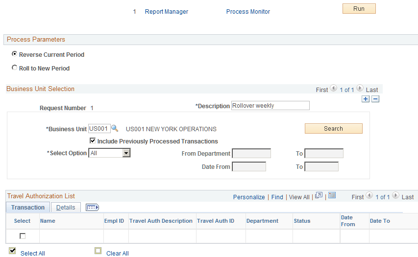

Use the Rollover Travel Authorization page (EX_BGTCHK_TAUTH) to select travel authorizations to roll encumbrances over to a new budget period.
Navigation:
This example illustrates the fields and controls on the Rollover Travel Authorization page. You can find definitions for the fields and controls later on this page.
Process Parameters
Field or Control |
Description |
Reverse Current Period |
Select to reverse out encumbrances from the prior period. |
Roll to New Period |
Select to re-encumber funds in a new period. If this option is selected, PeopleSoft Expenses displays the Change Accounting Date To and Change Budget Date To fields. |
Business Unit Selection
Field or Control |
Description |
Description |
Enter a description of the defined set of parameters. |
Business Unit |
Select a valid business unit. Note: PeopleSoft Expenses lists all general ledger business units, not just the business units enabled for commitment control. This ensures that PeopleSoft Expenses retrieves all eligible travel authorizations, even when the general ledger business unit on the header record is not enabled for commitment control but the business unit on the associated distribution record is enabled. |
Search |
Click to retrieve transactions based on the criteria specified. If you do not enter any criteria, PeopleSoft Expenses retrieves and displays all eligible transactions. |
Include Previously Processed Transactions |
Select to include transactions that were previously processed for rollover. |
Select Option |
Select All to retrieve all eligible travel authorizations. Select Some to select by business unit, department, or date criteria. |
From Department and To |
Enter a value as criteria to select travel authorizations. The system retrieves all travel authorizations with department numbers that fall within the specified range in the criteria. If you leave these fields blank, the system retrieves all departments. Select a specific department by entering a department ID in the From Department field and leaving the To field blank. Note: The system searches on the employee's department ID as of the time you run the process, not the distribution department. |
Date From and To |
Enter a value as criteria to select travel authorizations. The system retrieves all travel authorizations with dates that fall within the dates specified in the criteria. |
Change Accounting Date To |
Enter a new accounting date to roll travel authorizations to. PeopleSoft Expenses displays this field only if you selected Roll to a New Period and populates the field with the system date by default. The Budget Processor process validates the accounting date against the general ledger open period. If the new fiscal year is not open, the system prevents you from rolling over the travel authorizations to the new period. Warning! PeopleSoft Expenses does not validate the date that you enter other than to ensure that the period is open. If you enter an incorrect date and run the Budget Processor process, you must run the process to reverse the entries. |
Change Budget Date To |
Select to enable the date field, where you can enter a new budget date. PeopleSoft Expenses displays this field only if you selected Roll to a New Period and populates the budget date field with the accounting date by default. The system applies the budget date that you entered to the distribution lines for all the travel authorizations selected for the business unit. If this option is not selected, the budget date on the distribution record is unchanged. |
