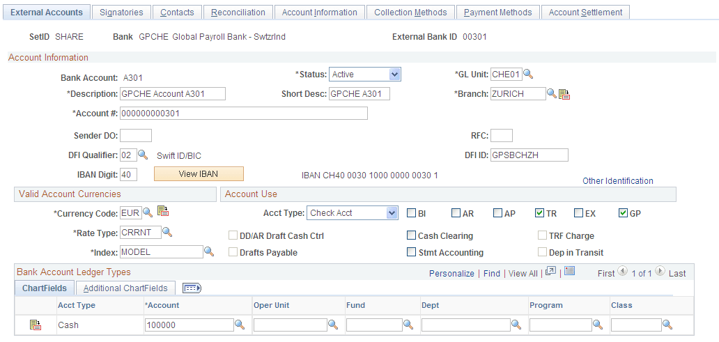

Set up external bank accounts to be used by Global Payroll.
The GP check box on the External Accounts Page () designates an account for use by Global Payroll for a SEPA credit transfer (SEPA_CT).
This example illustrates the fields and controls on the External Accounts page designated for Global Payroll. You can find definitions for the fields and controls later on this page.
Account data, including bank account number, from Financial Gateway must match the accounts defined in Global Payroll. IBAN and BIC have to be identical on both HCM and FMS instances for a given bank and account.

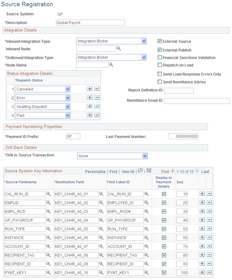

Define a subsystem or transaction source to identify Global Payroll as the originator of the payment.
Although the GP source system is registered as system data, you assign attributes including payment status and payment numbering properties on the Source Registration page (Financial Gateway, Administration, Source Registration). For integration with Global Payroll, Integration Broker is selected to pass data between the source application and Financial Gateway.
This example illustrates the fields and controls on the Source Registration page for Global Payroll. You can find definitions for the fields and controls later on this page.
Note: Financial Gateway delivers the GP source system with an additional override payment status option. On the Override Payment Status Page (), you can override erroneous payments with an Error status to mark them as Canceled so there is closure on the business process for that payment.
See Registering a Source Application with Financial Gateway.
(Optional) Set up load error responses.
You can choose an option on the Source Registration page to receive errors only during the Payment Load process. The default is to receive all response messages.
