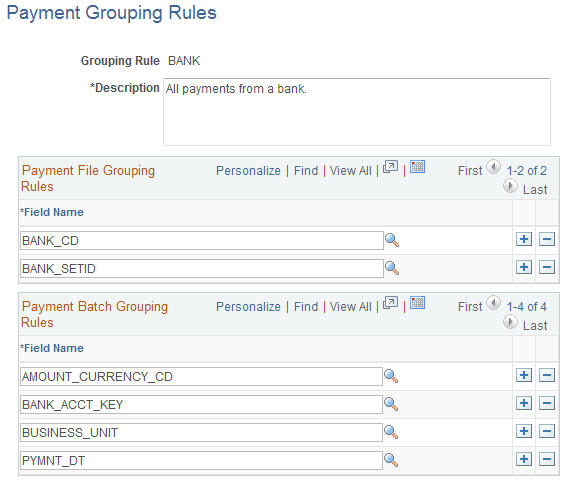

Use the Payment Grouping Rules page (PMT_CHUNK_DEFN) to define fields to include for a specified payment grouping rule.
Navigation:
This example illustrates the fields and controls on the Payment Grouping Rules page.
Each payment layout specification defines rules for grouping payments into the file. Grouping rules determine how payments are grouped together into payment files. Certain layouts require a different file for every payment, and other layouts require a separate file for each different business date in a file. For example, the SWIFT MT103 payment layout requires that only one payment exist in a file; therefore, the associated grouping rule is SINGLEPAYMENT.
Other layouts have different rules. For example, CCD+ files can contain payments from multiple accounts and multiple processing dates, so the grouping rule is BANK, and payments for this bank can be included in the same file. For layouts requiring payments to be processed on the same day, you can use the BANKDATE file grouping rule. You can change file grouping rules to accommodate a layout with a specific bank's requirement. To define a file grouping rule, enter the fields to group for a payment type.
There are essentially three layers of filtering that determines how payments are grouped together:
Initially the system groups all payments by bank code, SetID, payment layout, and payment method.
This level of filtering is hard coded in the system and cannot be changed or overwritten.
Next, the payment file grouping rules, entered in the top grid, further define how the payments are grouped together, thus determining how many payment files are ultimately created during the payment load process.
Finally, the payment batch grouping rules define how payments within a file are grouped together.
PeopleSoft delivers the following grouping rules:
Payment File Grouping Rule |
Description |
BANK |
All payments from a bank. |
BANKACCOUNT |
All payments from a specified bank account. |
BANKACCOUNTDATE |
All payments from a bank account and on a payment date. |
BANKDATE |
All payments from a bank and on a payment date. |
SINGLEPAYMENT |
One payment per file. |

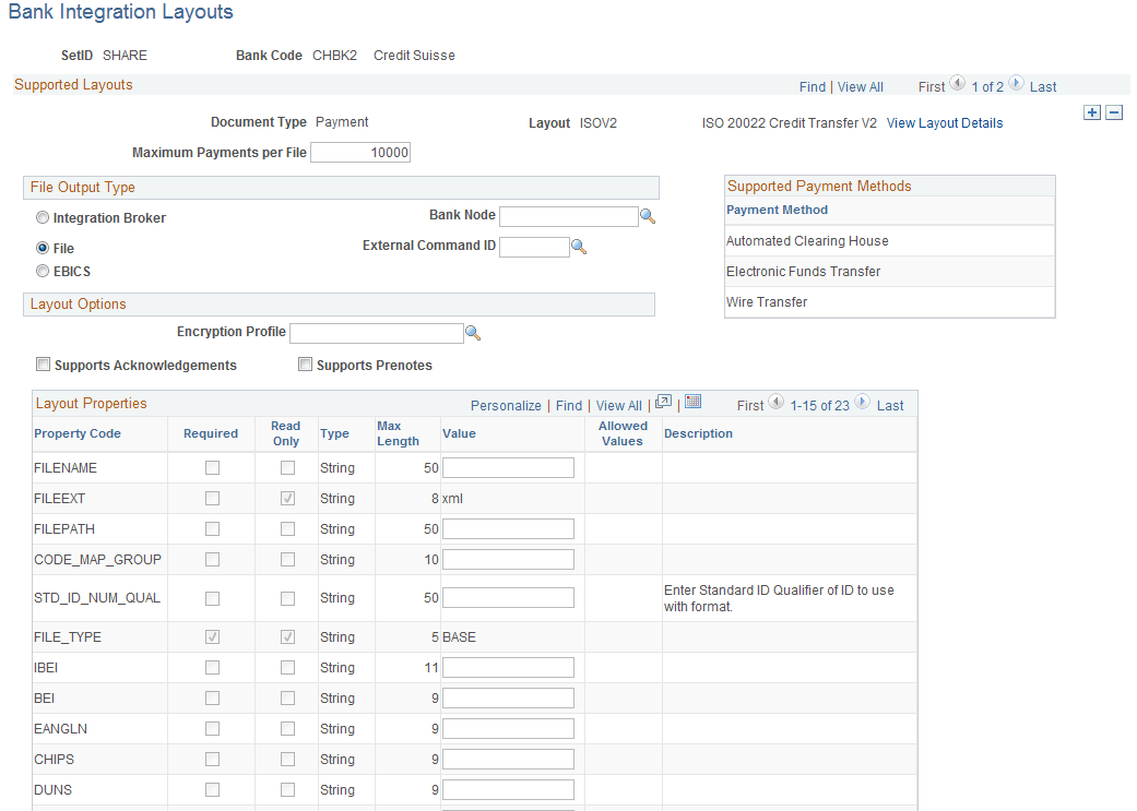

Use the Bank Integration Layouts page (BANK_INTEGRATION) to define layouts and transformation programs for a specific bank.
Navigation:
This example illustrates the fields and controls on the Bank Integration Layouts page. You can find definitions for the fields and controls later on this page.
Field or Control |
Description |
Layout |
Select a layout from the Layout Catalog to enable for this bank. Values that are defined for the layout automatically populate the Layout Properties region. |
View Layout Details |
Click to access the Layout Catalog page and view details of the payment layout. |
File Output Type
Field or Control |
Description |
Integration Broker |
Select to publish the layout as an IP message to the Integration Broker. |
File |
Select to send the layout to a file. Requires that the FILENAME, FILEEXT, and FILEPATH layout properties be defined. |
EBICS |
Select to indicate this layout follows EBICS protocol requirements. For more information about using the EBICS protocol for SEPA payments, see Understanding SEPA. |
Bank Node |
The node to which the Integration Broker Node message will be published. Required if Message output type is selected. |
External Command ID (optional) |
An option that is active only if the output layout type is File. This is the external command to carry out after the file is sent. External commands are a way to carry out a third-party communication or security toolkit. They enable the output FILEPATH and FILENAME to be passed to a third-party application to initiate additional processing. |
Layout Options
Field or Control |
Description |
Encryption Profile (optional) |
Select an encryption profile to apply to this payment layout's data before sending to a message or file. The profile must be one that was designed to encrypt or digitally sign files. Use the Encryption Profile page (ENCRYPTION_PRFL) () to define encryption standards to be used to protect data when communicating with banks and determine algorithms and store public and private keys that are used in encryption. See the product documentation for PeopleTools: Security Administration. |
Supports Acknowledgments |
Select to enable functionality for receiving files containing payment acknowledgment messages from the specified bank. When payments are dispatched for this bank and layout, they will be set to a status of "Dispatched to Bank." Once a payment acknowledgement is received from the bank, the status to set to "Paid." Note: Because no successful payment acknowledgments are sent for ACH payments, the Supports Acknowledgments functionality is never enabled for them. Therefore, when ACH payments are dispatched, the status of the payment changes to Paid, not to Dispatched to Bank. The only types of acknowledgments for ACH payments are ACH Returns and ACH Notifications of Change (NOC), which are the results of payment errors. In the case of ACH Returns, once they are imported into Financial Gateway, the payment status is reset from Paid to Error. ACH NOCs are statements of payment errors that are minor in nature and did not prevent the payment from being processed. Hence, the payment status does not change in Financial Gateway for and ACH NOC. The details of the error for ACH Returns and NOCs can be viewed from the Acknowledgment Files page. |
Supports Prenotes |
Select to enable the functionality for creating and processing zero-dollar, prenotification payment files using this layout. |
Supported Payment Methods
This group box displays payment methods that are supported by this layout.
Layout Properties
A payment layout can have a number of layout properties. Three layout properties are available, however, that all payment layouts contain. This table provides examples of how to set up each of them.
Field |
Description |
FILENAME |
Determines the filename when data are sent to a file or published into the Integration Broker. You can leave this property blank and the default will be BANKNAME + FILEID, or you can override and create your own naming convention. For example:
At runtime the FILEID
The date bind value
is flexible and can be altered to change the date format. Refer to
the PeopleTools PeopleCode documentation on the For another example:
At runtime equals:
FILEEXT |
File extension to add to the filename. Do not include a dot (.) in this field; the system will automatically add one between FILENAME and FILEEXT. |
FILEPATH |
The output directory to which the files are written. If this field is left blank, the system will send it to the default Process Scheduler file output location. Use this option only when layouts have an output type of File. The value must end in a back slash or forward slash (\ or /), depending on your operating system. For example, using Windows, "c:\temp" is invalid; it must be "c:\temp\". |

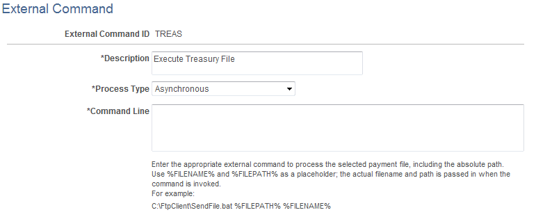

Use the External Command page (PMT_EXT_COMM_PG) to define command line information to carry out an external toolkit.
Optional if output type is File. This is the external command to carry out after the file is output. This enables you to integrate with third-party toolkits (such as security and communications toolkits) and define command parameters that call executable files, batch files, and command-line functions.
Navigation:
This example illustrates the fields and controls on the External Command page. You can find definitions for the fields and controls later on this page.
Optional if output type is file. This is the external command to execute after the file is created. External commands are a way to execute a third-party communication or security toolkit. They allow the output Filepath and Filename to be passed to a third party to initiate additional processing.
Field or Control |
Description |
Process Type |
Select a value:
Command Line |
Enter the actual command line code for the system to perform at runtime. External commands can contain two bind variables, %FILENAME% and %FILEPATH%. At system runtime, these bind variables are bonded with the location of the output file for the external command to process. |
