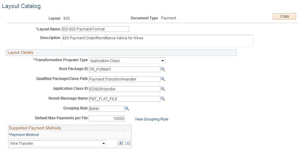

Layout Catalog
The Layout Catalog is a repository of information that is used for establishing how data should be formatted when processing bank statements, payments, and payment acknowledgements.

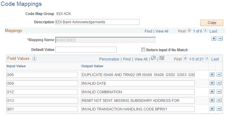

Code Mappings
For Bank Statement Import processing, you map external bank codes to their internal PeopleSoft equivalents to ensure efficient statement processing.
For Dispatch Payment processing, the Code Mappings page is used to associate PeopleSoft input code values with external bank output code values.

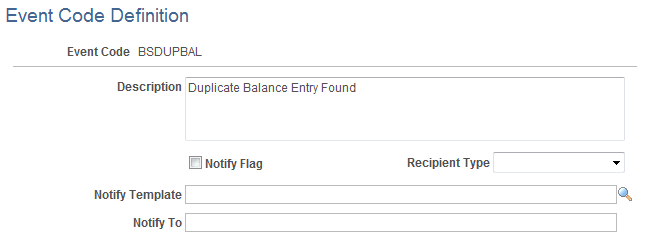

(Optional) Event Code Definition
You can setup events that can occur during Bank Statement Import and Dispatch Payment processing so that interested parties will be notified by email of those events.

The Layout Catalog is the central repository for information regarding all supported bank payment, payment acknowledgment, and bank statement layouts. After a layout is added to this component, it is available for use within the system. The component contains all the information about a layout—such as the transformation Application Engine program or Application Class that contains the logic to process the layout—that the system needs at setup and runtime. This component can be configured to meet each bank's specific formatting needs.
Note: PeopleSoft also provides additional miscellaneous layouts in the layout catalog that are used for importing various kinds of data.
See Layout Catalog Page.

Code Mappings enable you to define the mappings between external system codes with their equivalent internal PeopleSoft codes. For example, PeopleSoft stores 03 account types as checking accounts, and the required code for the EDI 820 bank statement layout is DA for deposit account. Code mappings are used to map these hard-coded field values to each other so that the transformation program component can use them. This allows a single transformation program to be used across multiple banks even though the program may need different code mappings.
Code mappings are most useful for fields that may change for every bank. Bank statement processing uses mappings for three fields: bank statement codes, reconciliation or "recon" codes, and statement activity types. For example, a bank identifies certain miscellaneous fees with the numeric code 564. If you define it as a Bank Fee, you can assign the input value of 564 to the output value of BKFEE. Other banks may use a different value to identify bank fee.
See Defining Statement Activities.
There are three levels to the code mapping data-structure hierarchy:
Code Map Group: The highest level, this is a container for all the fields for a given code map set. For instance, a code map group could represent all the code mappings for a particular bank.
Code Map Header: The second level, this represents a particular field for which the transformation Application Engine obtains the code map.
Code Map Items: The items contain all the possible input and output values for a particular field or header.

Use the Layout Catalog page (PMT_FORMAT_CATLOG) to create new or modify existing bank statement, payment, and payment acknowledgment layouts by defining transformation processing details, payment methods, parameters, and properties.
Navigation:
This example illustrates the fields and controls on the Layout Catalog page (1 of 2). You can find definitions for the fields and controls later on this page.
This example illustrates the fields and controls on the Layout Catalog page (2 of 2). You can find definitions for the fields and controls later on this page.
Define the file layouts, output type, and integration options that a particular bank supports. The catalog stores information about the layout, the program name containing the logic to generate or process the layout, and additional required setup or processing parameters that the layout requires.
If the bank does not support any of the delivered layouts or has a modified version of a delivered layout, you can create a new layout or edit a delivered layout. After a new or modified layout is added to the Layout Catalog, it is available for use in the system.
If you are adding new layouts or editing existing layouts for an organization's payment processing requirements, you must first create the new layout before you can continue this setup procedure. Follow the procedures to create a new layout that are outlined in the sections Defining Payment Grouping Rules, Defining Code Mappings for Banks Statements, Payments, and Payment Acknowledgments, and Creating Payment Layouts. Then add the new layout to the Layout Catalog.
See Understanding the Layout Catalog.
See Code Mappings Page.
Layout Details
Field or Control |
Description |
Transformation Program Type |
Select the method used to create or process a file layout. The options are:
For payments, this transformation program will process the PAYMENT_DISPATCH IP into a payment file layout. For bank statements, this transformation will process a bank-statement file layout into the BANK_STATEMENT_LOAD or BANK_ACCT_ANALYSIS_LOAD IP. |
Report Name |
Select the BI Publisher report name used to generate the payment file. This field appears only if BI Publisher is selected in the Transformation Program Type field. |
Source Document Name |
Select the source document used to map the PAYMENT_DISPATCH IP to the BI Publisher template. The source is a message object with the name IBY_PPIOUT_1_0. This field appears only if BI Publisher is selected in the Transformation Program Type field. |
Root Package ID |
Enter an application class package name. This field appears only if Application Class is selected as the transformation type. This value is delivered for integration with other PeopleSoft source applications. |
Qualified Package/Class Path |
Application Class ID |
This field appears only if Application Class is selected as an outbound integration type. This value is delivered for integration with other PeopleSoft source applications. |
Result Message Name |
This field is used during communication with the Integration Broker. It is the name of the message that publishes the file layouts to the Integration Broker. For example, many of the payment layouts are delivered with the PMT_FLAT_FILE message. This means that the file layout will be published into the Integration Broker under the message name PMT_FLAT_FILE. In the message monitor, you will see instances of the PMT_FLAT_FILE message. This value can be changed to any unstructured message to help distinguish different layouts in the Integration Broker and control the communication properties for a message. When communicating with a bank's FTP server, for example, you may want files to be sent to different directories. For example, if you use the EDI 820 layout for wires and the CCD+ layout for ACH payments with the same bank, you may want to create a new message called PMT_CCD_FILE and set it as the Result Message Name for the CCD+ layout. In the Integration Broker, you can then assign communication properties to the PMT_FLAT_FILE and then assign different communication properties to the PMT_CCD_FILE. If both layouts were communicated under the same message name, you could only specify one set of communication properties or one directory in this case. For payment acknowledgments, the required message is PAYMENT_ACKNOWLEDGE. For bank statements, this field displays the name of the output IP message from the transformation program. For all delivered bank statement layouts except EDI 822, the IP message is BANK_STATEMENT_LOAD_VERSION_2. Bank statement layout EDI 822 uses the IP message BANK_ACCT_ANALYSIS_LOAD. |
Grouping Rule |
This field appears only for payment layouts. Specify a payment grouping rule for the layout. Only one grouping rule can be applied to a payment layout. |
Default Max Payment Per File |
Enter the maximum number of payments allowed in a payment file of this type. This field appears only for payment layouts. |
Supported Payment Methods
This group box appears only for payment layouts and is used for defining the specific payment methods that are supported by the payment layout.
Select a layout payment method. Values are:
Automated Clearing House
Direct Debit
Electronic Funds Transfer
Wire Transfer
Payment Card
See the payment layout table for a list of delivered layouts and their corresponding payment methods.
Layout Properties

Use the Code Mappings page (TR_CODE_MAPPINGS) to define input and output values for mappings of a selected code map group.
Navigation:
This example illustrates the fields and controls on the Code Mappings page. You can find definitions for the fields and controls later on this page.
This page enables you to define the mapping between external bank codes with their equivalent internal PeopleSoft codes for both bank statement and bank payment processing.
Bank statement processing uses mappings for three fields: Bank Statement Codes, Reconciliation Codes, and Statement Activity Types.
For example, a financial organization identifies certain miscellaneous fees with the numeric code 564. If you define a statement activity type of Bank Fee (BNKFEE), you can assign the input value of 564 to the output value of BNKFEE.
Field or Control |
Description |
Copy |
Click to create a new mapping group based on the parameters of the current, code map group. |
Mapping Name |
Enter a mapping name. |
Default Value |
Enter a default value for the specific map. The system uses this defined default value if it cannot match the existing mapping input value and you do not select the Return Input if No Match check box. |
Return Input if No Match |
Select to indicate that the system should use the input value as the map-to value if the system cannot match the existing mapping-input value with a defined input value. |
Field Values |
Enter the Input Values and the corresponding Output Values to which they are to be mapped. For bank statement processing, the Input Values are the external bank codes, and the Output Values are the PeopleSoft codes. For bank payments, the Input Values are the PeopleSoft codes, and the Output Values are the external bank codes. |
Use the Event Code Definition page (TR_EVENT_CD_DEF_PG) to enter codes for system events, and define actions for the system to perform when they occur.
Navigation:
This example illustrates the fields and controls on the Event Code Definition page. You can find definitions for the fields and controls later on this page.
Field or Control |
Description |
Notify Flag |
Select for the system to send an email or workflow message to the specified party if this event occurs. |
Recipient Type |
Select Person if the message recipient is a specific employee. Select Role if the message recipients should include all users in a specific role, such as a manager. |
Notify Template |
Select the message text template. |
Notify To |
This field is dependent on the selected Person/Role field value. If you select Person, enter the email address of the person to notify. If you select Role, enter the role name. Note: To enable this email notification functionality, you must setup and configure the PeopleTools Simple Mail Transfer Protocol (SMTP) functionality. See the product documentation for PeopleTools: Workflow Technology. |
