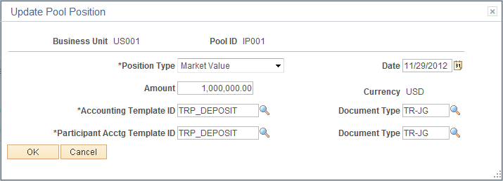

Use the Update Pool Position page (TRP_POOL_POS_ADD) to manually update the pool's cash position with current values obtained from outside investment sources.
This example illustrates the fields and controls on the Update Pool Position page. You can find definitions for the fields and controls later on this page.
Note: Obtaining the updated pool data may require running the Import Pool Position process.
Field or Control |
Description |
Position Type |
Select the type of position being updated. The options are:
Amount |
Enter the new market value of the investment pool. |
Accounting Template ID |
Select the accounting template for the pool that depicts the correct accounting and debit and credit configuration for this update transaction. |
Document Type |
Select the document type that the system uses to assign document sequence numbers. |
Participant Acctg Template ID |
Select the accounting template for the participants account that depicts the correct accounting and debit and credit configuration for this update transaction. |
